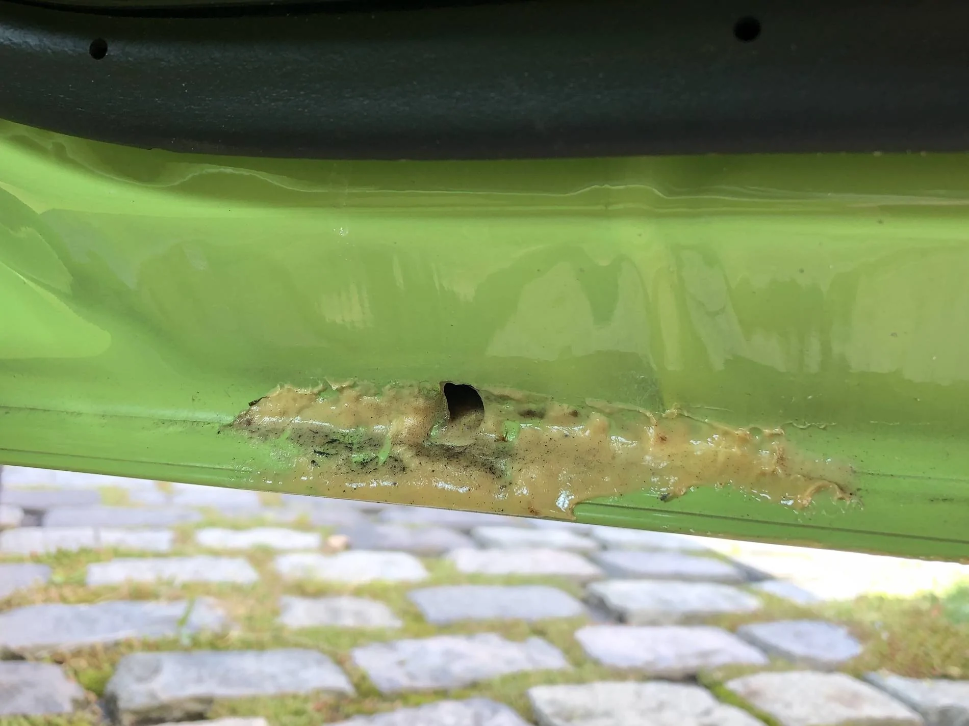

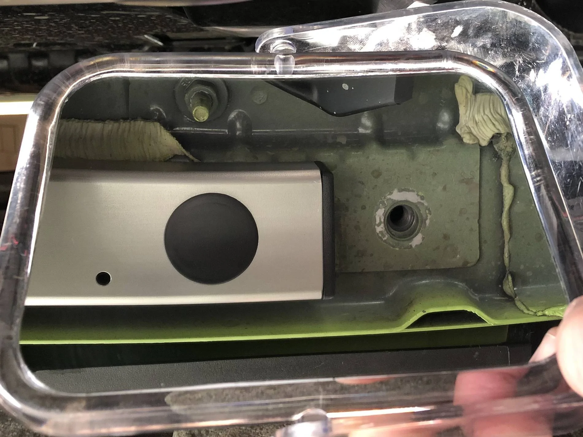

This is the cavity wax that they inject into the doors (as pictured) and the box sections under the car :
The white tape on the bottom of the doors covers the drains / holds it in place / stops it dripping during shipping :
WD :like:

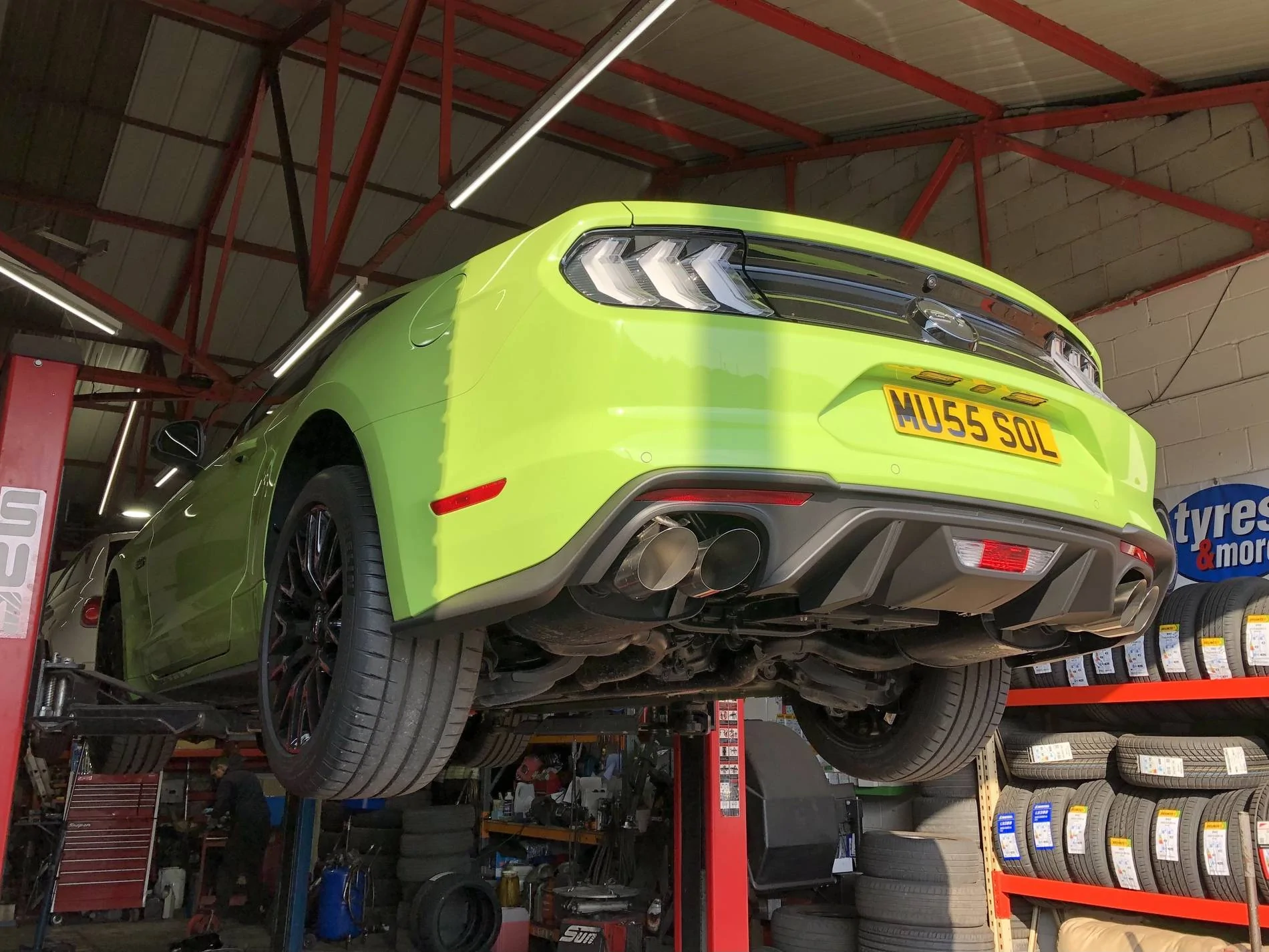

Not directly sorry. Other than overspray, the black crap is mostly aimed around the centre of the car spreading wider towards the back end. You can see it a little on here (diff / exhaust pipes / silencers - but none (other than overspray) on the rear suspension arms :
'In general' the front, sides and suspension are clear, you can see on this photo when I fitted my jacking rails there is nothing on the sills / pinch welds :
