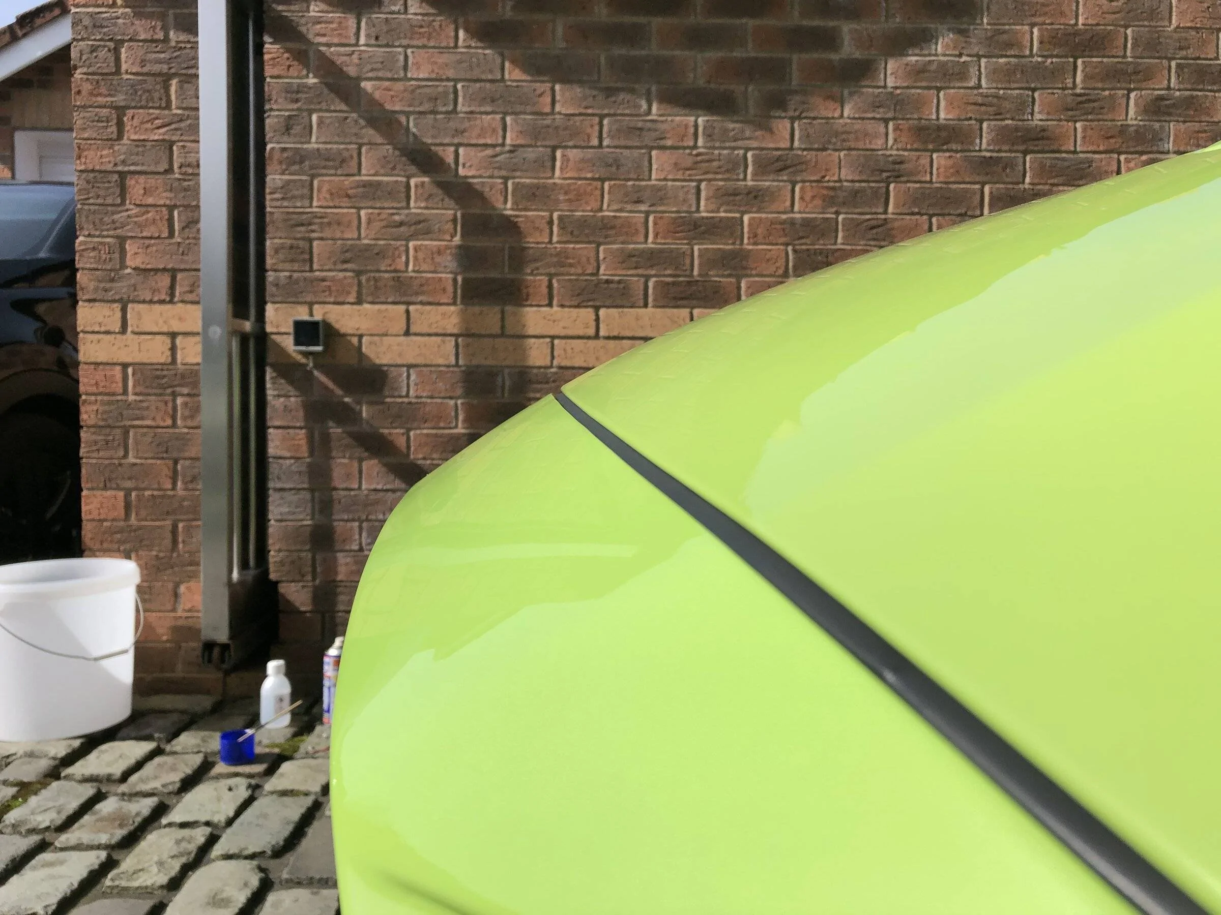

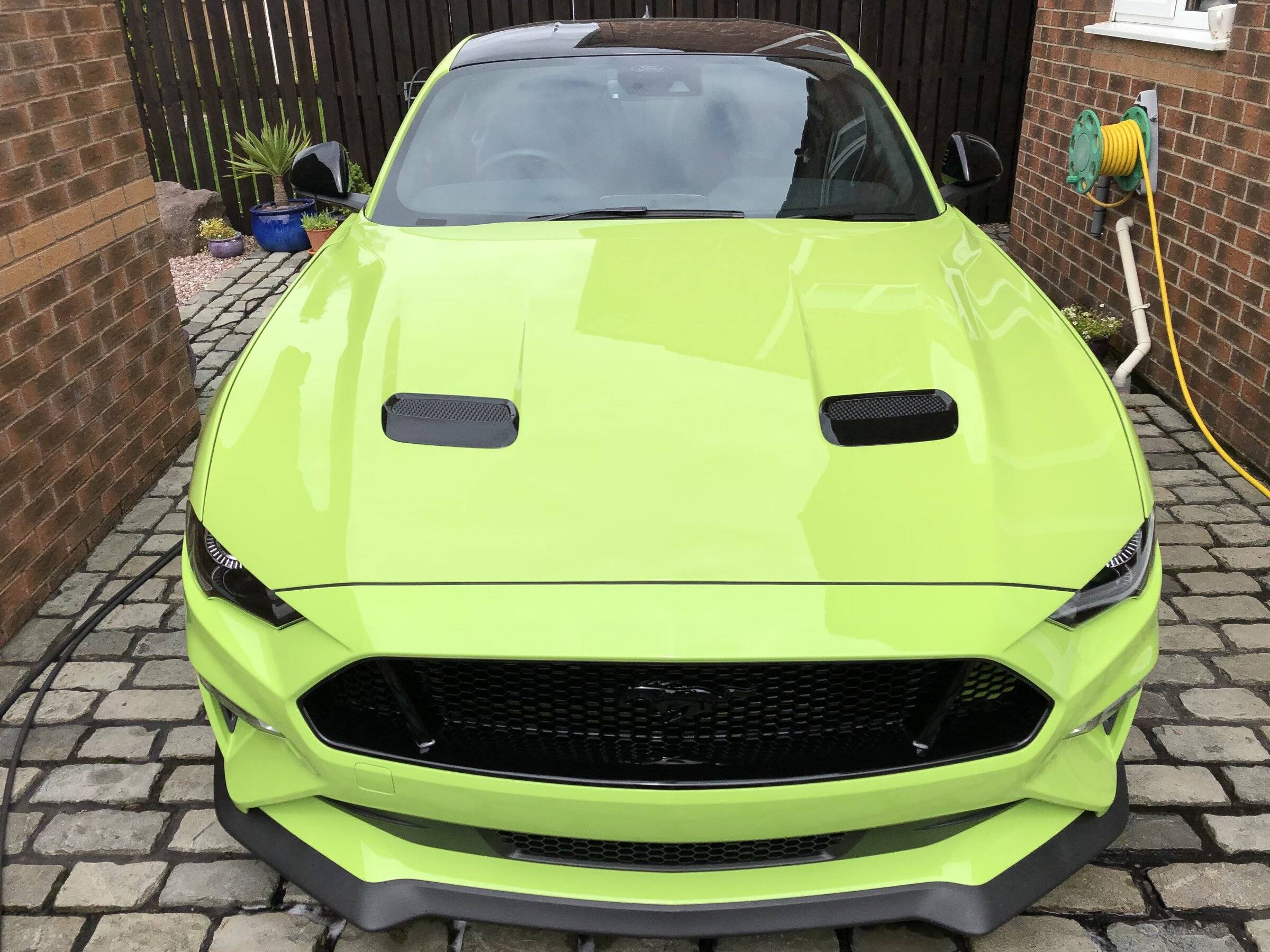

Gee, now that you guys mention the panel gaps, I did think the other day that my hood (bonnet) has an odd gap to the fenders, almost like it sits too low. I'll take a pic later today.
Mine was low.
Check the height of your bumper top to the front edge of the hood. I had to move my hood latch right up to the top of its adjustment to get the curvature to match :
It had the added advantage of making the front shutline much more even (not pinched in the middle) :
It’s an easy DIY fix if you need to do the same :like:
If you hood has sat low, also check that the throttle body elbow hasn’t rubbed / damaged the hood liner (although mine was exaggerated by other problems) - I appreciate that under hood area is a little different on a Mach :like:
