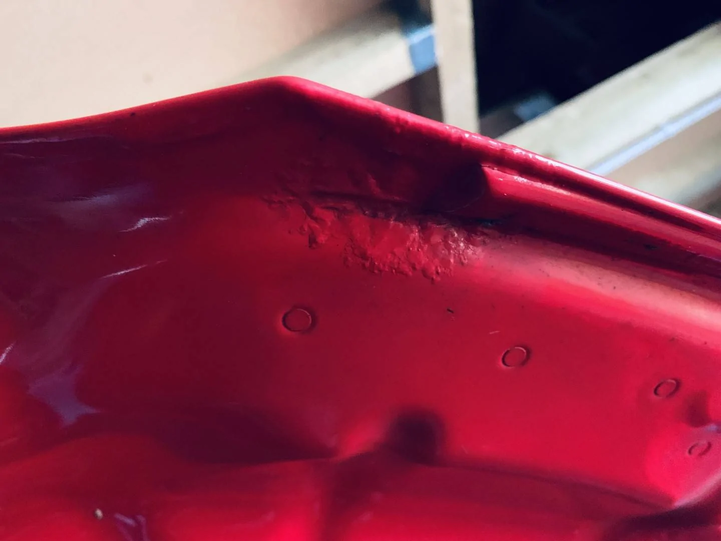

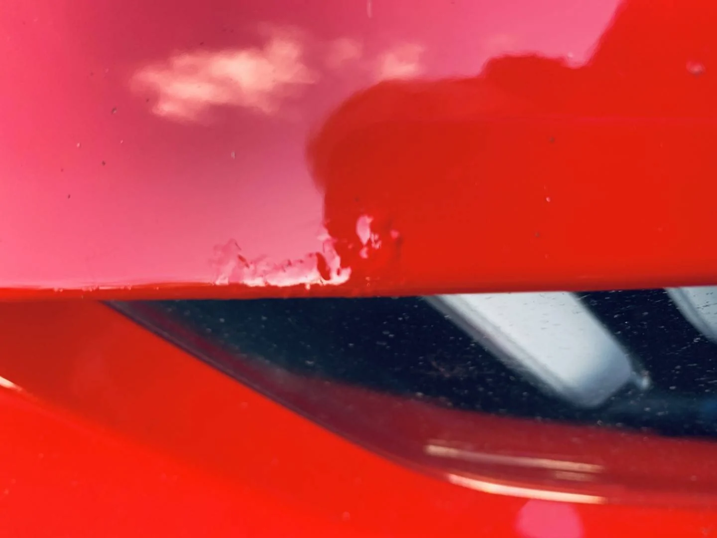

So my turn for a bubbling hood now, on the nearside top leading edge and underneath. Finally got hold of Ford UK Customer Services via Twitter, they have directed me to Dinnages in Haywards Heath (closest approved body shop to me), inspection on 6th January.
They (Dinnages) seem pretty clued up on the problem, fortunately I have a full set of body and paint check stamps.
