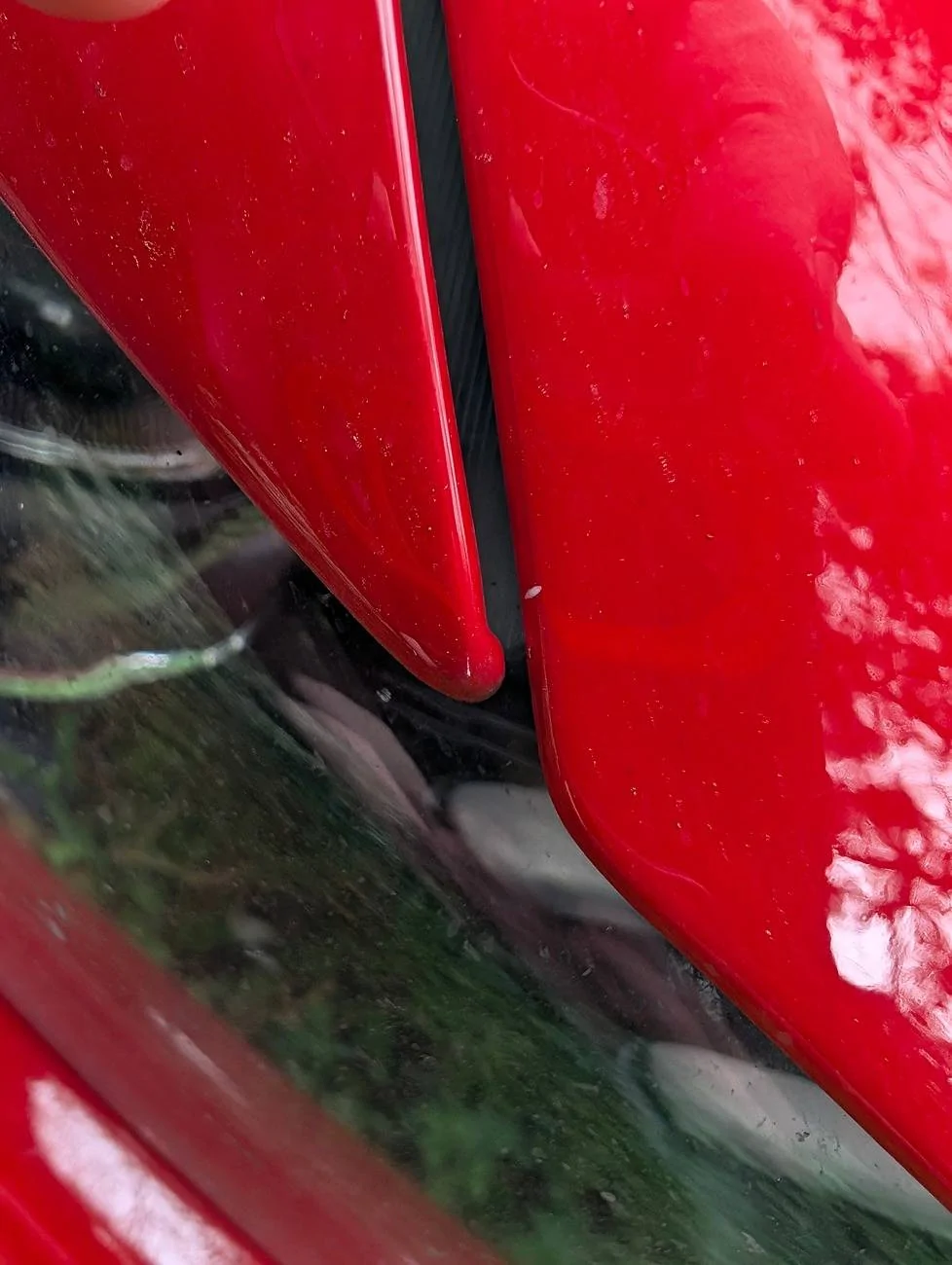

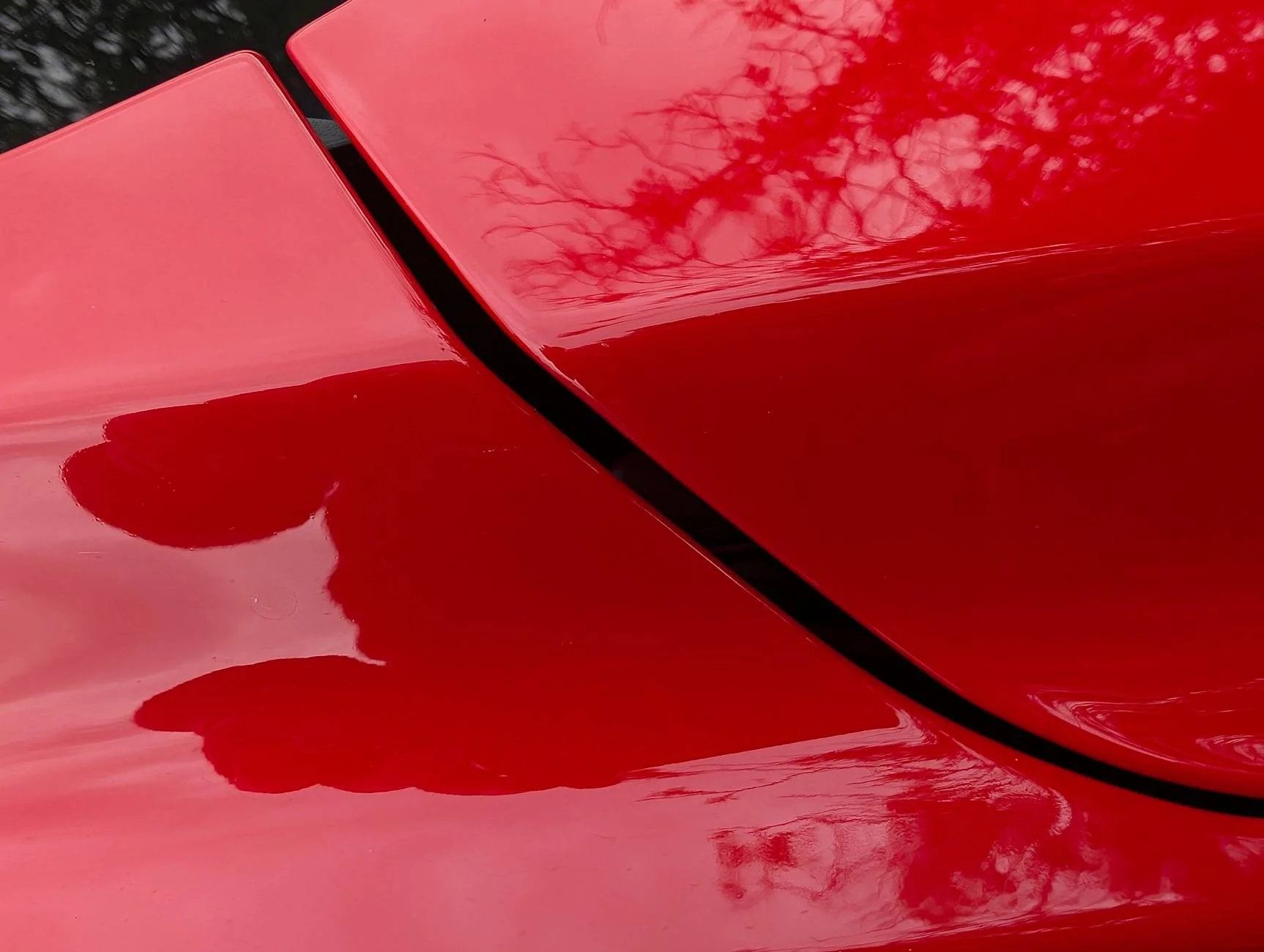

The bad news is the panels don't really seem to fit like they did before. The panel gaps are wrong in places and honestly the bonnet looks like it's a slightly different shape in places so the panel can never line up with the wing. Also one of the wings is a bit bent where it either came off the mould at the corner or it's been dropped so it's wonky. Honestly I'm not super happy but I didn't have the energy to argue about it. I'll try to attach some pics. You may say I'm being picky!

They look quite good to me. My worry is with the specific colour of the Bullitt, whether they match it to the rest of the car or it ends up different tone.
