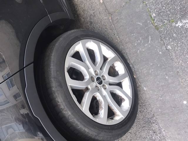

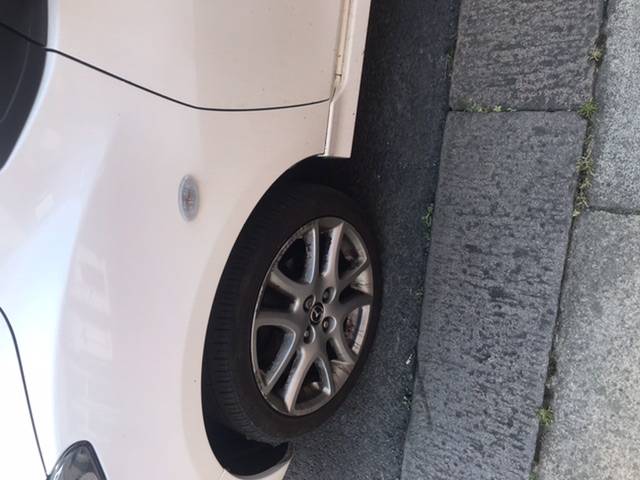

corrosion like this after such a short period is uncommon (and disgraceful) on relatively new cars in the EU/UK.
Yes and no. For sure you don’t see rotten cars driving around. As mentioned JLR have issues and I gather Mercedes 30 year corrosion warranty is worthless so read into that whatever you will. Whilst out and about today I didn’t see any newish cars with obvious body corrosion but alloys are a different story. Pics from a Toyota and an Evoque...
