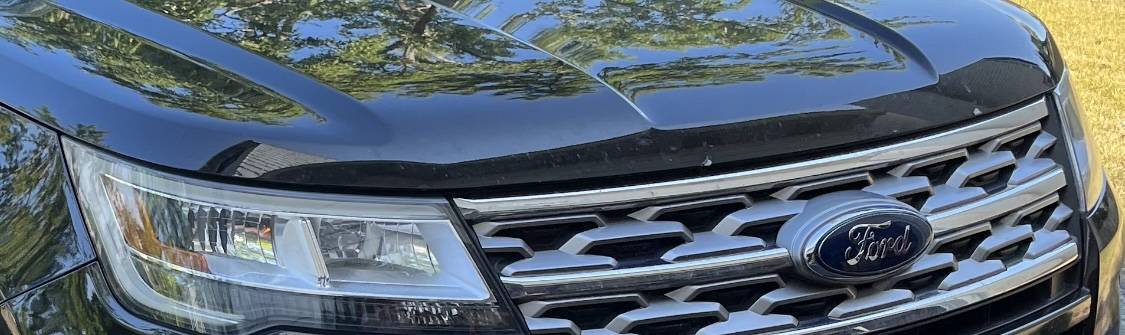

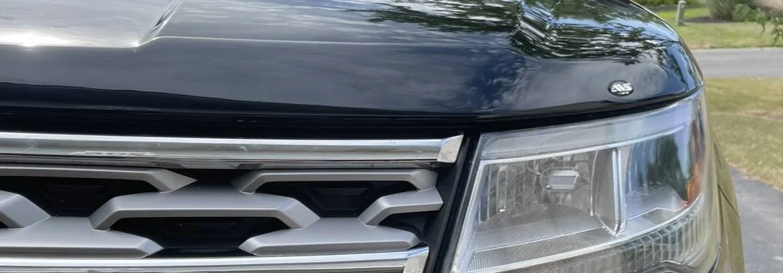

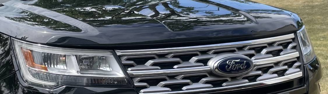

I believe the issue with hoods isn’t the fact that it is aluminum but that the construction is a LAMINATION, so a prepped and painted body panel may survive time while the laminated construction of the hood defies longevity.
If you have bubbling or chipped leading edge of a black vehicle get an AVS Aeroskin smoked protector, remove the brite name badge, it will look like the original hood again!
Top: chipped/bubbling
Bottom: Aeroskin protector installed
Center: close-up of name badge to remove (optionally)
