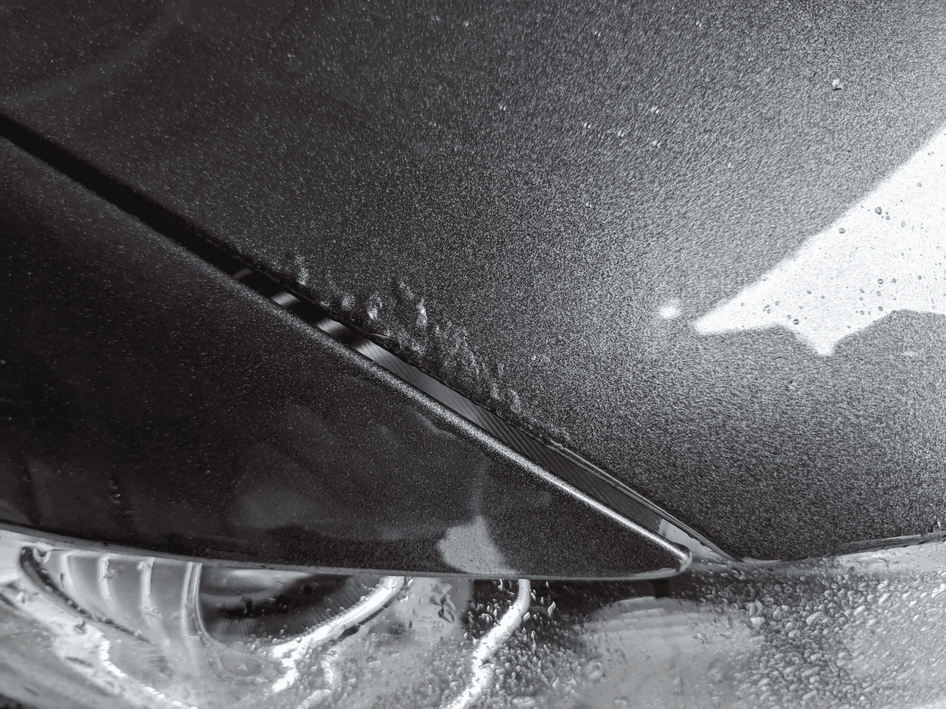

Yeah the hood corrosion was caused by poor prep work and contamination during the painting process. I guess it was somewhat common for 2015 but 2016 and 2017 model years were also impacted by it. I would assume that certain 2018+ model years are also affected but to a lesser degree. I have a 2016 and do NOT have any corrosion thankfully, but other owners are getting it.
The remedy for this while the warranty was still available was to replace the hood with a new hood, and have that repainted. Now the warranty is up for these years, so it is either do that same thing but pay for it out of pocket OR every 3-5 years have a body shop strip and repaint sections of the hood as the corrosion will continue to come back. No getting away from it.
I don't have this issue on my car, but honestly if I did I would just have a body shop fix it every few years and pay a lot less than an entire new hood. Mentally I would just write the cost off as a maintenance expense.
This is nothing new though. Ever since Ford switched to the aluminum hood back in 2005 for the retro styling mustang it has been an issue with bubbling and paint coming off.
Here is what the corrosion looks like from a car pic taken from the internet:
