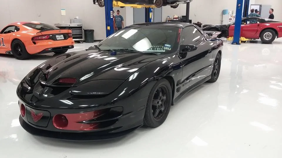

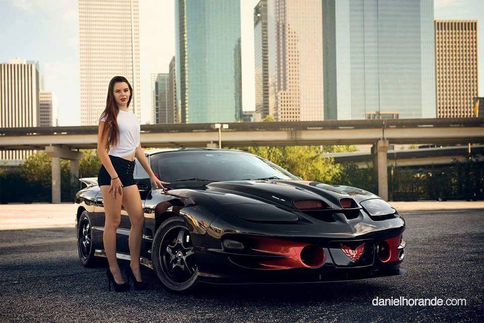

The WS6 is faster.
That said, I purpose built that car so I've got a ton of money in it. Long tubes, cams, gears, built motor, etc.
If I put the same money in the '19, it would be no contest. I also feel the WS6 is more visceral in speed. It's just violent and it's also much lighter than my 'Stang.
BUT...you can't daily drive it. I mean, I've done it but it isn't anywhere near as refined as my '19 obviously.
