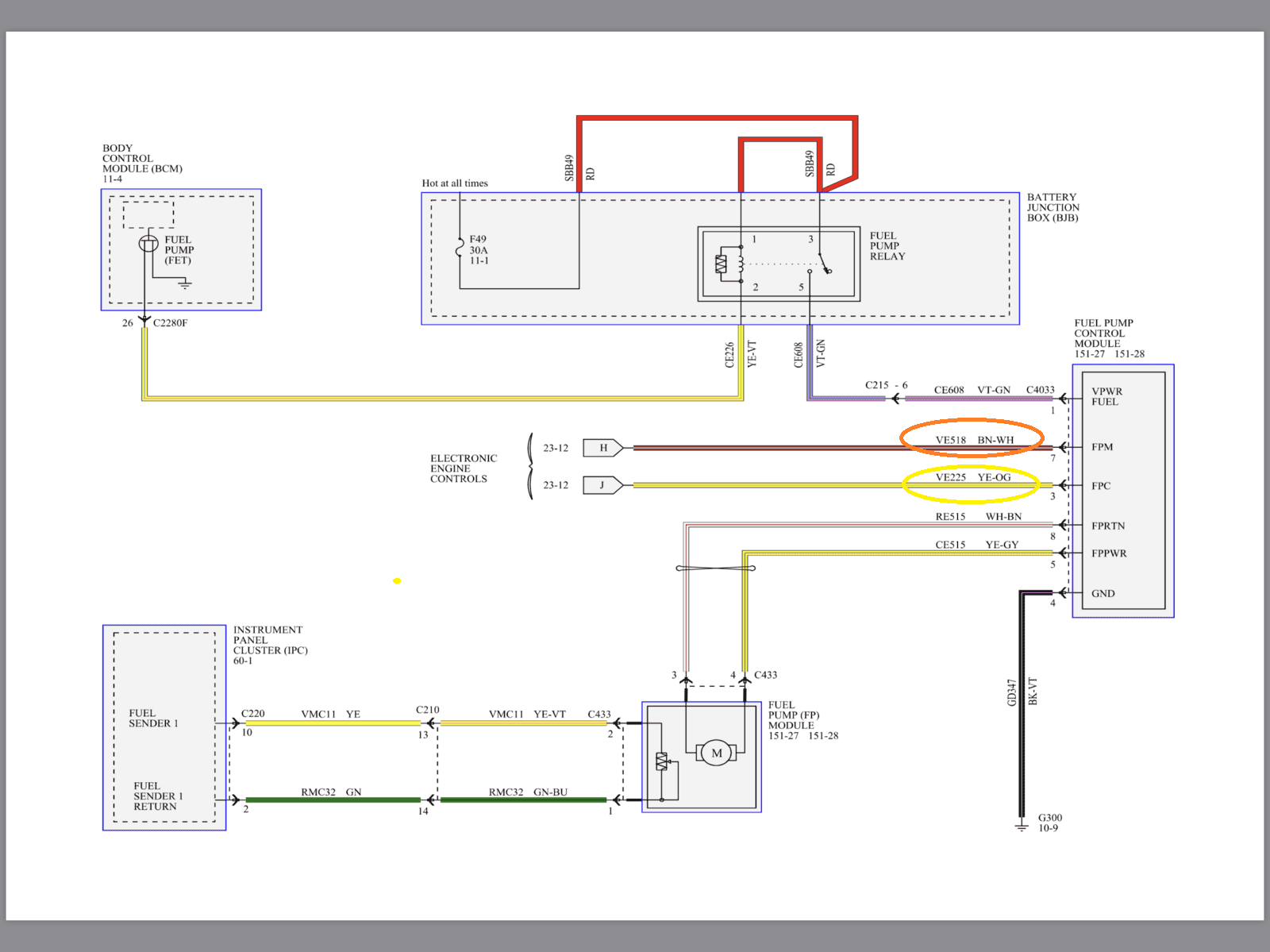

I am looking over the wiring for the Roush Stage 2 boost a pump, and I noticed there is no throttle or boost input for the ramp rate of the voltage. Does this mean it is simply on full all the time?

I don't know anything about the Roush BAP, but I just installed the VMP Plug and Play BAP. It has only the adapter the plugs in line with the FDMM Harness and a ground wire. It has no boost reference or throttle reference.
The instructions say that the tuner needs to adjust the flow rate flow rate at which the pump switches to high speed. It is supposed to be changed from .80 lb/min to 3 lb/min for supercharged cars.

I am pretty sure the Roush BAP is only on at WOT so there is no voltage ramp up. It's either on or off.

FYI I am staring at a Roush phase 2 tune and Full on Threshold is set to 0.80lb/min
Strange...
EDIT: what I do see changed Phase 1 versus Phase 2 is the Inferred Rail Pressure is basically flat lined in the phase 2, with little drop off until fuel flow hits nearly 7lb/min. That looks like the main change.
