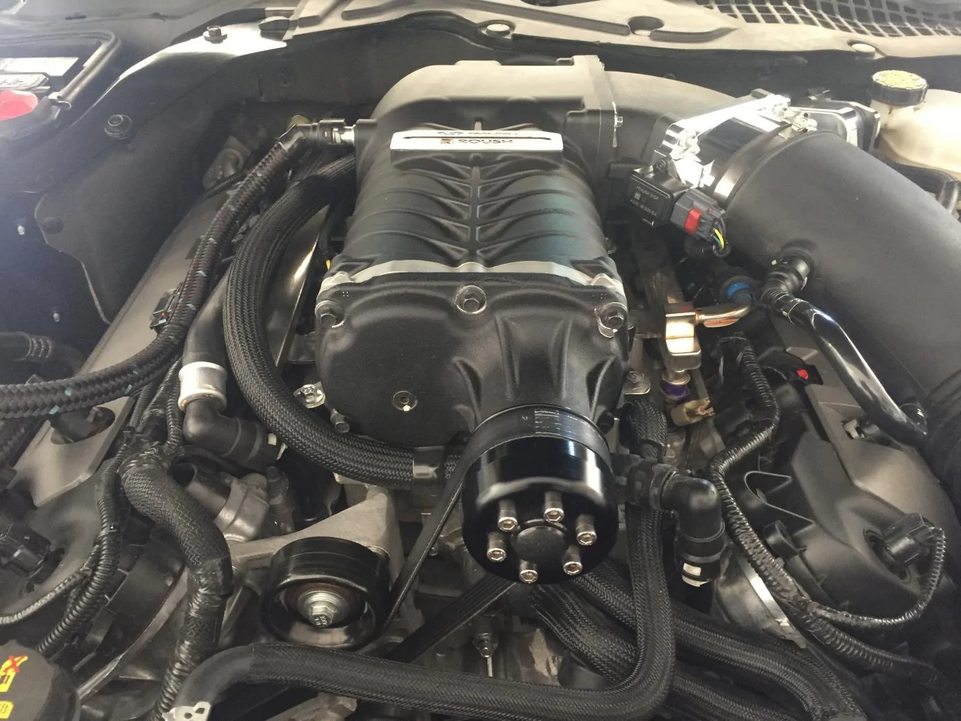

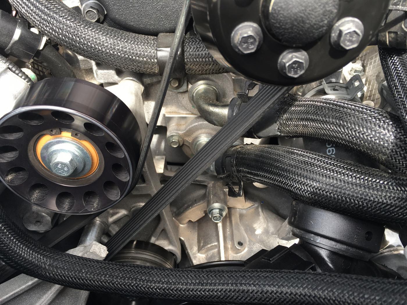

See Pics Below. It Looks Like My Supercharger Intercooler Is Hooked Up Backwards. Would This Tell The Car That It Is Hot And Pull Timing? The Car Jumps To Over 100 Right When You Start It On A 80 Deg Day Raining. And Never Gets Under 115 While Driving.

Yes there are backwards

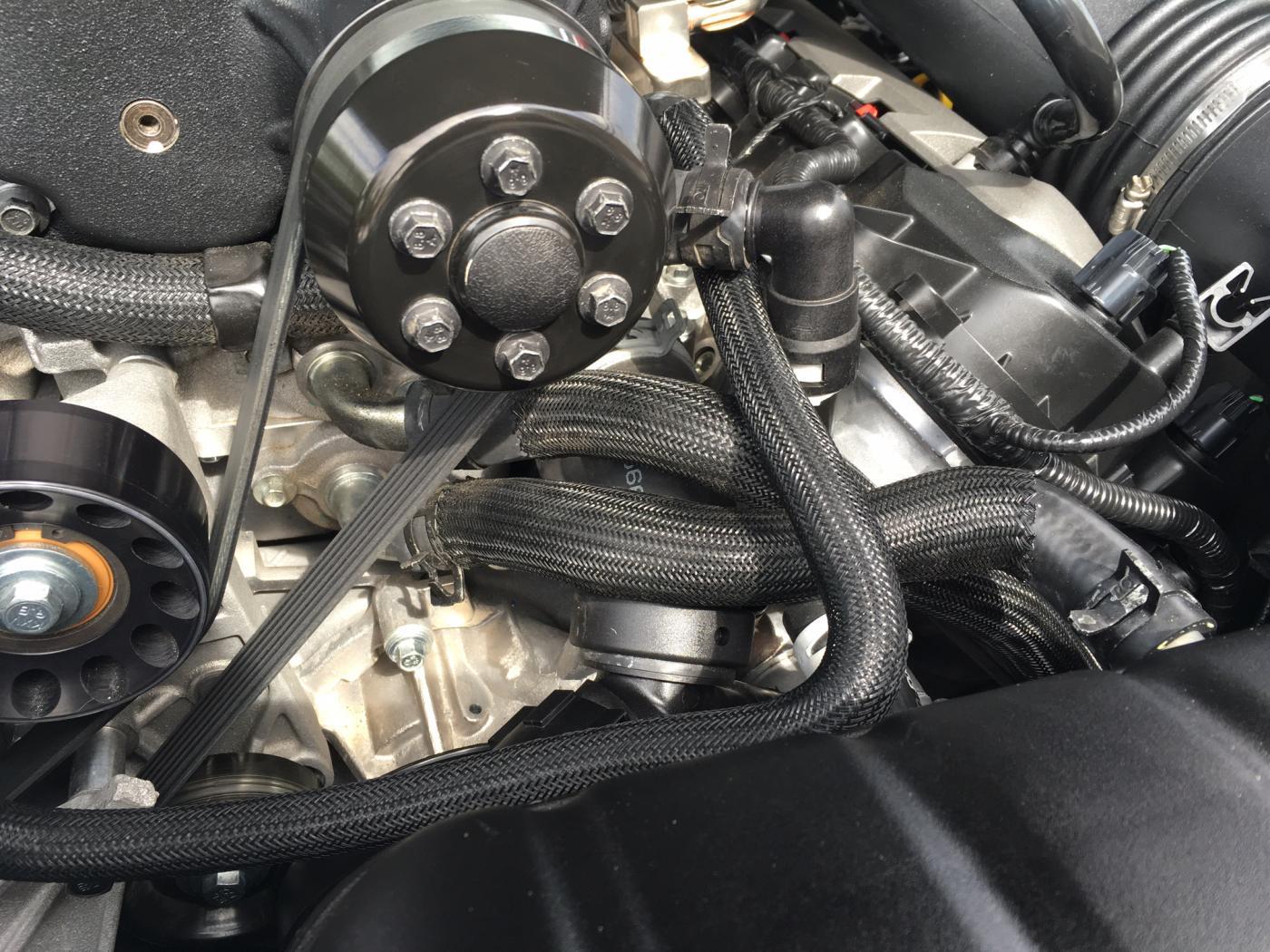

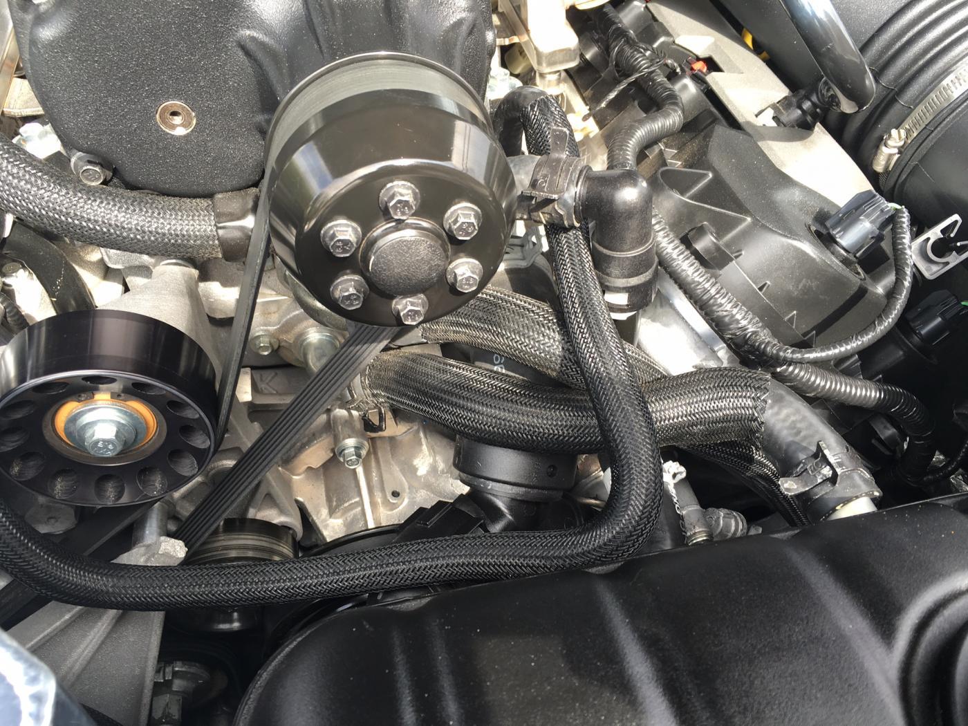

Thanks For The Pic Man!!! I Sure Hope This Is My Problem. I Let My Tuner Know So We Shall See What He Says.
Im Guessing Just Clamp Off The Lines And Switch Tem Real Fast And Then Clean Up The Mess? Sure Hope I Don't Have To Drain The Whole Thing?
Guy At For Dealer Must Have Been Drunk!

Just clamp them and remove. There's no real way to do them without making a mess yours still going to lose some coolant.
