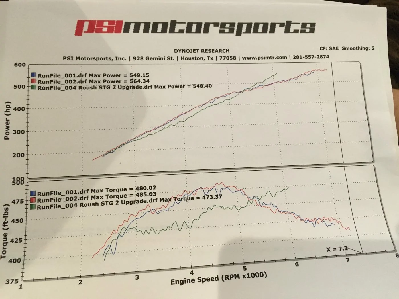

Still can't get the numbers I think I should have
New belt tensioner new long tubes and twin jet throttle body and still can't get over 600!

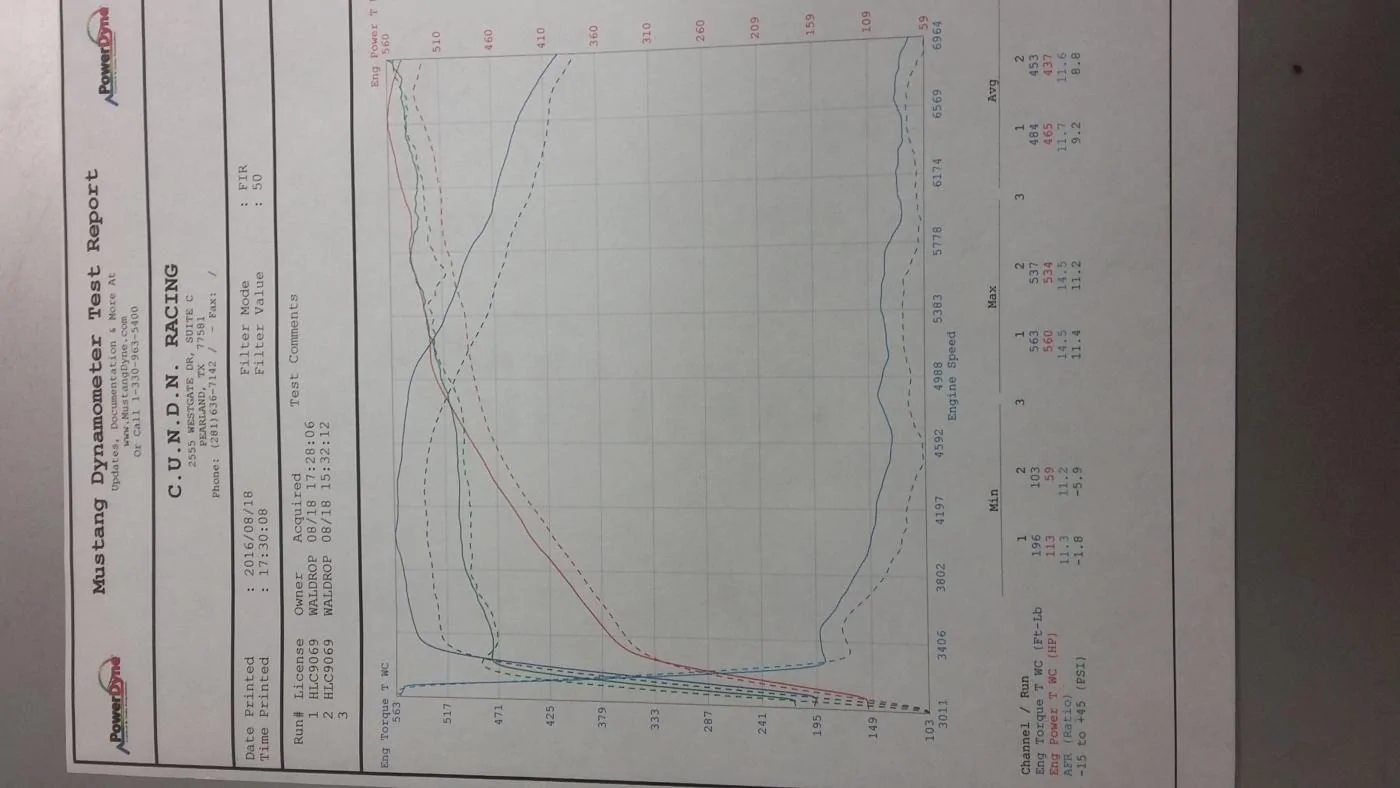

Going To Put It On Different Dyno Not A Mustang Dyno And See What It Makes.
The Torque Numbers From What I Have Seen Look Ok But The Hp Numbers Just Look Really Low.
Its Just Weird The Car Stopped Making Power At 6700 Rpms On This Dyno And Still Was Going Straight Up On The Hp At After 7K On The Last Dyno Before Headers And Throttle Body.
