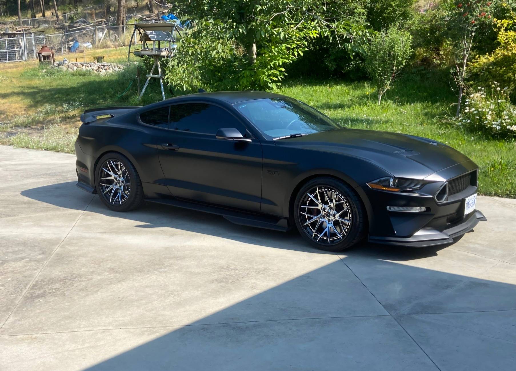

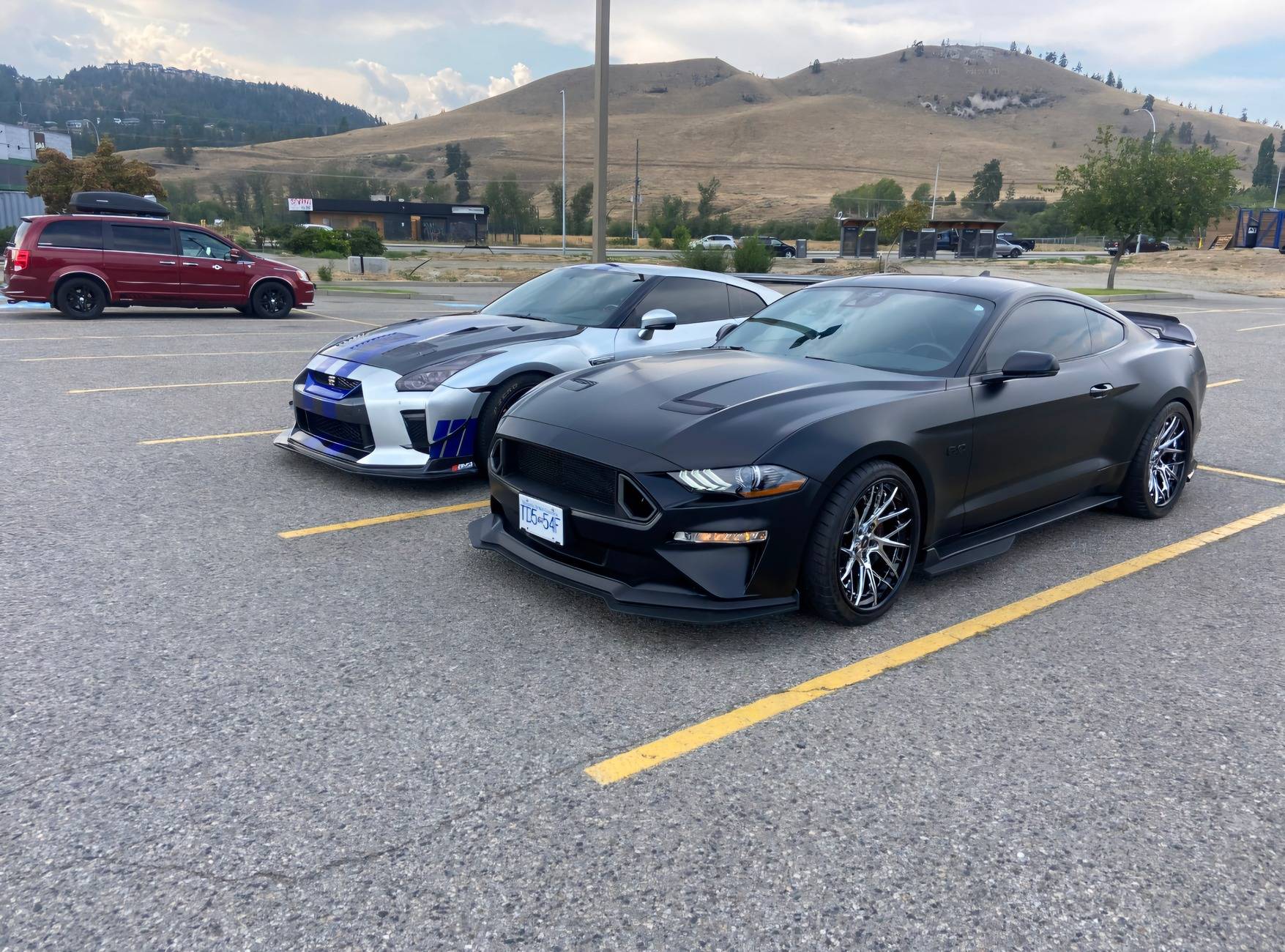

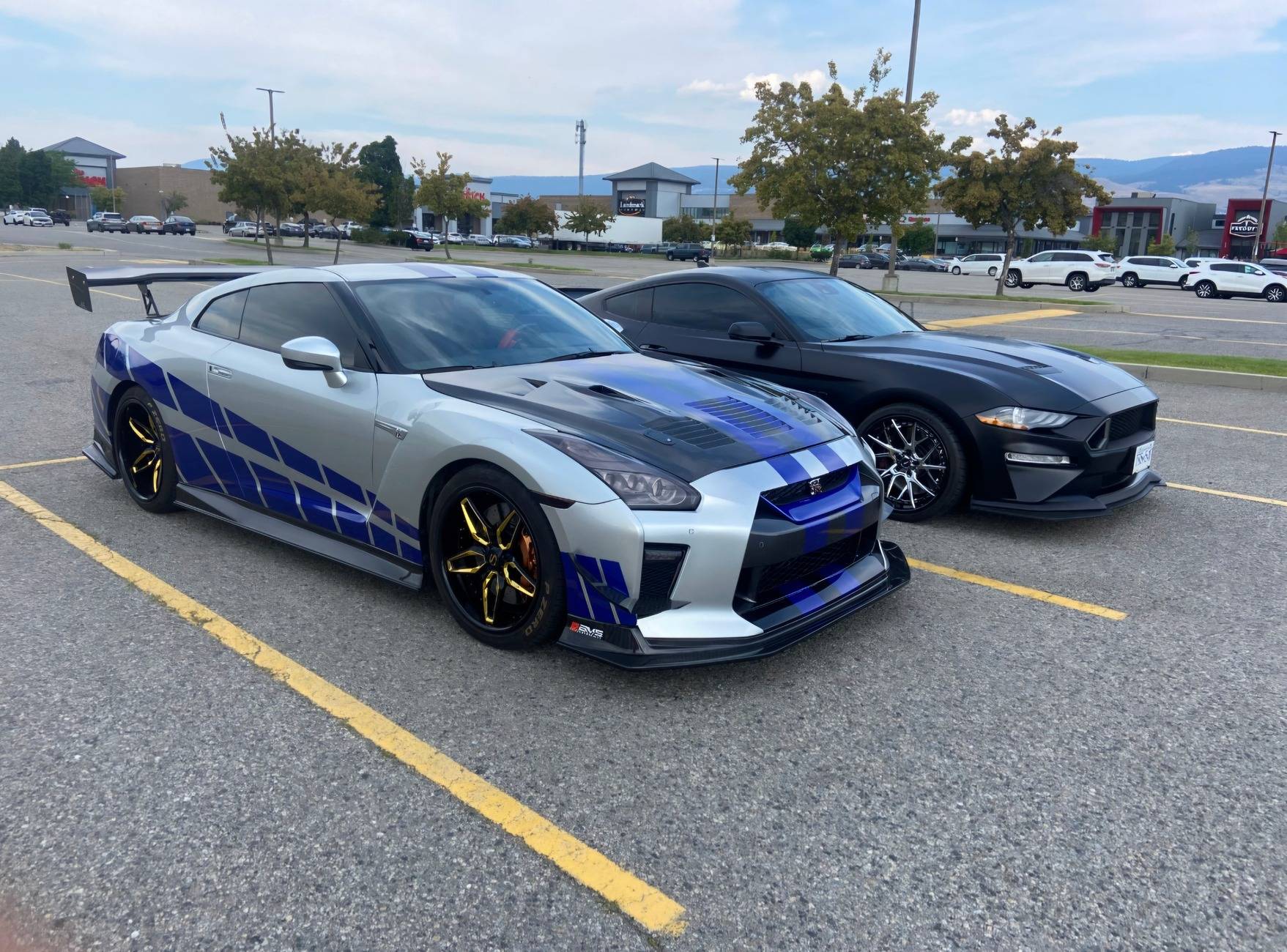

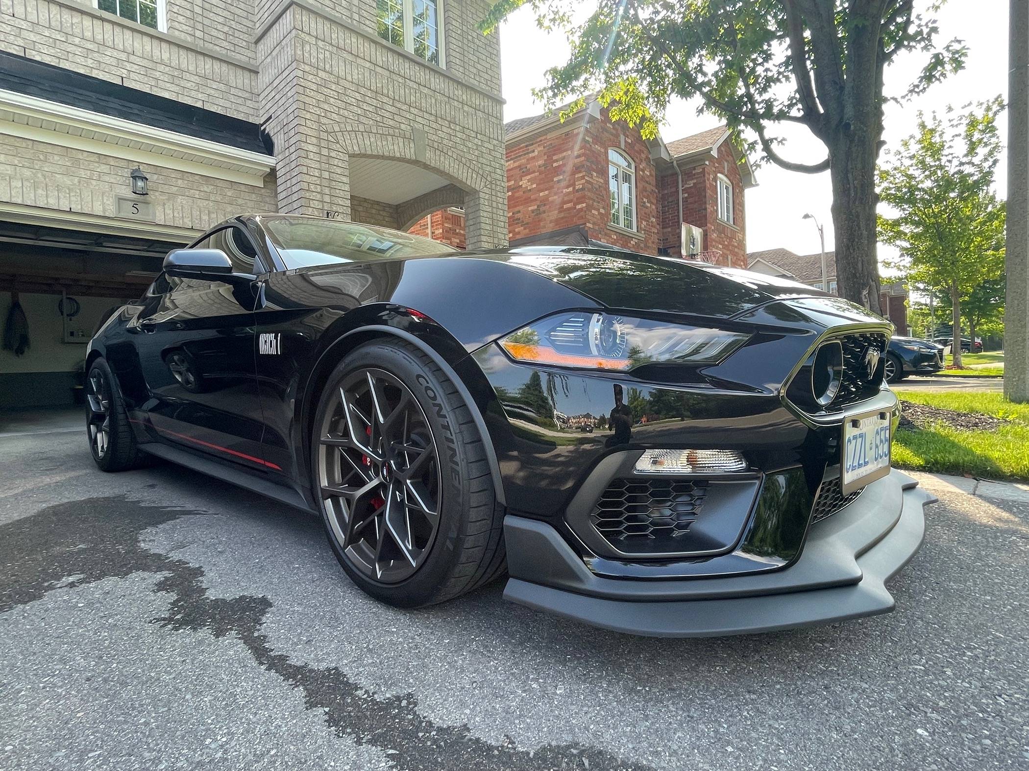

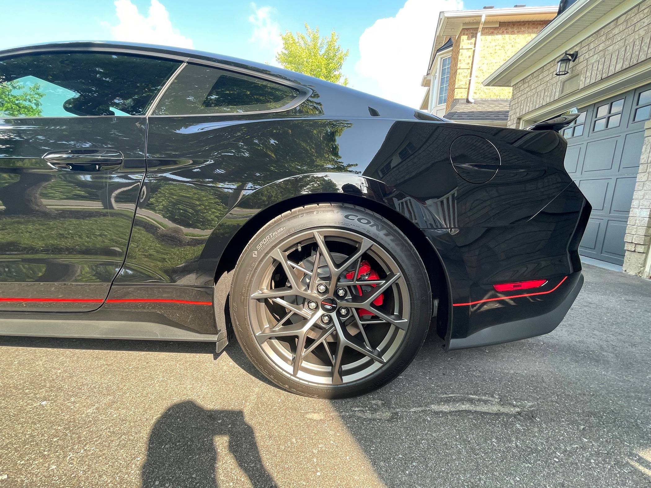

I like the roush lowering springs. We do a looks great and handles well as we do lots of windy back road driving. And as you can see beside my brothers gtr it's still has more clearance than his gtr even though his gtr isn't lowered. In terms of calibration, we live in Canada and just got it done at our ford dealership. I think you can also do it at roush authorized dealers but I think ford is the easiest way. But handling really improved when we upgraded the wheels and tires. I can take a pic for clearance when we pick up the cars from storage in the next couple weeks
Jul 27, 2024
Canada
2023 Mustang gt
But of course handling is probably great on your guy's cars since you guys have mach 1's. We have a 23 gt performance so it came with not very wide tires
