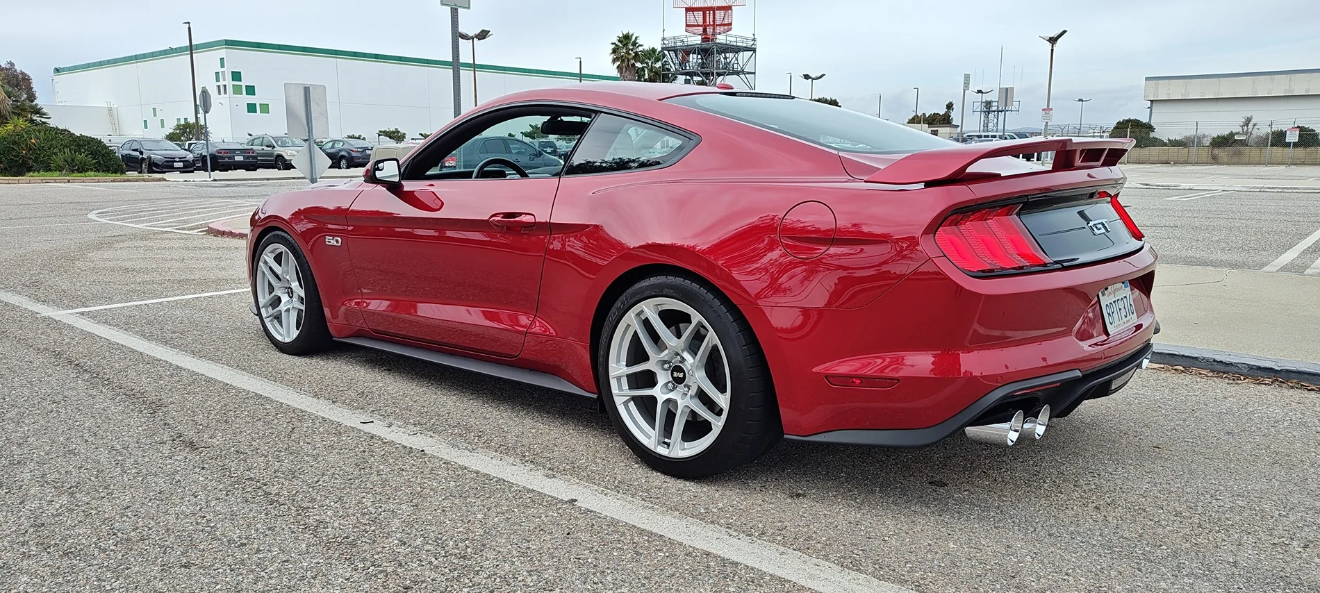

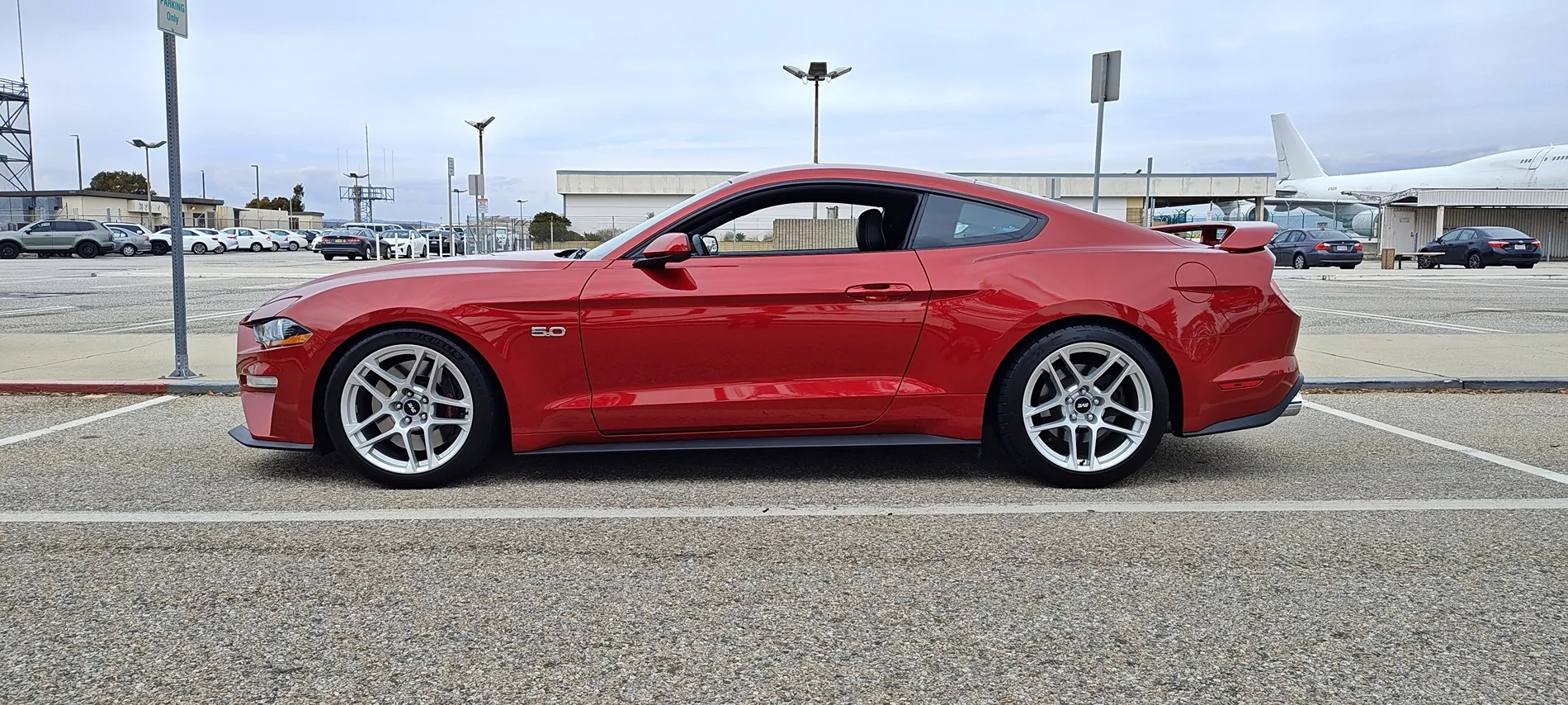

Also, the car had a 305/35/19 tire vs the OEM 275/40/19 tire, which is .3" in diameter less.
Here are some more photos.
