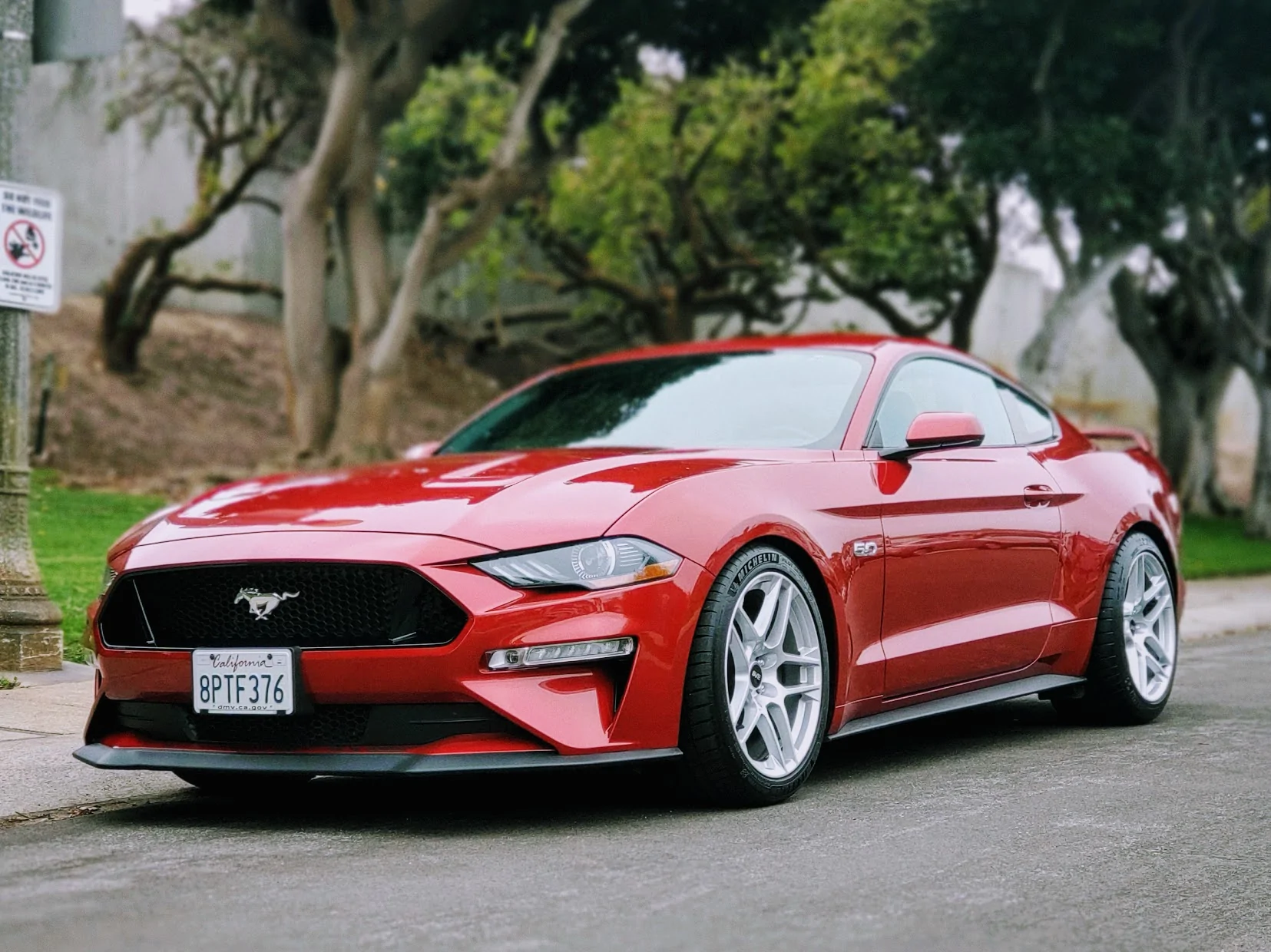

My car had the Ford Performane Track Kit, I feel the car should have came like this from the factory.

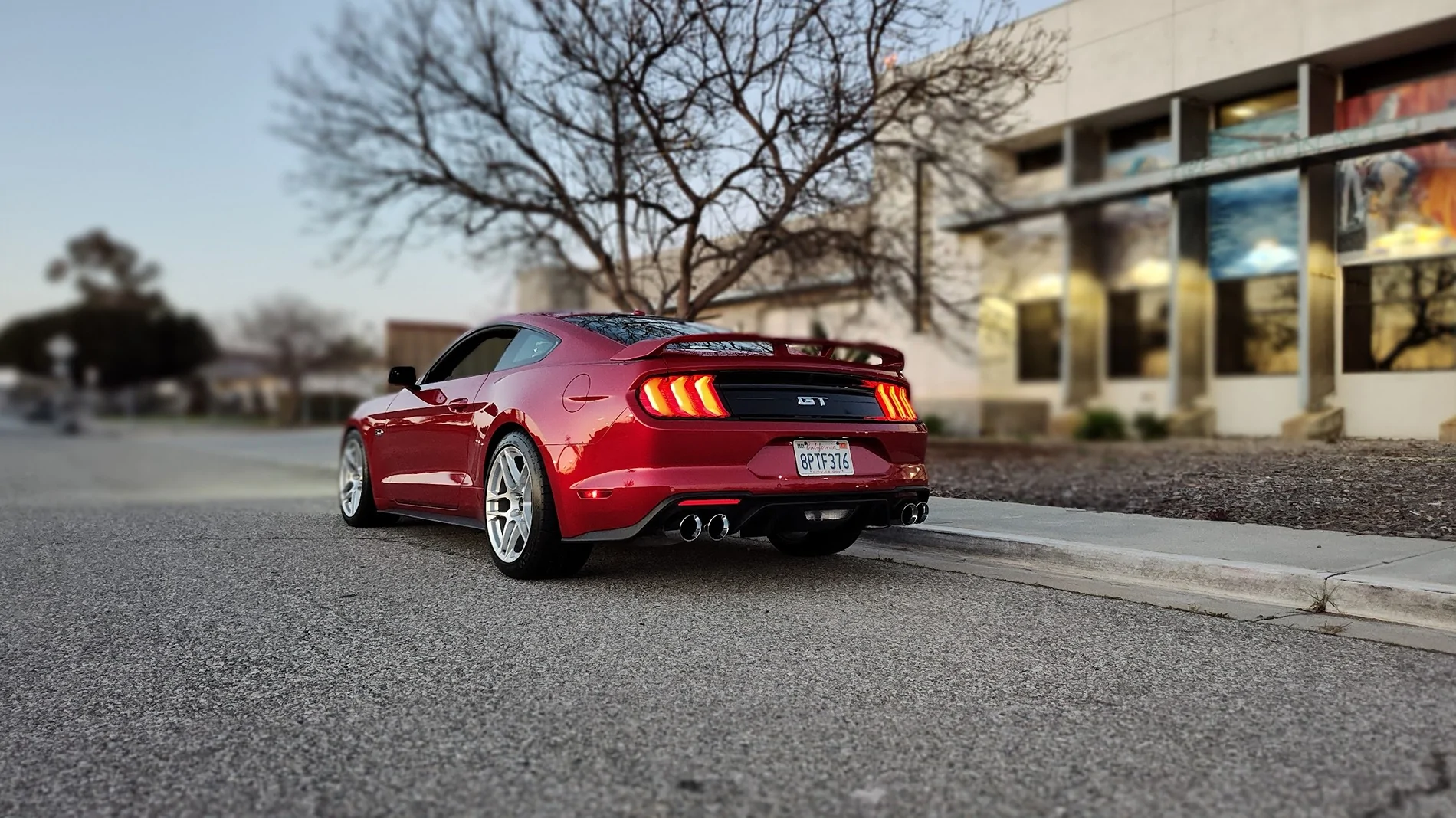

I love the stance of those springs in the front, But why is the back so high? It looks like the track springs are higher in the back than stock springs. Did you have the bushings clocked?

Looks awesome! What wheel setup do you have going? Notice any excessive tire wear? That’s what I’ve been told by a local shop to expect with that kit especially for daily driving.

Bushings were clocked. The Trackkit only lowered my rear by .625", the front .875". I loved the stance. I have since sold this car and now have a G87 M2

Those were the LMR X500 19x10 and 19x11 with 285/305 Mich PSS. There wasn't any excessive tire wear. The car drove so much better than stock which was rubbish even with the Performance Pack
they do ride a bit higher in the rear. im guessing for a bit of extra suspension travel to keep the ride decent, but just a guess.
