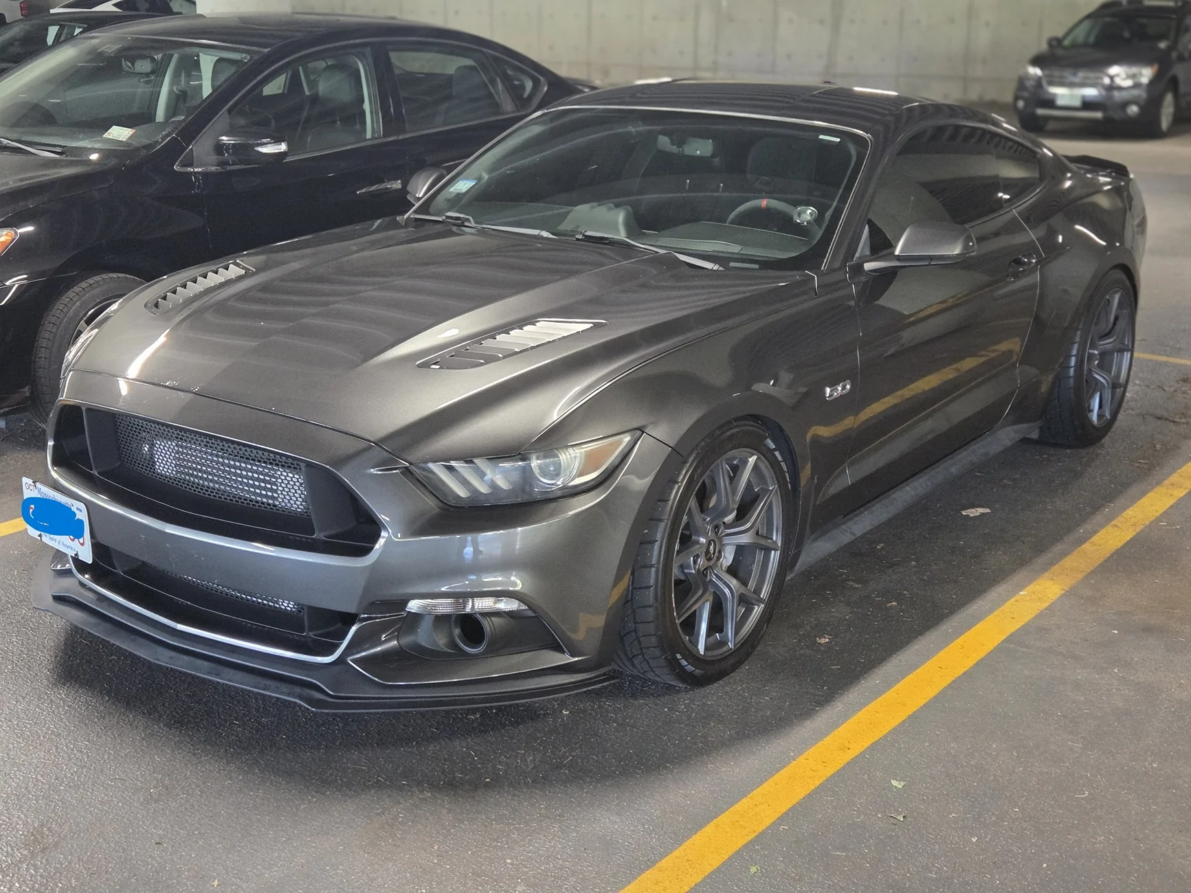

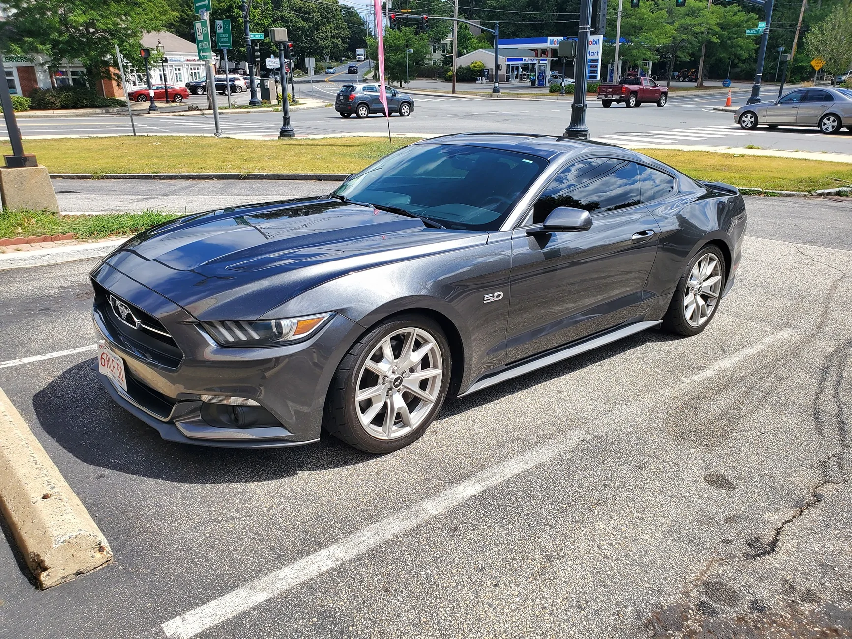

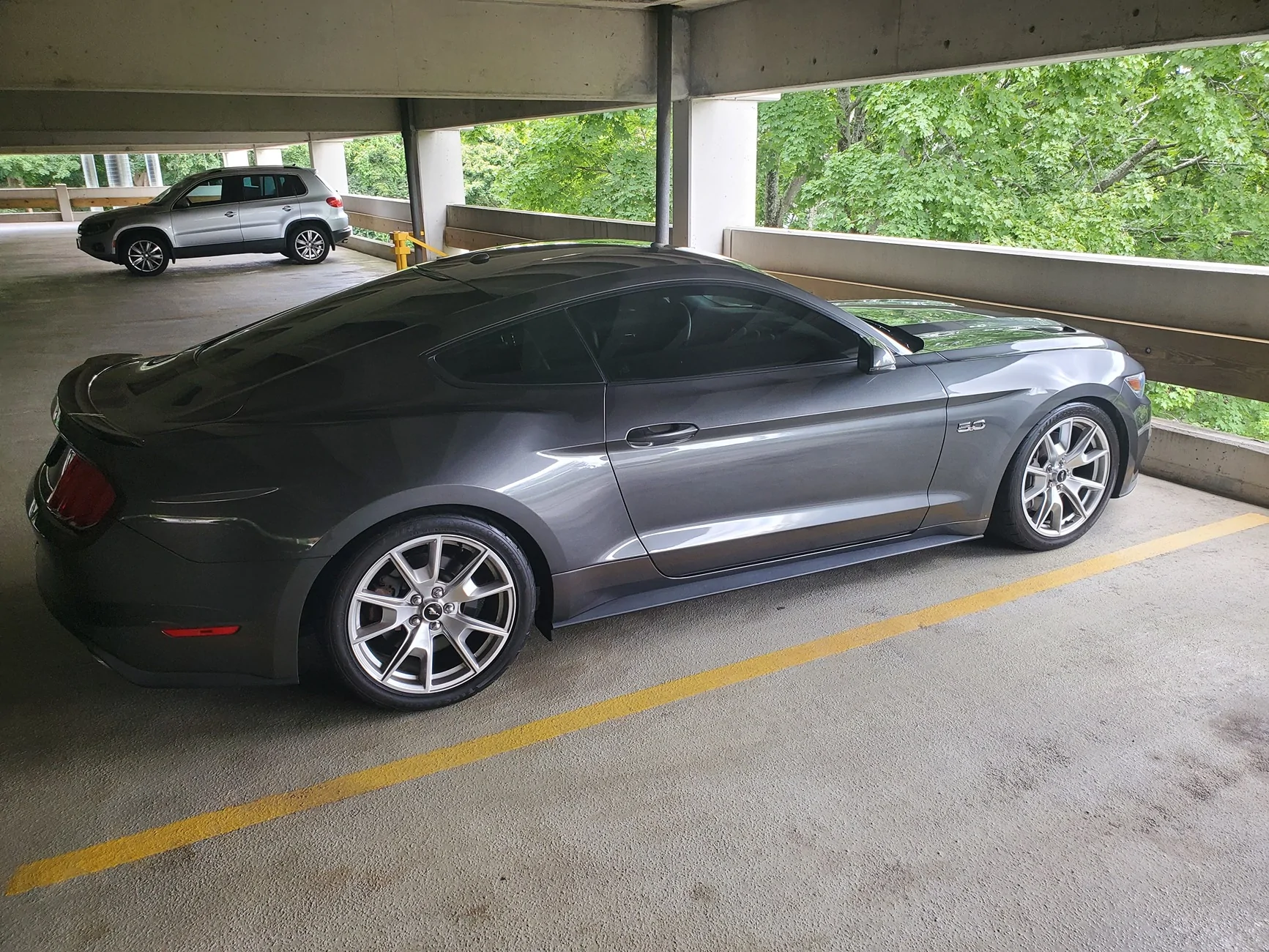

These are a couple pics from my old setup (BMR SP0080 springs, Stock struts, Stock 50th wheels) and current setup (steeda ultralite linear/FP Track Struts) not a great picture but the only one I have. There is basically no wheel gap in the front and maybe a finger in the back.
I went to the new setup because I wanted less wheel gap in the back and an overall more aggressive handling car. I don't drive it much so I don't mind a rough ride in tradeoff for performance.

I drove mine with the BMR/stock struts for at least a year (on horrible MASS roads) and when I took them off they looked/felt fine. I think as long as you don't do something with an extreme drop or hit every pothole you should be fine for a good while.
I like the look of a lighter colored wheel. It gives the car some pop. I bought these SP2 reps off a guy on this forum and he said they were powder coated anthracite. Not as bright as the silver but imo they still look good.
