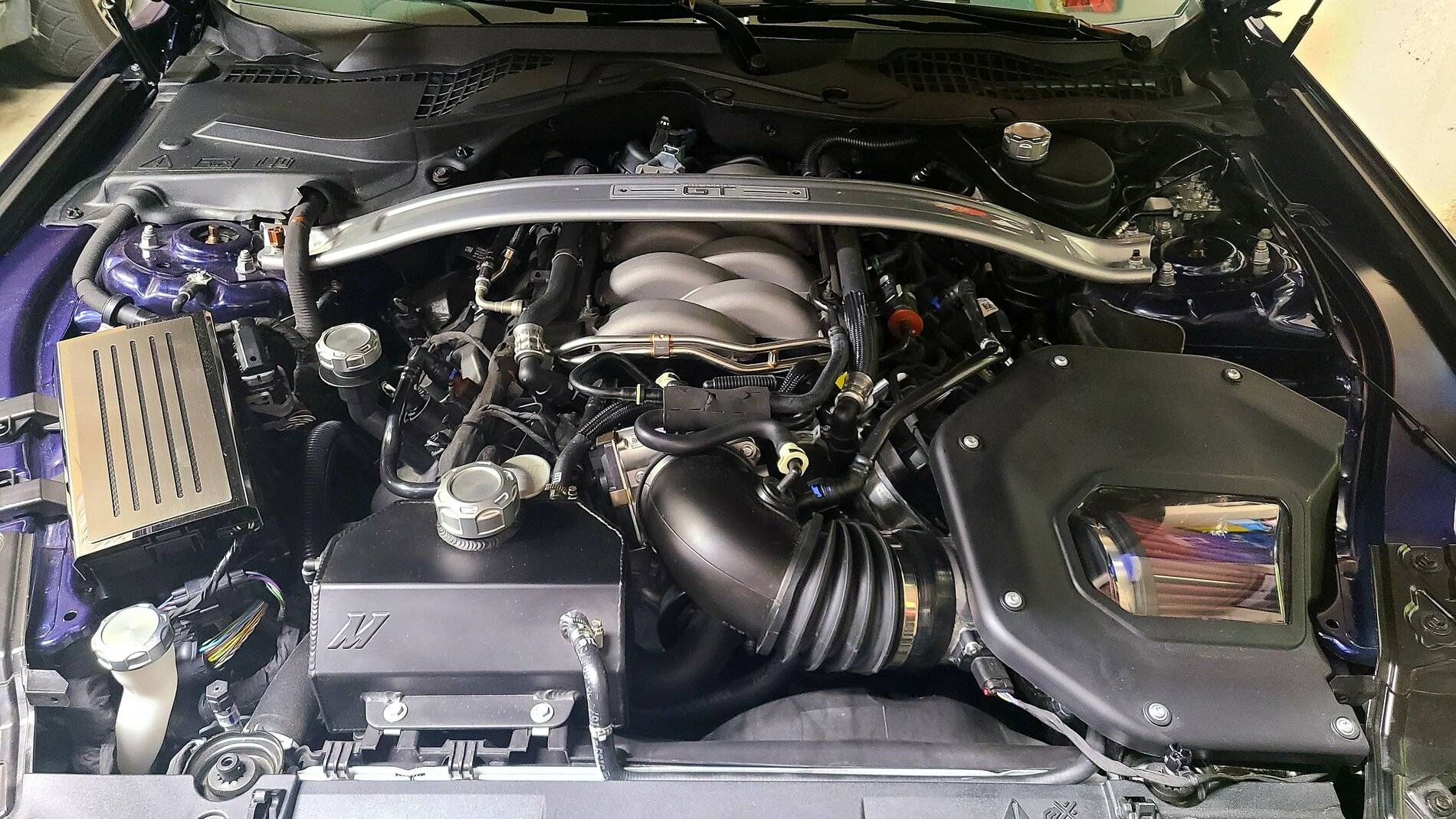

I installed the Roush a year ago and have been happy with it. I removed the inner tube and did an E85 tune with Lund at the same time (I later changed the tube and throttle body, see asterisk note below). I know the E85 added power because this has been proven a million times but it's impossible to say if the Roush is giving me any extra power because I didnt dyno the car before and after. However I will say this, the Inlet Air Temps have been impressive with the Roush, which I attribute to the closed box design. As long as I'm driving say at least 20 mph the IAT's are usually only about 4 or 5 degrees over the ambient temp, which to me is pretty dang good. I seriously doubt many (if any) open air box designs can say the same. Obviously the cooler the air, the more power the car will make. That's the whole point of a 'Cold Air Intake' right? As a bonus the Roush design make a very nice presentation for your engine bay, see attached photo (*Note, after the initial install I added a GT350 87mm throttle body and inlet tube thinking it would provide more power **2nd note, don't attempt that part, stick with the original Roush tube and stock throttle body because I learned later on from my tuner that the larger throttle body likely isn't adding much)
