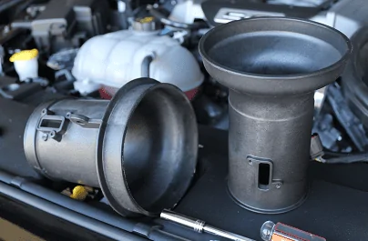

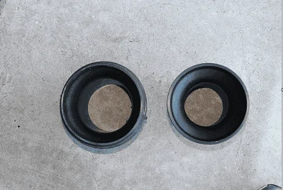

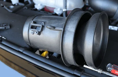

*UPDATE*
To prepare for my LT headers and nGauge that I recently purchased from Beefcake, I removed the insert out of my Roush intake today. I will have to do some datalogging for this setup per Lund. Removing the insert is easy. Take the MAF sensor out along with the (2) size 15 torx screws, then slide the insert out. Put the screws back in so you don't create a leak of un-measured air into the intake.
