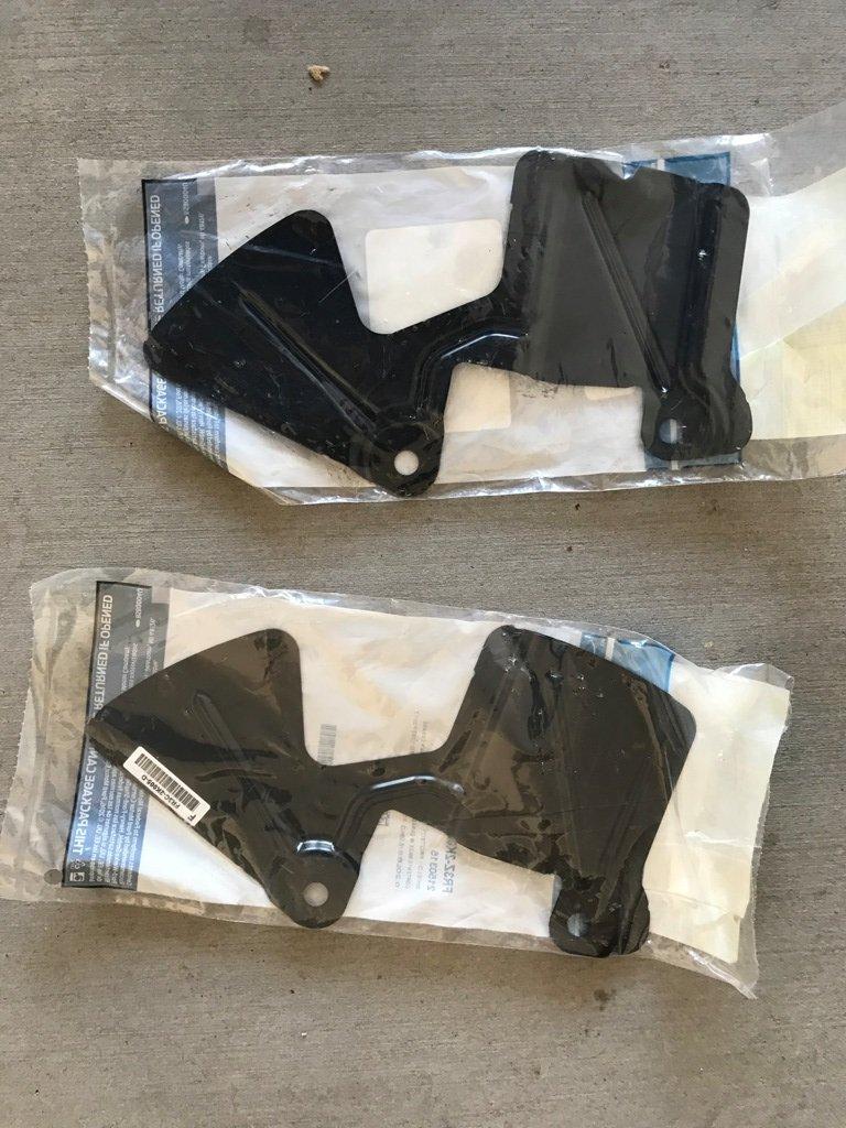

For everyone's reference, these are GTPP backplates that arrived today, which are just enough to cover the ball joints and allow air reach backside. They took about two weeks to arrive and I couldn't wait as I need to season the new rotors before I can brake hard to fully test the used GTPP calipers before their 30-day return window closes. So I just cut the existing backplates into a similar shape. I'm just going to throw them in with the old rotors when I'm ready to sell them (after the calipers are tested to be good).

How much were the backing plates?
You have a link to where you picked up those rotors from?
Eventually when I upgrade my rotors I'd like to go this route, since the upgraded PP links with the air deflectors are useless without the open back / rear cooling rotors.

Part numbers are FR3Z-2K004-H and FR3Z-2K005-H. I got them at https://www.tascaparts.com for $3.33 each with $9.18 shipping, which came out to $15.84. Shipping seemed high relative to the unit cost but they ended up being cheaper overall compared to other places with free shipping.

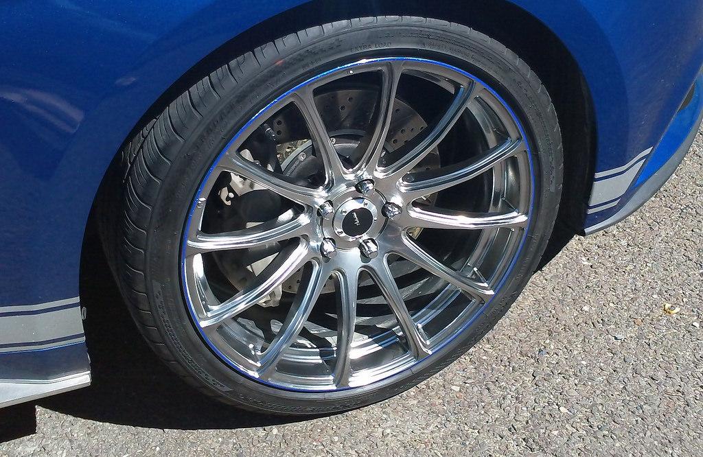

I seen Raxiom makes a halo LED fog light for the 2015-2017 cars which is hollow in the middle. I was thinking about buying a cooling kit and using the Raxiom lights as an air inlet, apparently it works, I seen someone posted before about using a JLT brake cooling kit with them. Seems to be a good option for people who want a brake cooling option while keeping fog lights. They actually look really nice too, though not as bright as the factory ones.
Blue Moon
Dec 23, 2017
1,347
1,383
Maine, or eastern Canada
Pete
17 Ecoboost Perform Pack Std
I bought a set of those halo fog lights. Just waiting for warm weather to put them in.
2015Etrac
Aug 2, 2016
128
1,600
369
PA
Black 2016 Mustang GT Premium 401a
They do look good. If I decide my brakes need more cooling I plan to buy the Raxiom lights with the JLT cooling kit.
