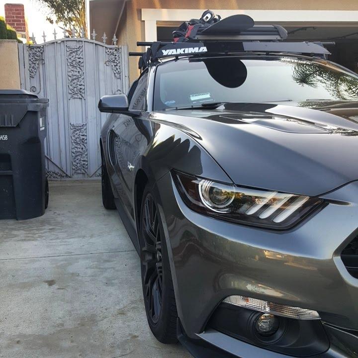

That being said, here is my opinion about the Yakima kit, which is the only one that ever existed from the two major manufacturers. It has been discontinued, but maybe some people find this helpful. ***There has never been such a kit from Yakima or Thule for 2018+ Mustangs.***
A BRIEF REVIEW of Yakima Q-Towers System with Q78 clips - on a 2015-2017 Mustang
Yakima *made* (past tense) a set of clips for their standard Q-Towers rack system, but you can no longer buy them.
The Yakima clips for Mustang 2015-2017 are Q78 if you can find a NOS set, but they have been discontinued. I think they were discontinued for design issues, although they have not failed me so far, nor do I anticipate that they will.
Yakima's was a poor design, though it was the arguably the best they could do branching from their standard roof rack systems. The Mustang - like my previous cars, has no metal edges on the doorsills, nor any rear doorsills at all by which to clamp the rack, so they use the rubber surrounds.
See attached photos or you can also see in the YouTube video posted in this thread. Some will cringe at the clamping positions, but this is the reality of owning a Mustang as your only car and having big sports gear to lug around.
FRONT CLIPS - Not so bad.
The front clips hook under the edges of the front rubber window trim. This works fine because it has an actual lip that fits handily into the hook side of the clip.
This is common practice for cars without metal windowsills. The tension is only enough to secure the rack and causes only minimal temporary distortion to the rubber sills. They will absolutely go right back to shape if they get slightly squished during use.
REAR - Not great.
My real issue with the Yakima design is the rear clips. The rear clips "hook" (air quotes intended here) onto the underside of the rear porthole window's rubber surround. That rubber surround has a FLAT SURFACE on the underside.
Although you are not likely to hurt the rubber and it will also return to form, you have to squeeze it much harder than the front to pass the standard security check that Yakima recommends when installing their temporary rack systems. That is, to give a strong tug outward from the car to make sure the rack is properly secured and will not shimmy loose while driving.
I have used the Yakima system since buying my 2016 new, and it has worked like a champ - aside from temporarily squishing the trim while on the car. Again, those parts are rubber and they restore back into shape after you remove the rack - which you want to do anyway.
SeaSucker might be a the better solution and they have a locking clip that goes over the windows for when you're not with your car/equipment.
https://www.seasucker.com/collections/board/products/board-rack
Has anyone here PERSONALLY used the SeaSucker system? (Real answers, please. We've had enough commentary from the peanut gallery. Some sporting gear simply will not fit in the car and we don't all have two+ cars.)
