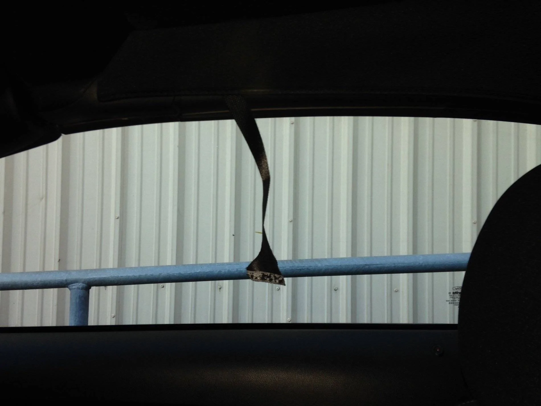

I’ve had a broken strap (pic), rear windows fixed twice, A-pillar leak fixed twice and leaking again. I also have multiple frayed straps and the headliner on the driver’s side often gets caught on the wrong side of the mechanism when closing. I have to open the top half way and readjust it. These are only the problems I’ve had related to the top.
This isn’t my first Mustang, but this purchase was specifically for a convertible. The selling point for the Mustang was the simplicity of this top compared to every other convertible available right now. I planned to keep it for 8-10 years and thought this top would be a lot less maintenance. I’m really glad that my hatred for leather drove me to buy the V6. If I had spent $50K on a GT, I’d be demanding a full refund. The quality is nothing like my mother-in-law’s Mercedes C300 for the same price, and it has the import markup. I won’t be buying domestic again for a while. My 7yr old Highlander hasn’t had a single problem, NOT ONE.

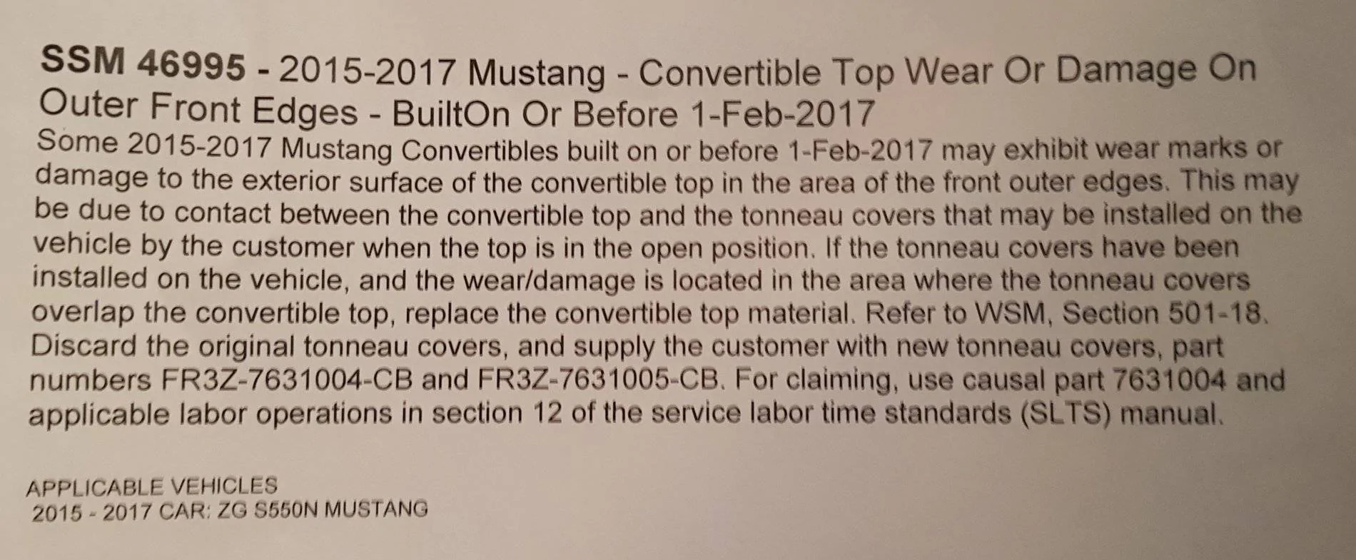

I've put together a thread on this (link below), it's a painful experience to get it fixed. Took two Ford dealers and over 18 months in the end but I think it's finally sorted just in time for the warranty to end...
https://www.mustang6g.com/forums/th...-for-damage-new-tonneau-caps-required.116472/

I m the one who started the thread. I was able to open the roof just 2 times for short drive since it was changed. First i can hear a big noise when i open it , when it s almost fully opened. It s the big grey platic piece that almost every time is in the wrong side if the mecanism. And i have already some wear marks on the side. So Nothing has changed and it added another issue when i open the roof. Just after the repair i noticed this noise , but dealer told me because it was winter blablabla.

Yes exactly this sound. it s only on the driver side for me. But if just before fully opened i put the platic sheet manually on the wright side no sound and the roof is not pinched like the picture i have posted where it is worn on the edge

It's caused by a badly fitted headliner, a new one is needed anyway due to the damage but there we go. They just need to get it right this time round, been there myself with my headliner after a roof change.
