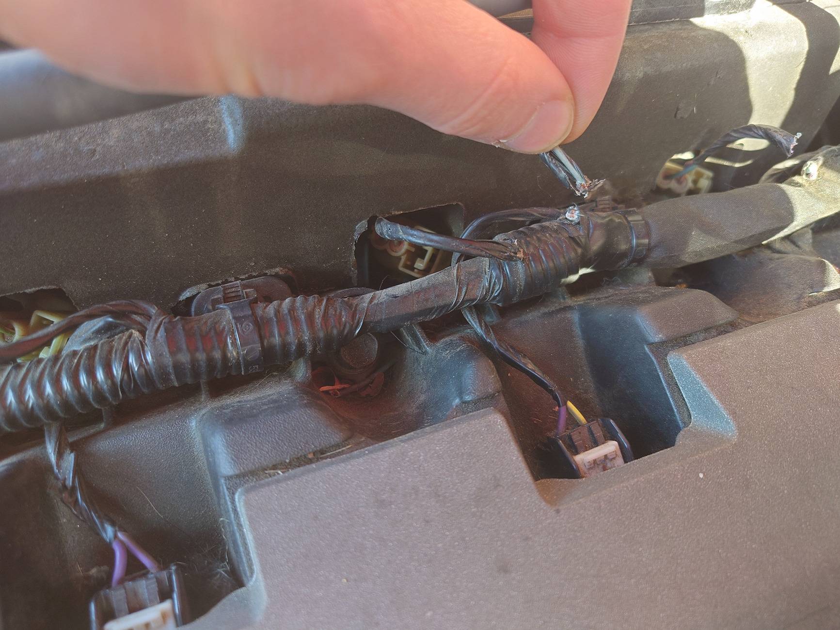

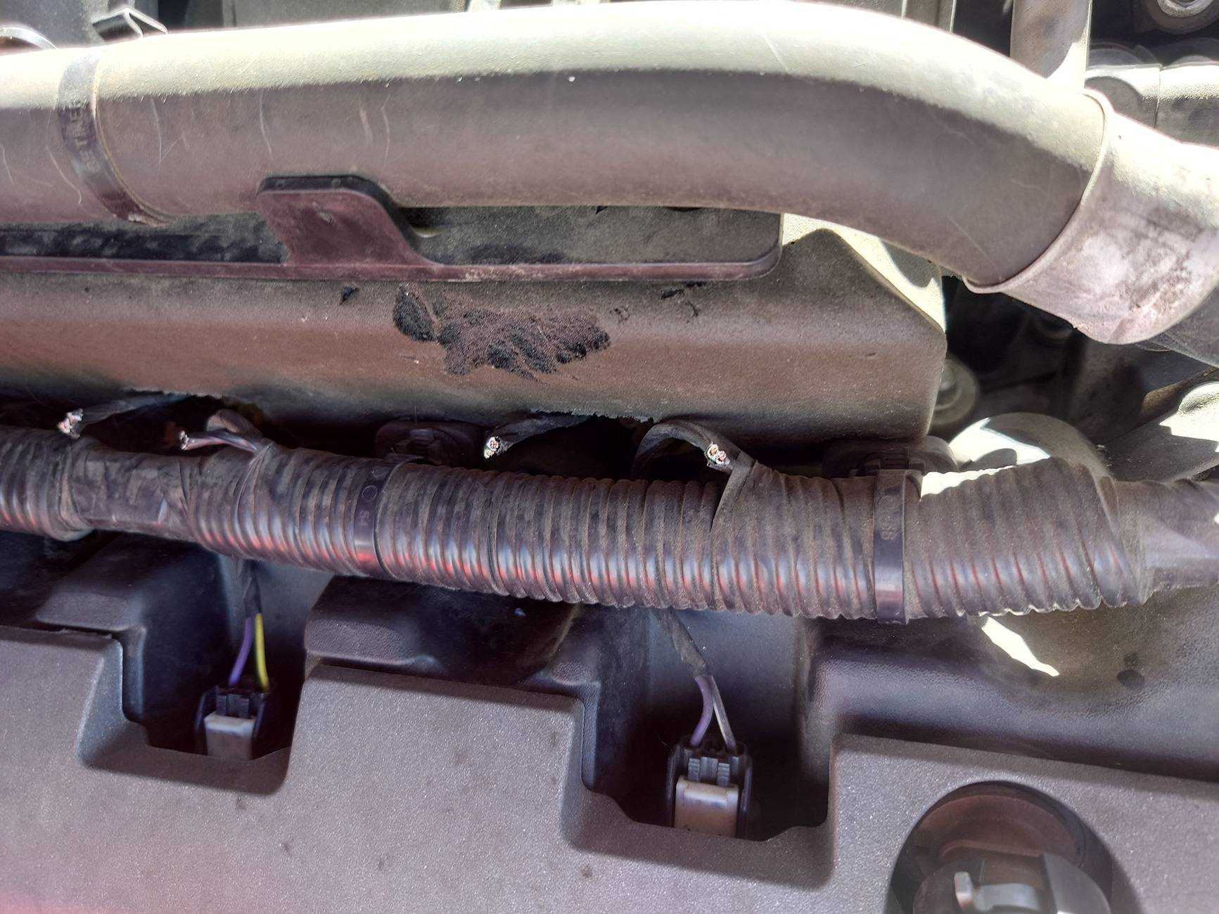

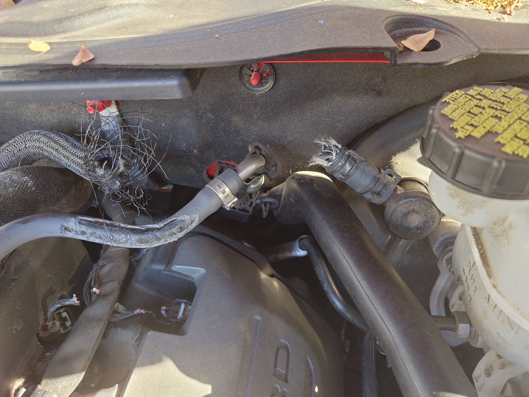

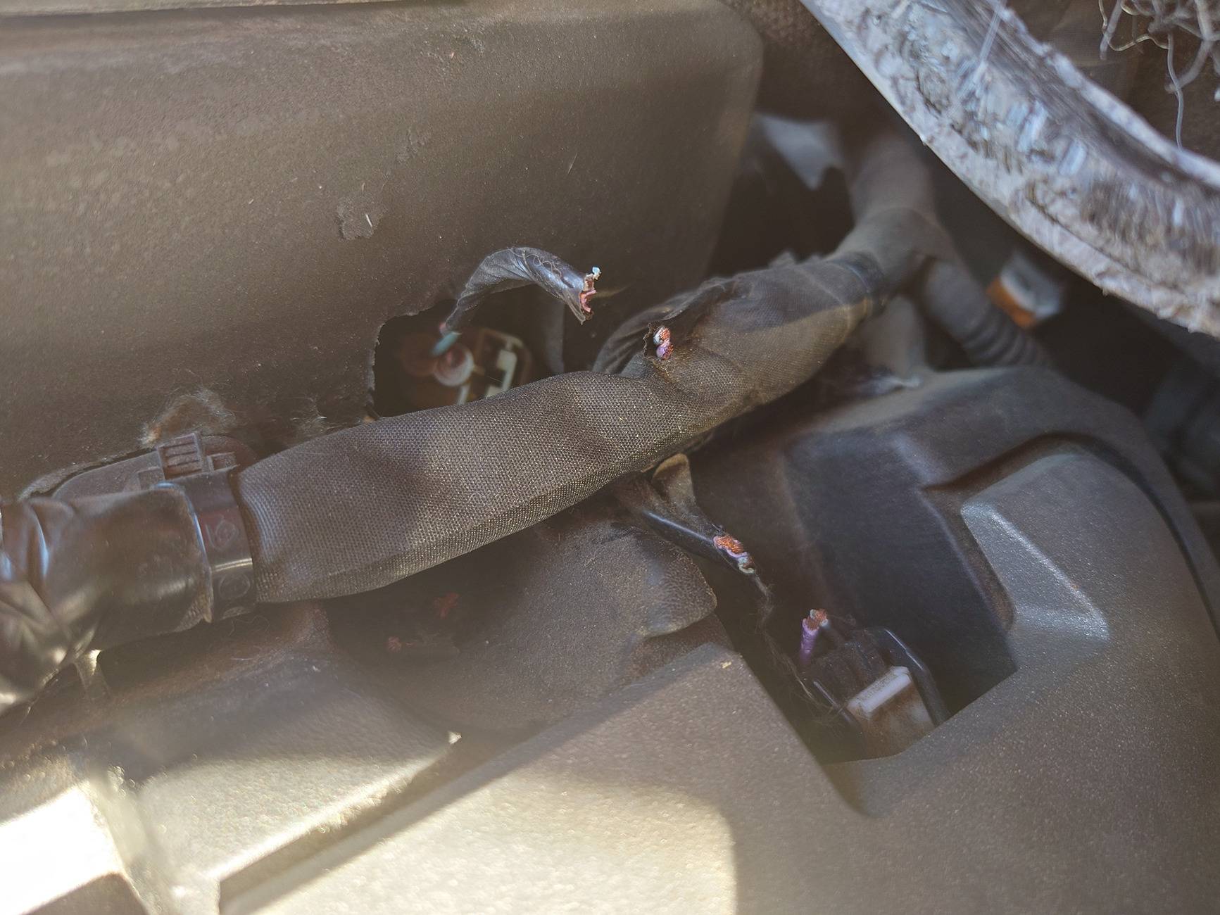

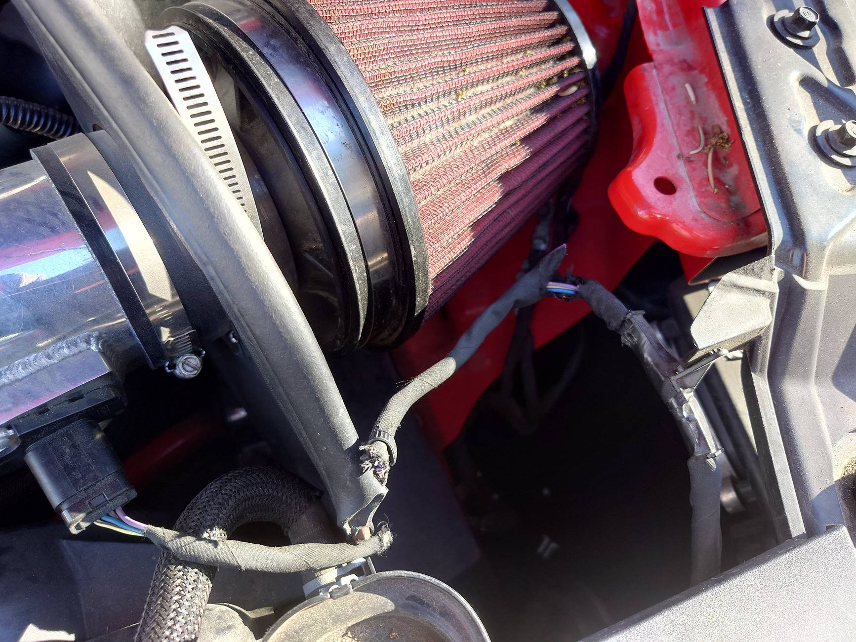

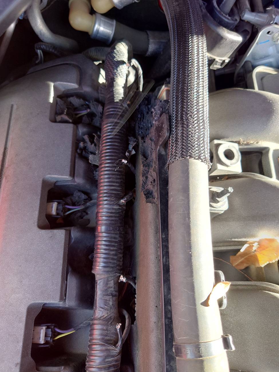

I had a rodent get into my engine bay and go to town on wires and materials. I'm trying to figure out the best way to get this fixed. Pics attached. 2017 GT
First thing - any ideas on how to make sure the creature is no longer in there/doesn't come back? The car is lowered and very low to the ground.
Second - can I just solder these wires back together and heatshrink them or this a better way to go about it.

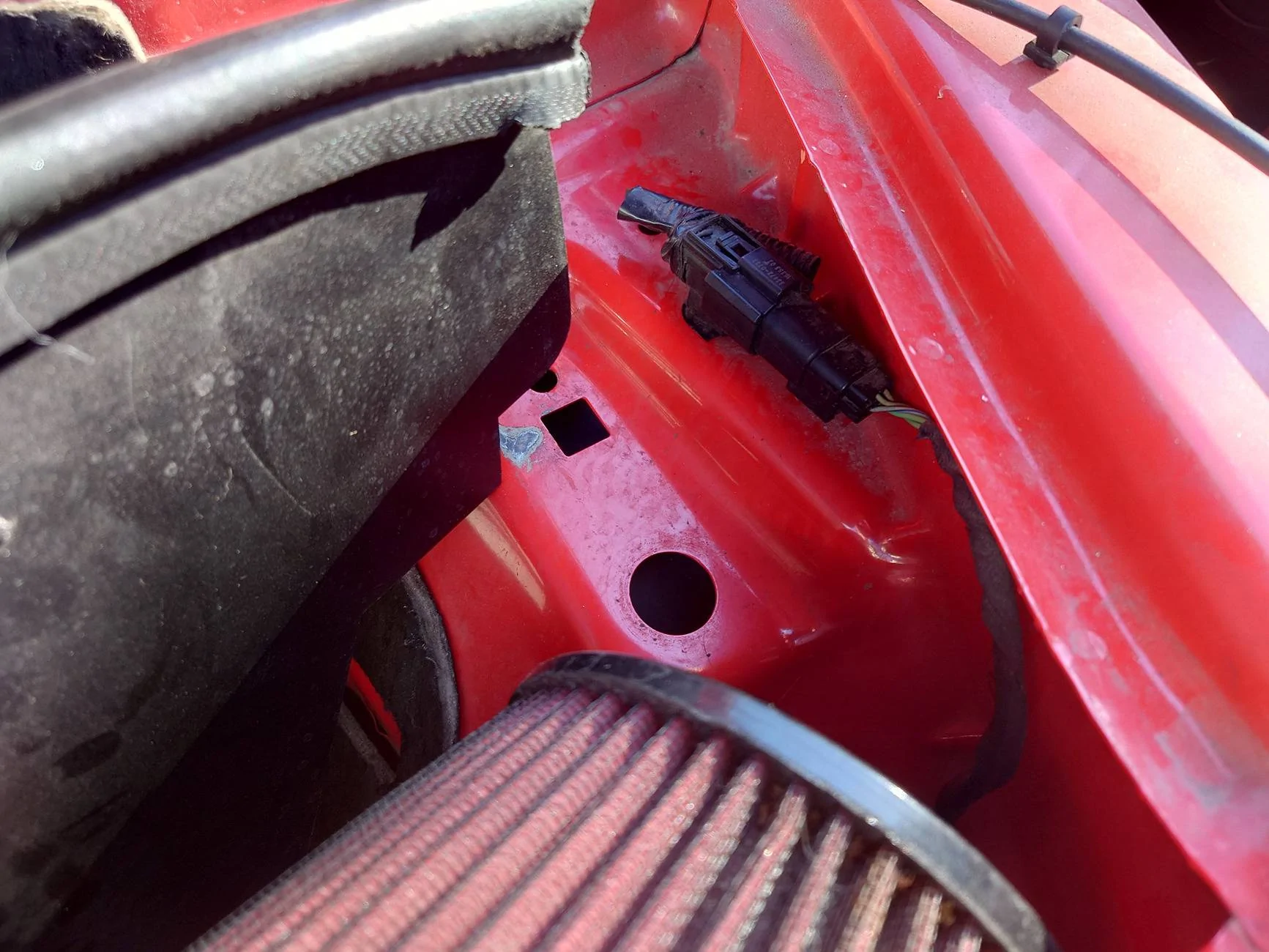

Third - second pic next to the intake..is there supposed to be another wire coming out of that towards the back of the vehicle?
Thank you for any help/advice. Car has been parked since it's winter and I'm driving my truck right now but I need to get her fixed up asap.

Oh my f...You may be better off just getting another harness altogether.
I assume it's being kept outside. You really should keep it in a garage with the hood up, lights on and sticky traps set around the edges of the walls if the car is going to sit for any length of time. If it's outside and there's no other way, getting a cat or two might help keep that in check.
I know this will come across condescending through the internet, but you really need to keep a closer eye on your car. That much damage didn't happen at once. Very sorry to see this. A true nightmare for anyone, let alone an enthusiast.

Wowsa…I have now fixed my 2018 F150 three times from rodent infestation. They have all taken nothing more than wires, solder, and an iron to fix, but yours might require more. I concur with the others, call your insurance first and see what is covered or not… And then get busy!

1) The plug by the CAI filter should just be jumpered i believe, defintely doesn’t go anywhere. Unplugging it just defeats most of the nannies.
2) I would (and you should) murder every one of those little pieces of s*it at any cost.

If this was my car and being, it's a 2017 I would look for a new or used wiring harness for the engine bay. I f you know what you are doing you could resolder the broken wires using quality solder, flux, and wrap.

I know this update is way late but I soldered everything back together and didn't need to add any wire extensions and insulated everything as much as I could/made sense. She's running happy and as good as ever and ready for a Paxton super that's coming in a couple of weeks.
Thank you everyone.
