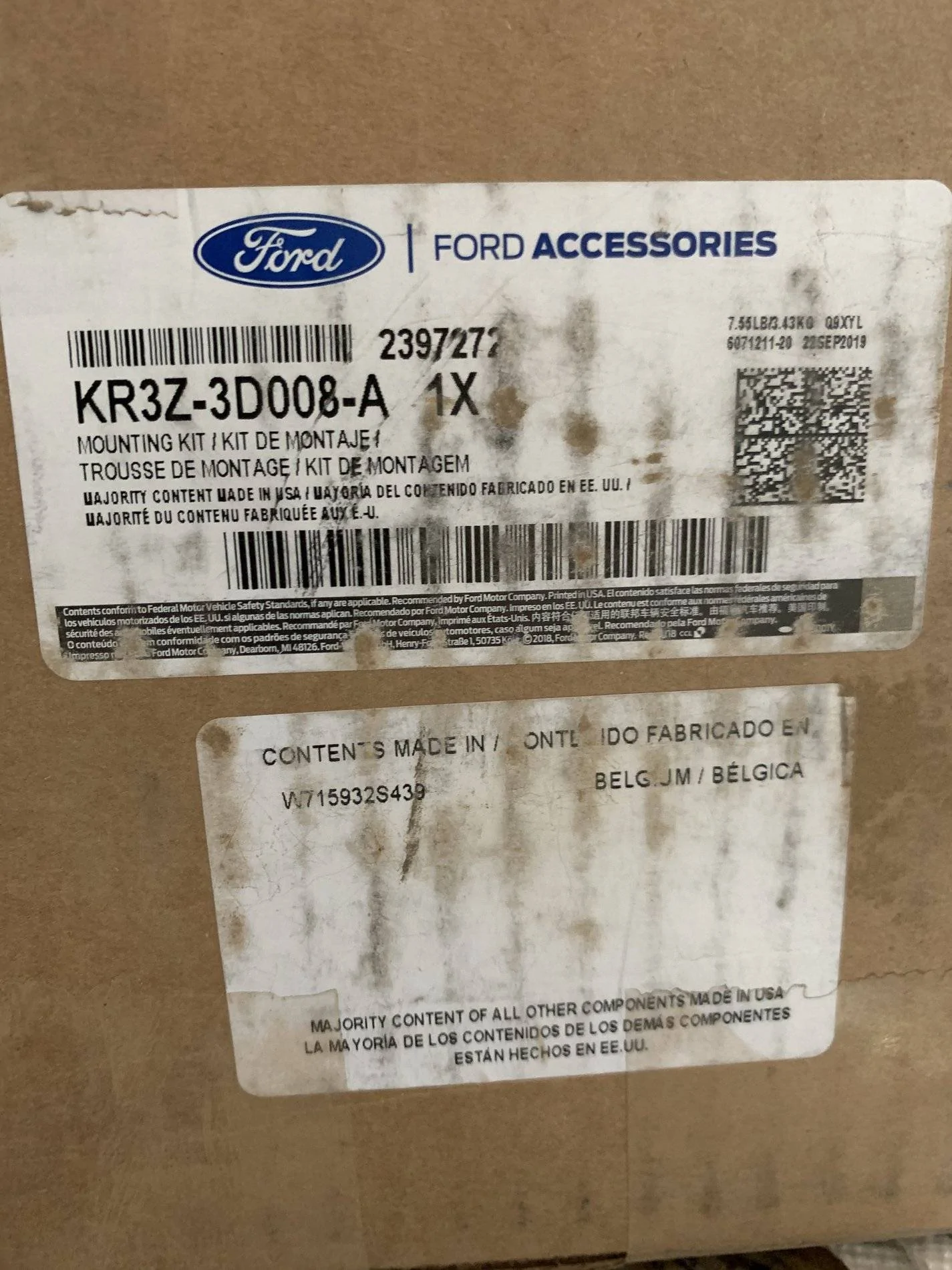

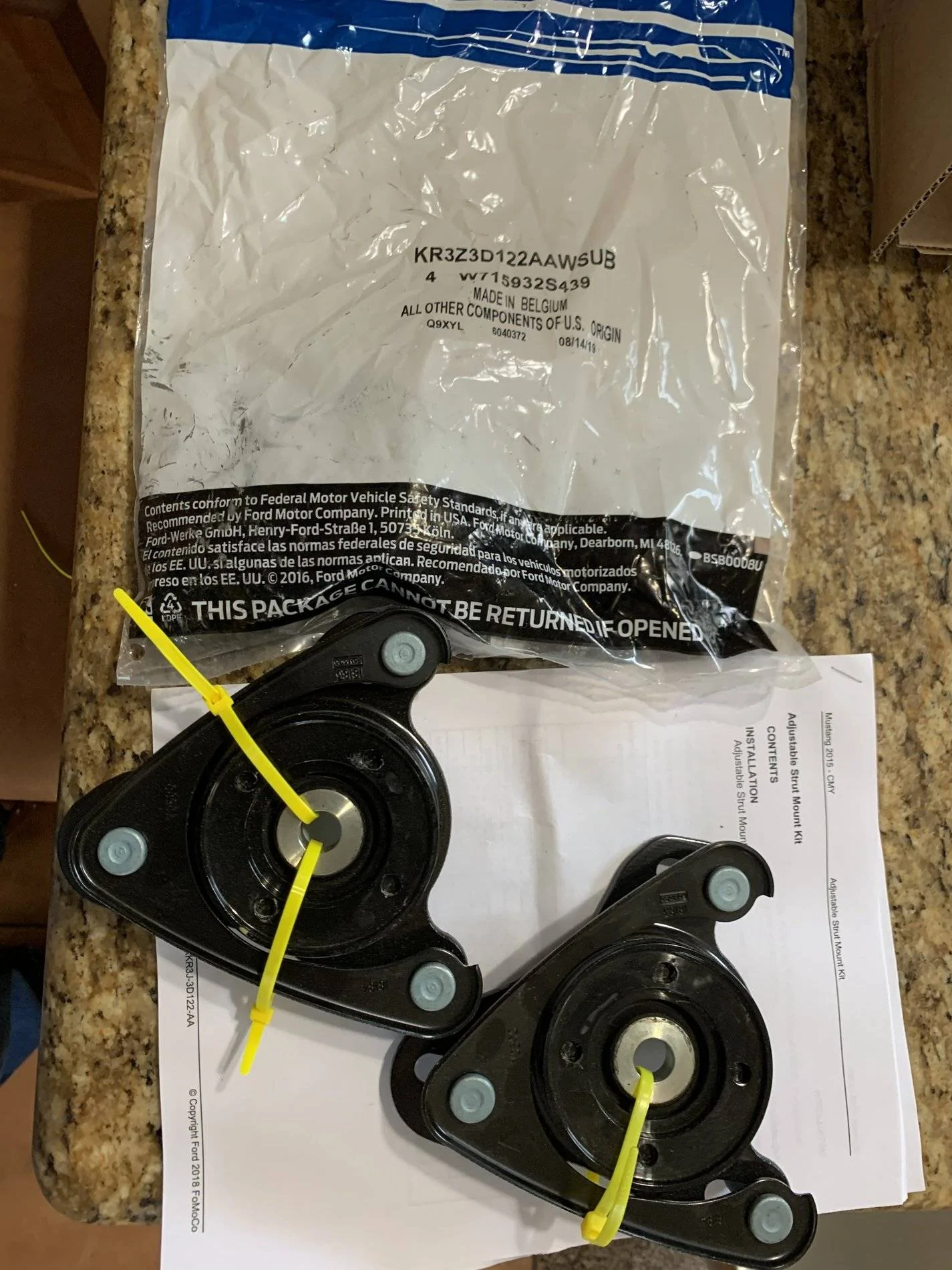

I heard a GT500 was on track and in 2 sessions wore through the outside of the front tires. He did not have caster/camber plates. If you only do one thing before your track event get caster/camber plates.
It is now being stated that the handling package gets the caster/camber plates. However it will be later in the year maybe this summer went owners possibly get them.
Unfortunately I’m going to Barber in April and more than likely will not get the caster/camber plates in time.
Well my worries are over ups just showed up with:
Barber motorsport here I come!!

I just noticed I have something coming via UPS from the dealer. That box have your VIN anywhere on it?
