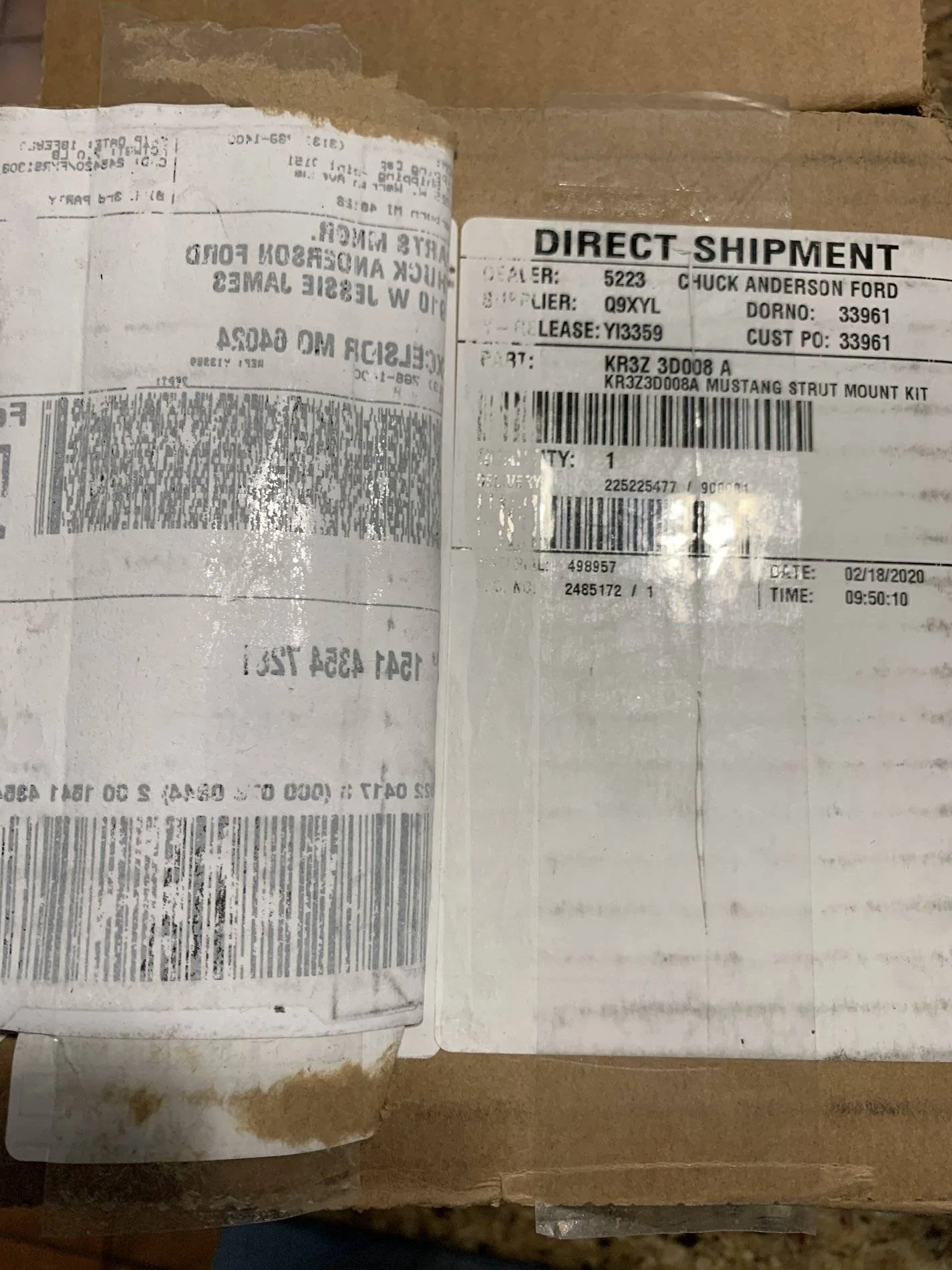

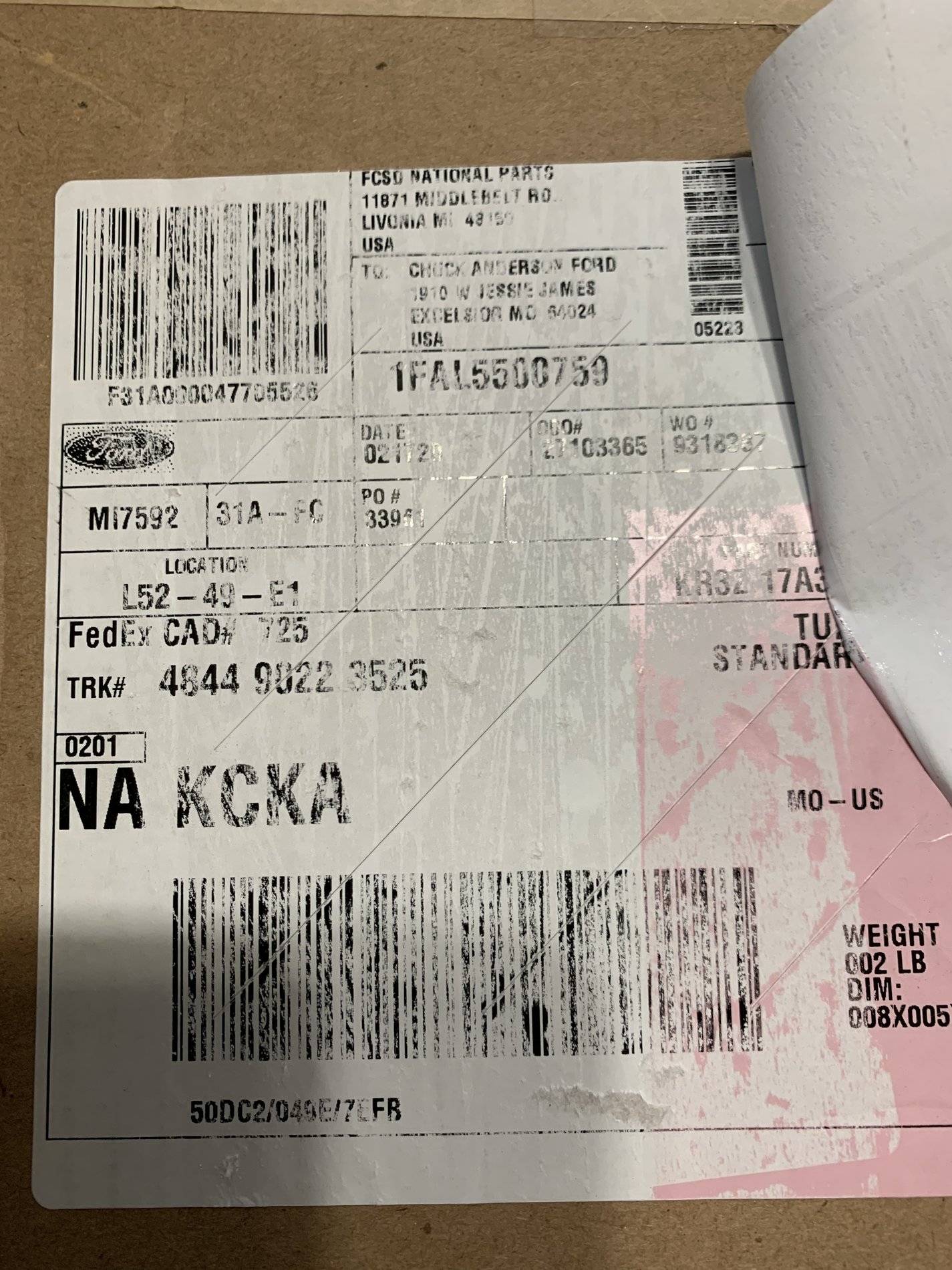

I just noticed I have something coming via UPS from the dealer. That box have your VIN anywhere on it?
I removed the ups sticker and the stickers from ford don’t have the vin# however the license plate bracket does have the vin#

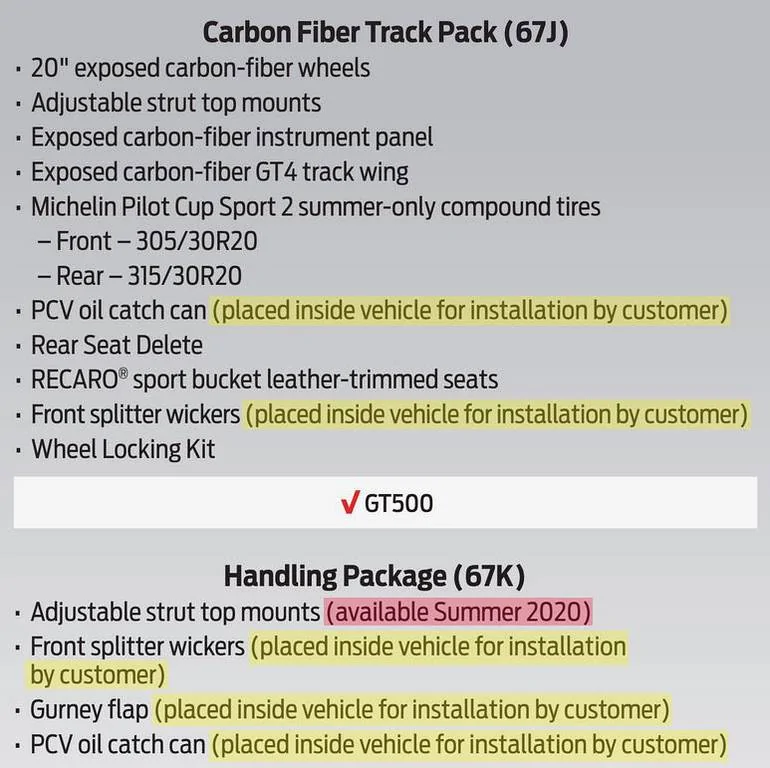

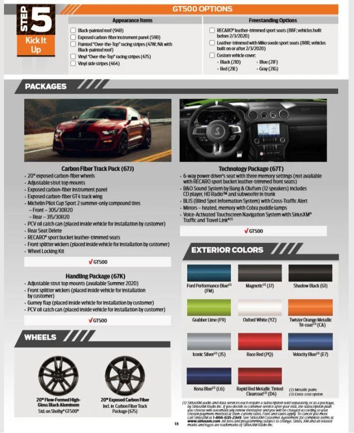

The only thing Ford has shared regarding the Handling Package cars getting the plates was in some dealer sales support literature, released just over a week ago, that I posted in another thread. Like you, I was at the brink of buying them as well.
On a related note, there's more to this story. Other Handling Package owners may not be getting their plates yet. PM being sent to you.

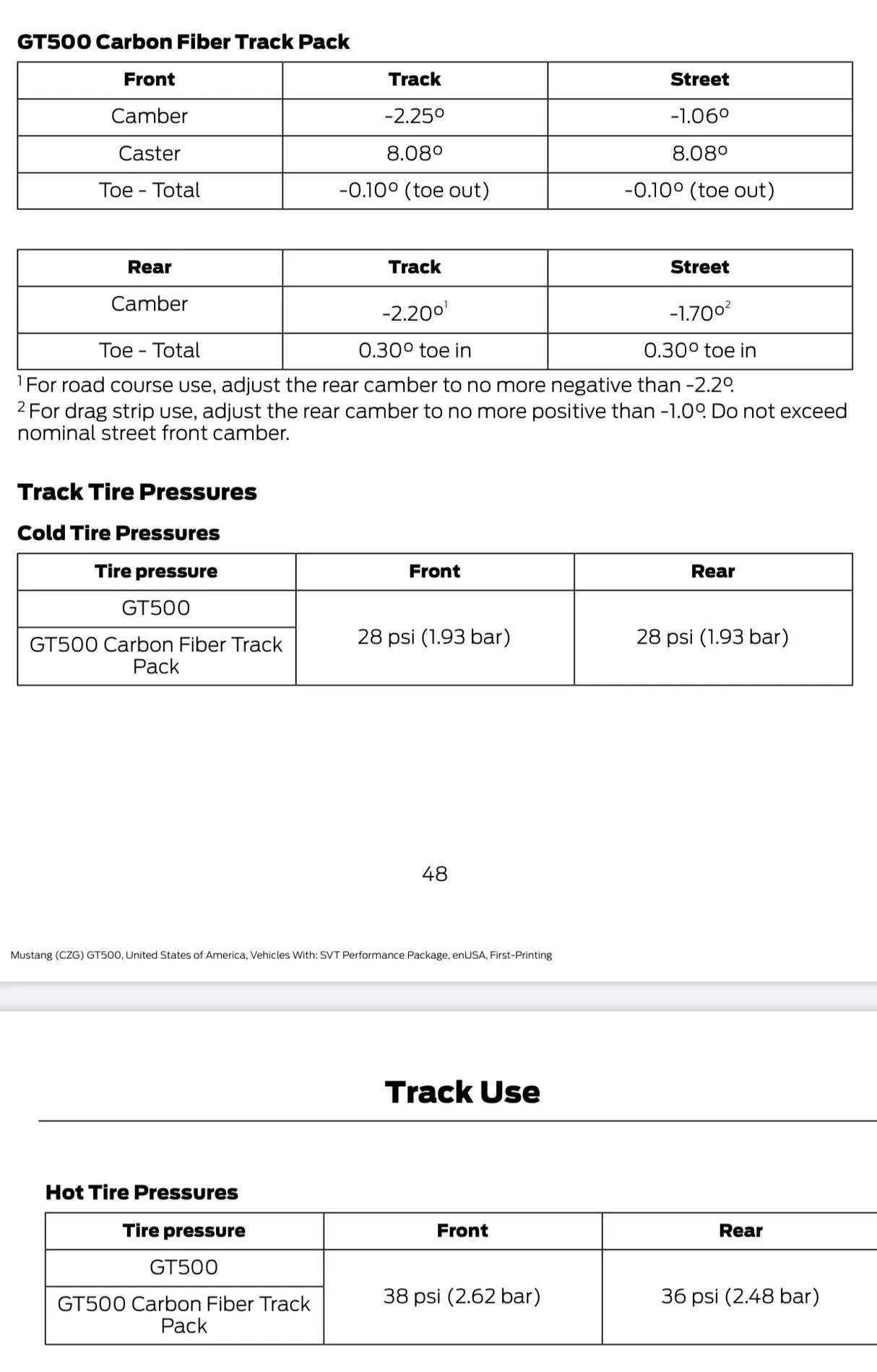

Factory settings are -2.25, I went a little further. Right there in the GT500 supplement.
The car wasn’t set up right for RP / MT. No wicker splitters, wing was in street setting (low), rain tray was still in. So I can’t imagine they set the camber alignment correctly and forgot all that other stuff. The wasn’t set up correctly for any of those tests.

Oh, I have all the data from the supplement and have studied it closely.
Trust me, it was like pulling teeth getting clear answers about all the setup details. Randy's article was nice to read but either lacking or ambiguous. That database will grow as more and more track these cars so your own settings and comments are indeed helpful.
