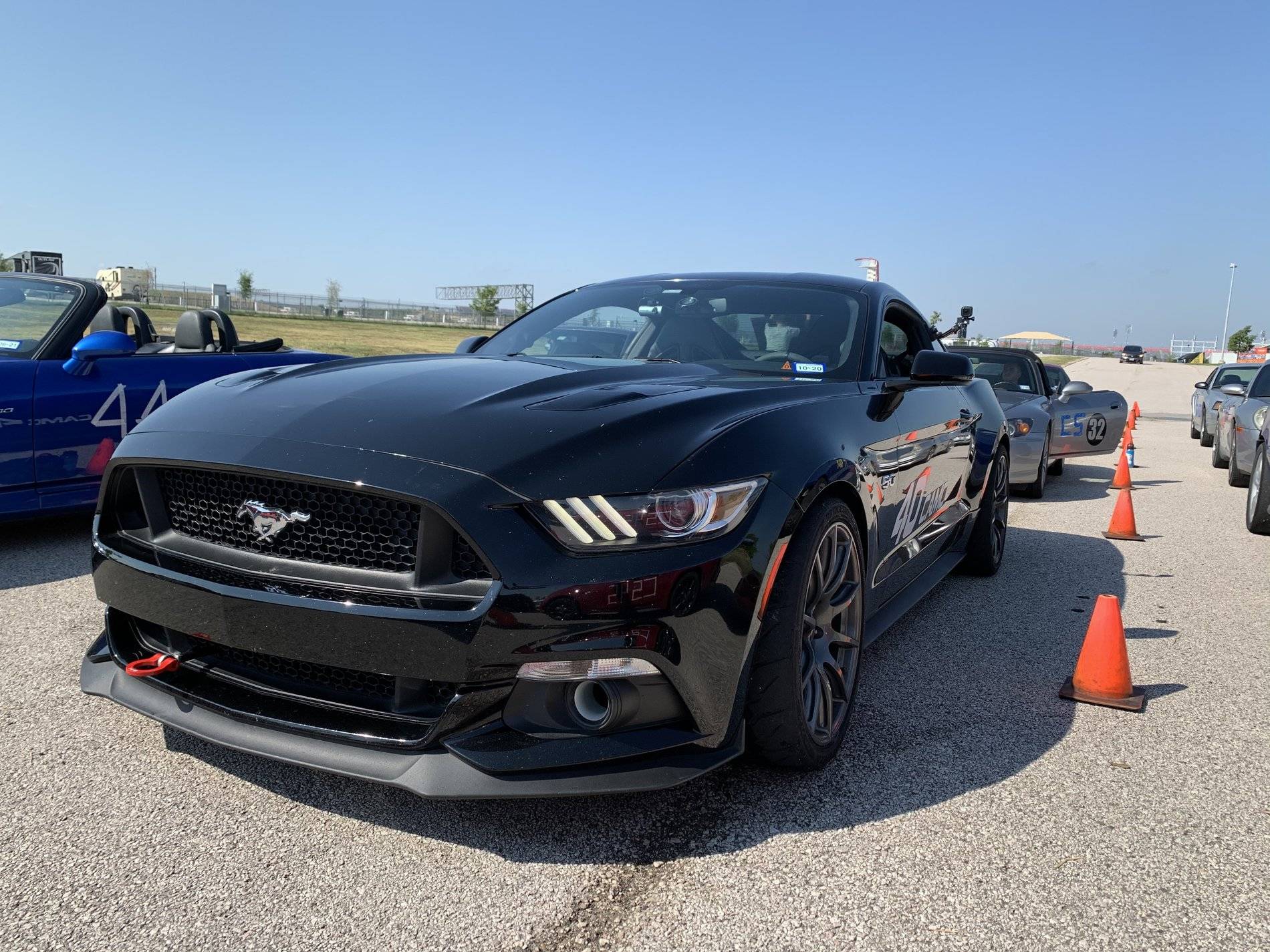

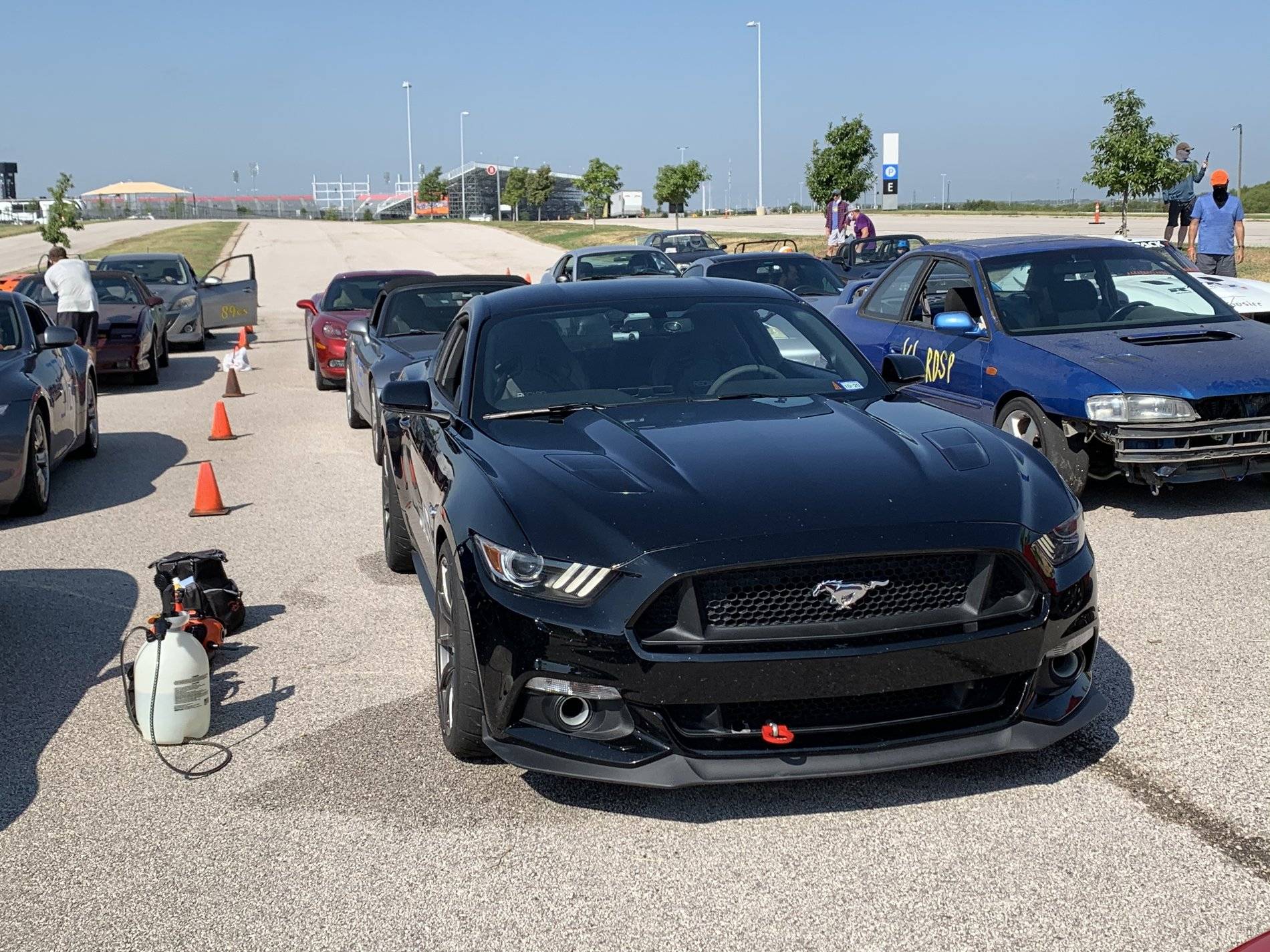

Heres what that looks like with Apex SM-10 19x11 wheels and 305/30R19 rubber
