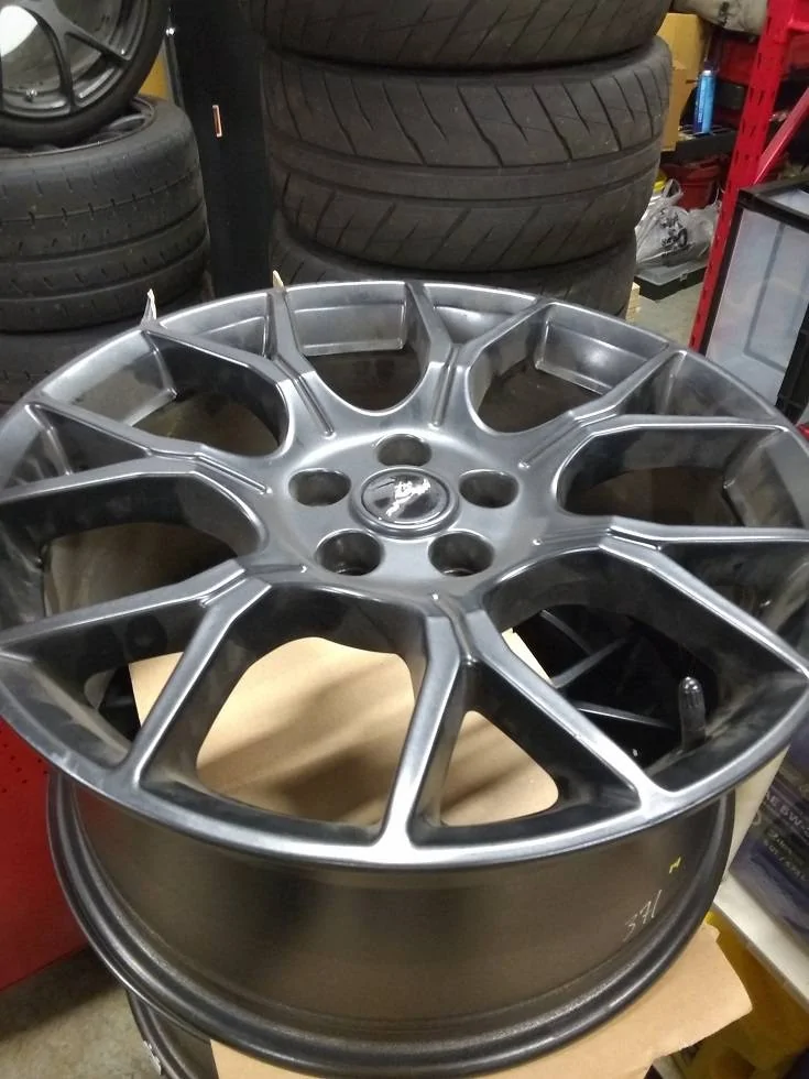

19x9 EB/PP wheels (kinda look like PP2) need a new home.

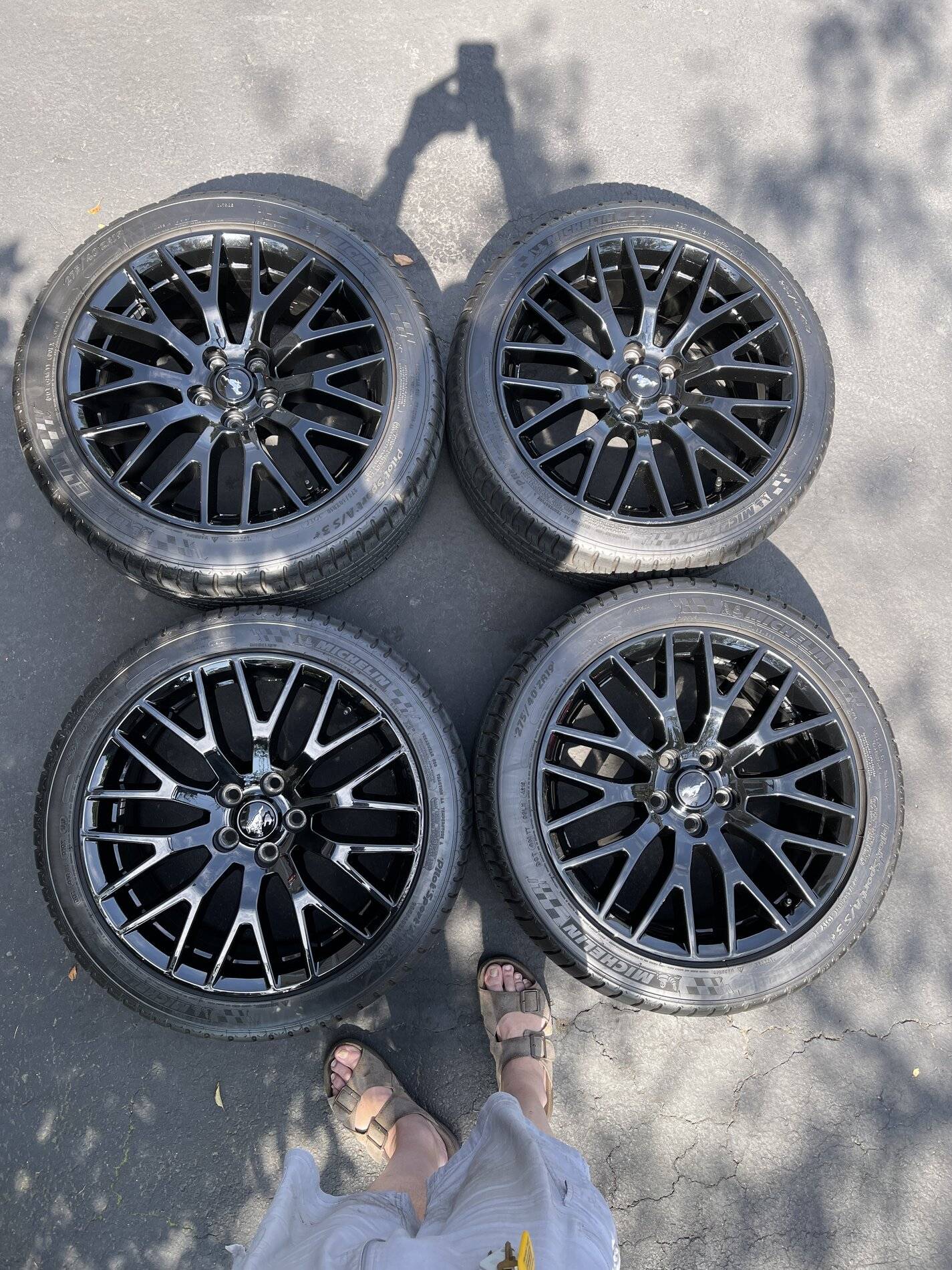

Yeah actually I picked up a set of PP wheels that are the same as mine with Michelin Pilot Sport AS3’s on them. Thanks though
