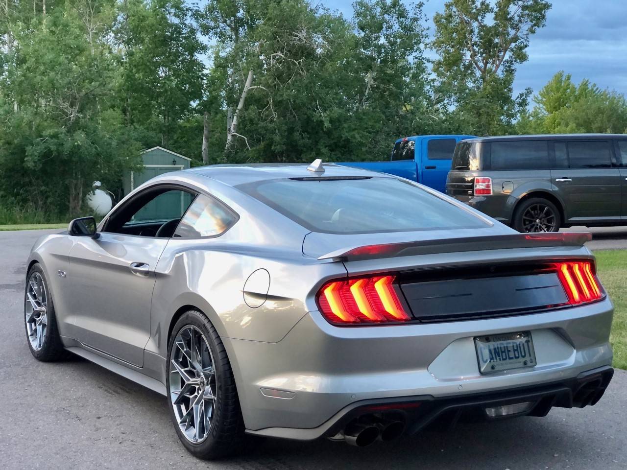

Agree with the other guys, 10" wide wheel at +35. I personally run 20x10 and 285/35r20 all the way around. Spec wise they are identical to the 19" specs given, just a 20"

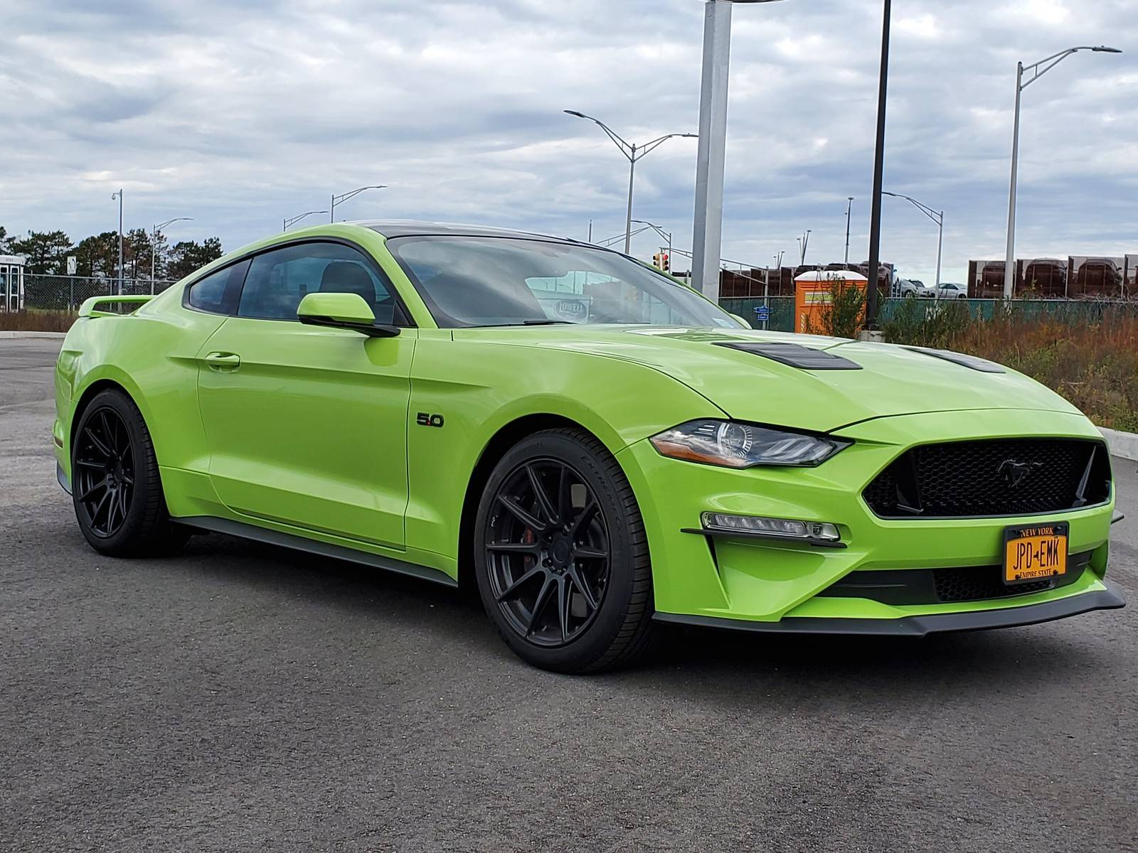

These are the exact specs I mentioned above

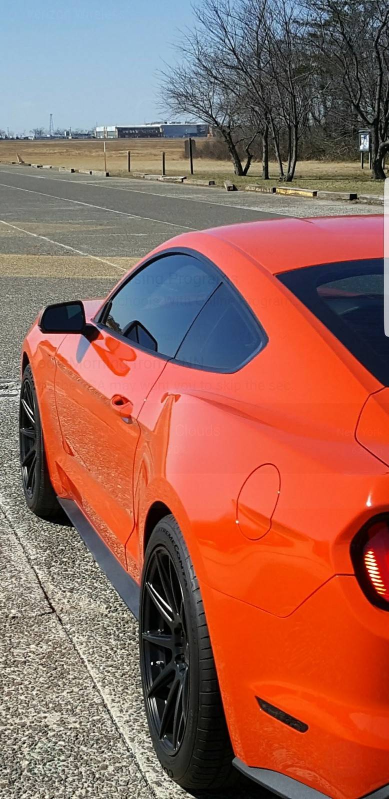

Niche Essen 19x10 et35, Conti DWS06 275/40/19 all around.
Stock Magneride height.
20201204_114251 by chefjpd, on Flickr

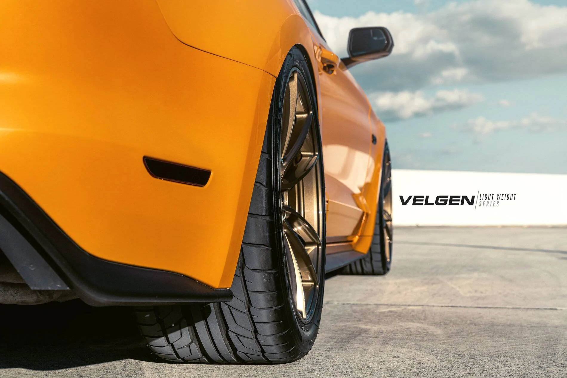

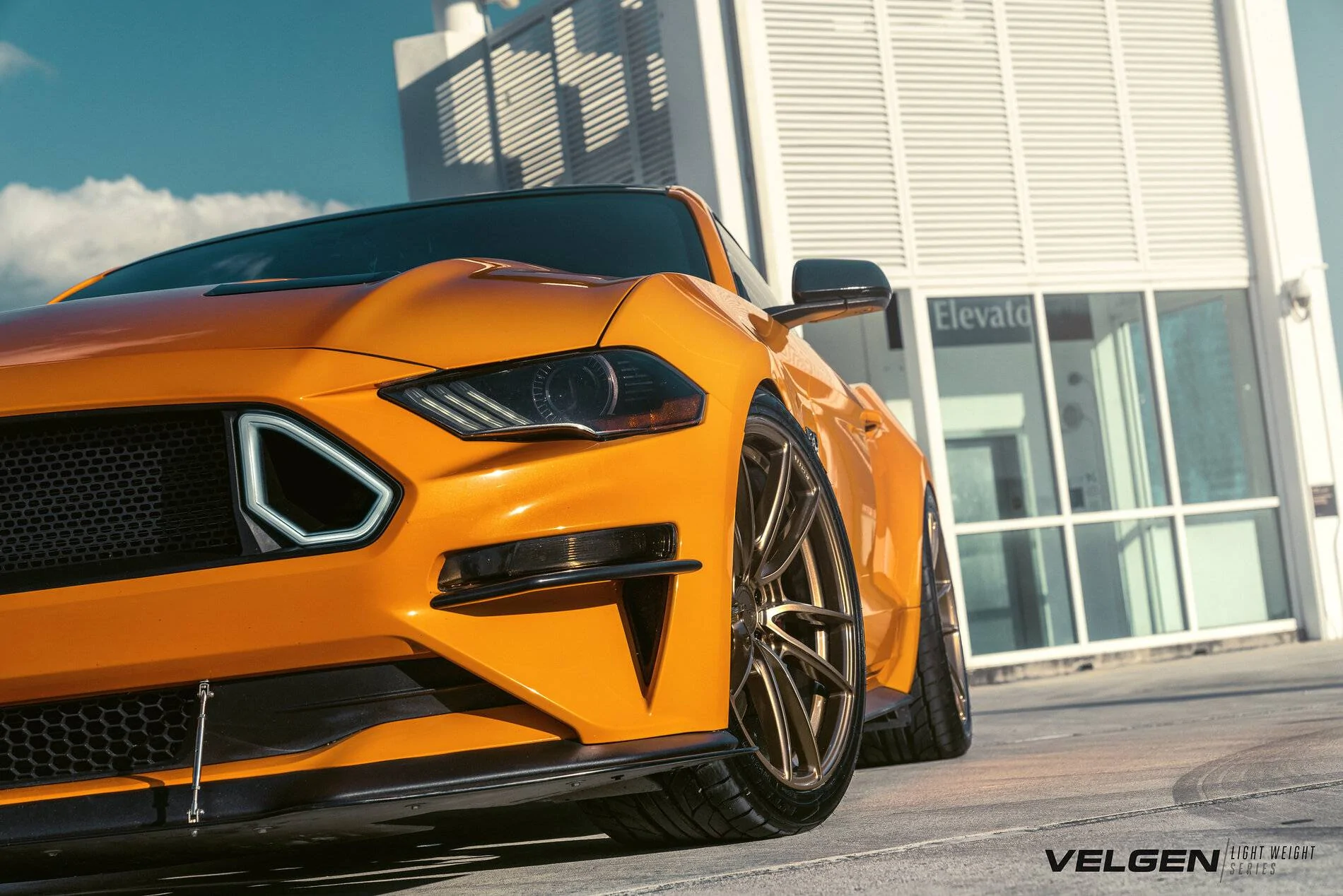

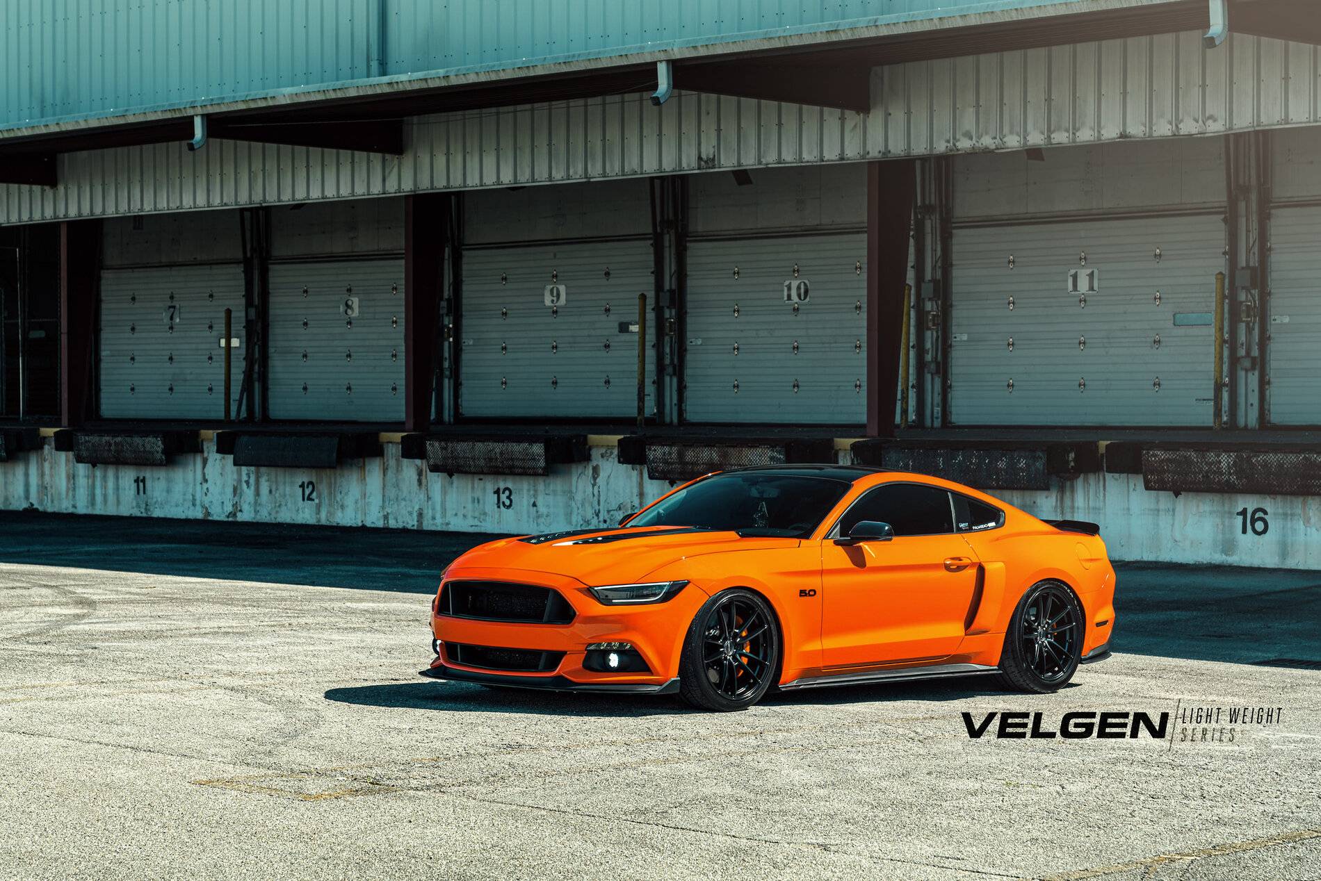

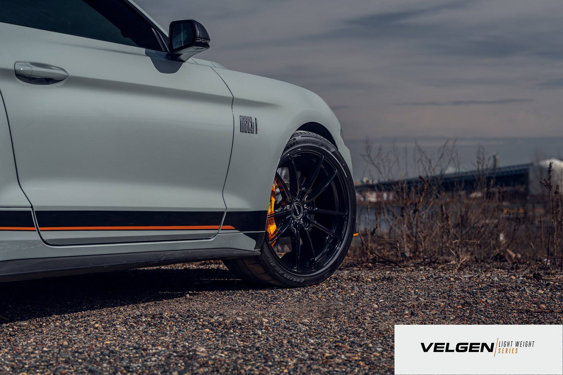

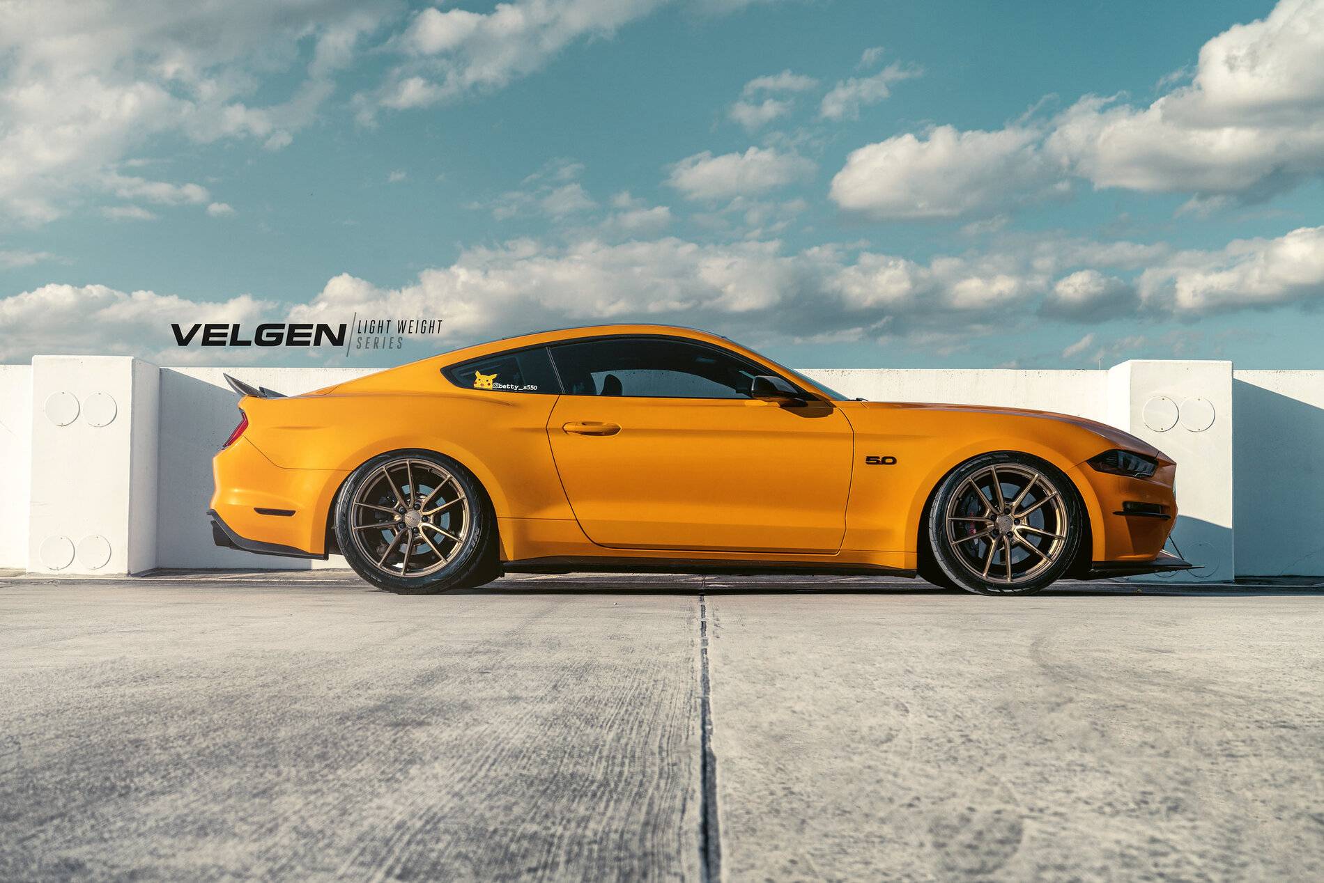

We offer different fitments for mustangs. Our most popular is the 20x10 Front & 20x11 Rear, with the right tire & tire size it looks really aggressive on the Mustangs. We also run a 20x9.5 Front & 20x10.5 Rear.

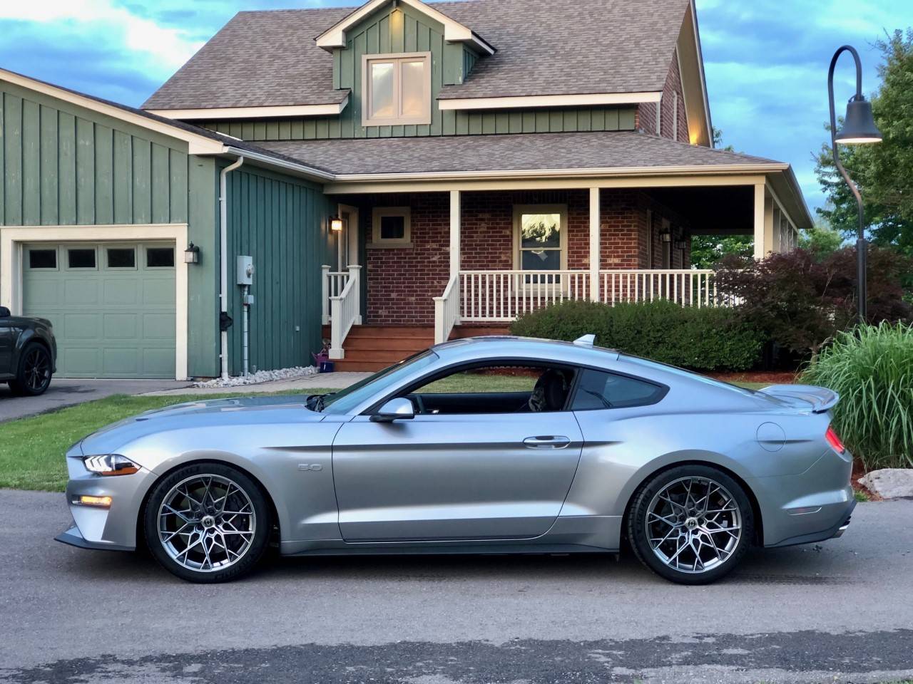

What wheels are those?
