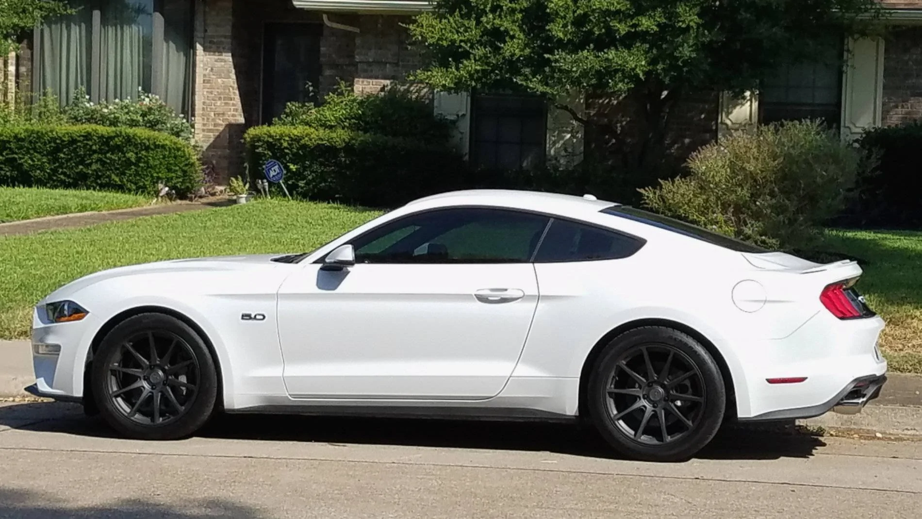

That's my setup exactly. 19x9.5 ET33 with 275/40 tires. This is stock ride height but I will be lowering it with BMR minimal drop springs. I would like the look better with wider rear wheels/tires but the square setup handles well and I like being able to rotate tires.

Any tendency to follow grooves on the road
with the large front tires?
I wondered about tramlining before I got them but it's not an issue at all.
