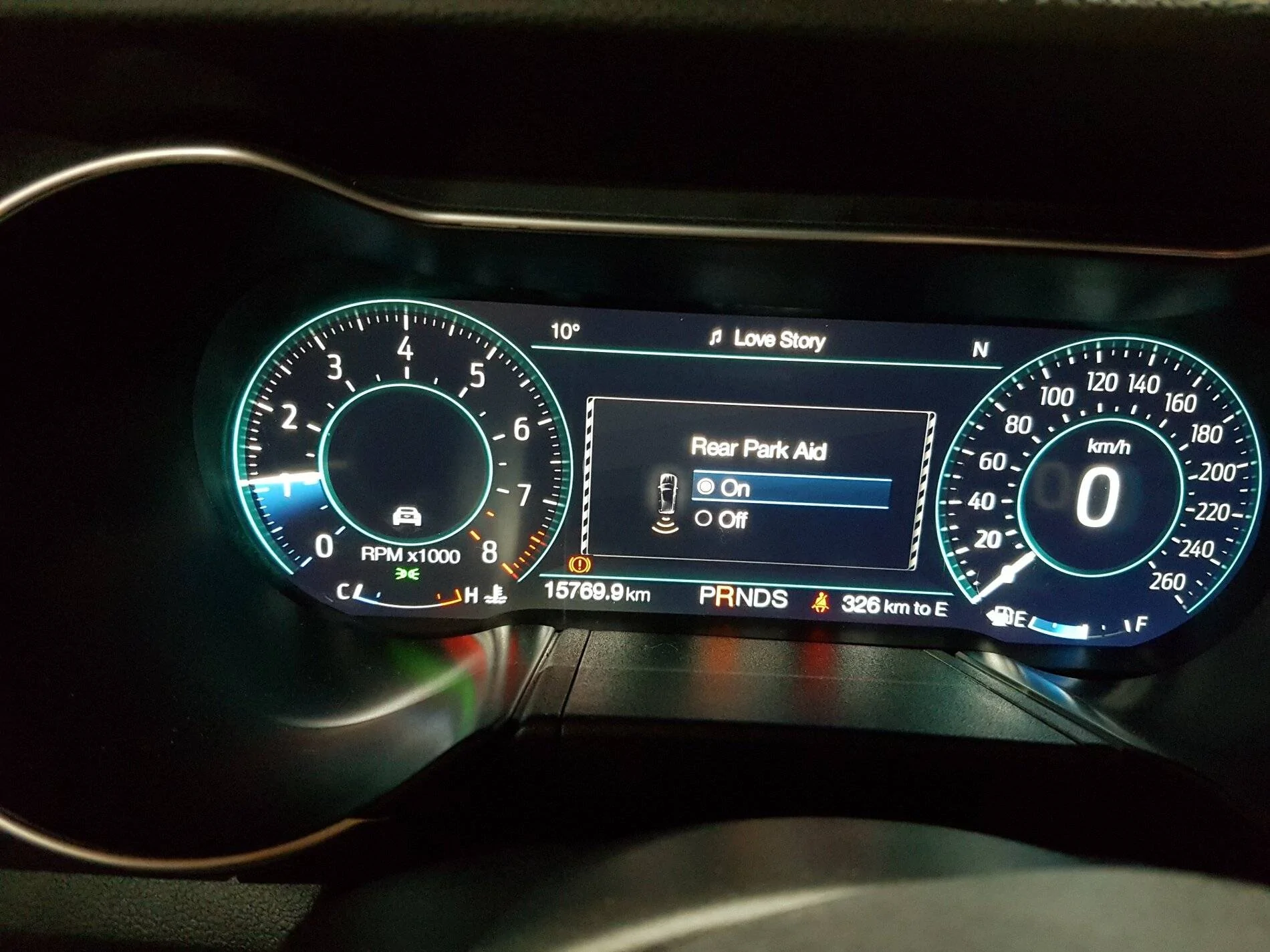

I surprised nobody has mentioned this. When I put my car in reverse I get this message on the dash. Turning the beep off is that easy, just hit the down arrow on the right side of the steering wheel and press ok. It'll stay off until you shut the car off and restart. This car has a digital dash, my Edge does not and I get a similar message on that vehicle as well. I'd prefer it stayed off permanently but it not a big deal to turn it off.

There's also an option to turn the reverse sensors off in the settings menu. But I'm not sure if it's persistent or it resets itself upon the next engine start. I haven't tried it.
I don't want to disable the sensors. I'd just like them to sound a bit softer and, better still, not to mute the music while they're beeping.
