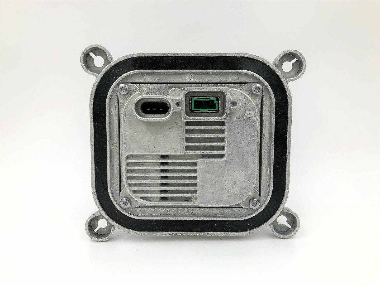

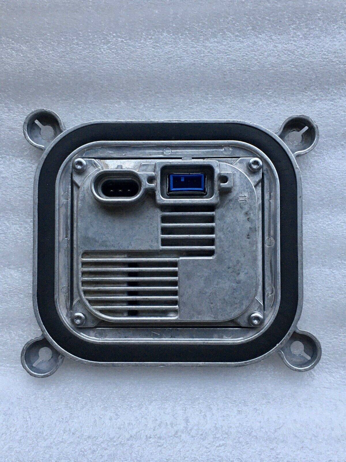

For legal reasons my car can't have D3S light bulbs (d3s requires washers and levelers, d8s don't), so I need to replace them with D8S light bulbs. I know there is topic about D8S to D3S. What is unclear is the cables. Don't D3S and D8S have different sockets?
D8S
D3S
Or there are also EU and US variants? Or ballast usually come with new cables?

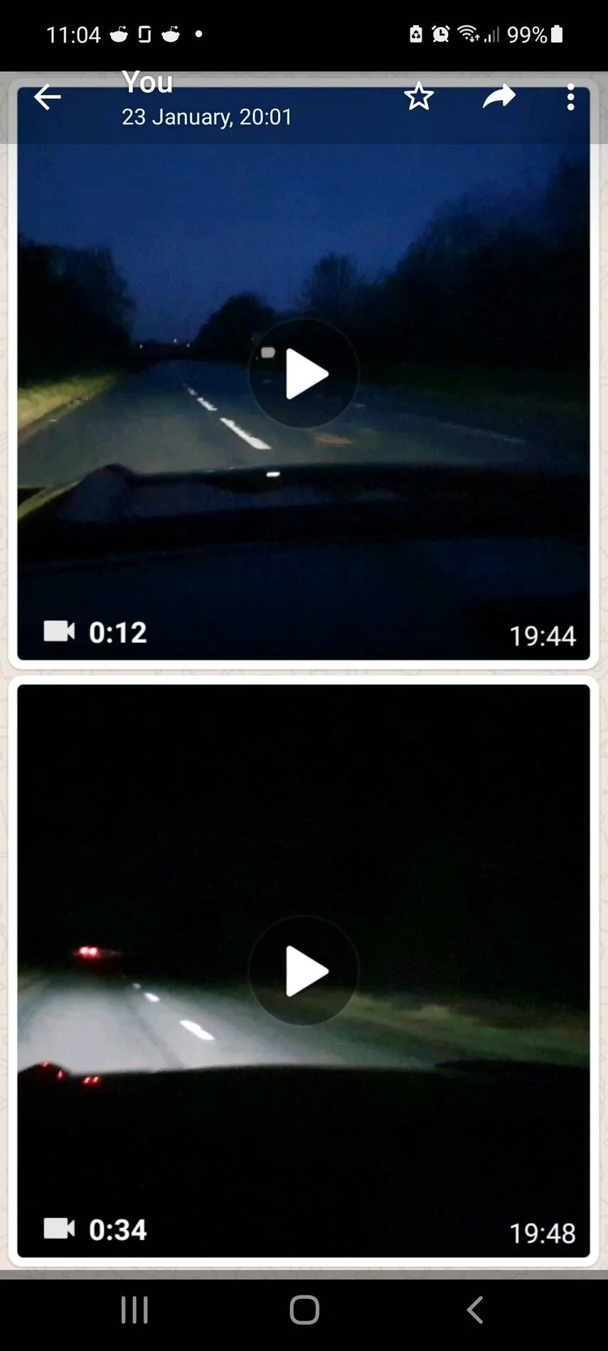

I've done this and I can tell you now its the best mod you will ever do. What you need is a pair of ballasts and cables from a jag xf or similar that uses d3s and then undo the little screws and swap the ballast internals into your d8s cases. You need a set of really good d3s bulbs I went with the night braker ones. You have to cut/dremel a little slot in the plastic case on the bulb so thst they fit that's all. It's dead easy using the original bulb as a template. I may have put photos up on here showing the difference.

There you go top was obviously before. The light is brighter and goes much further up the road now.
