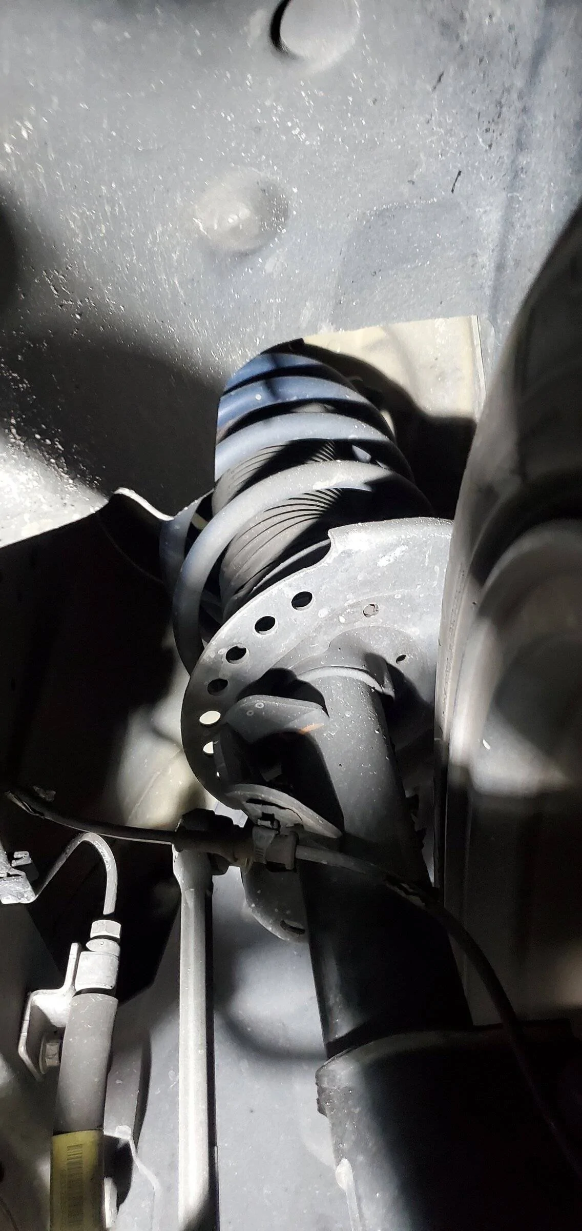

I have a lowered pp1 car. I bought the car used so i dont know what was used to lower it or what dampers were used. While doing my header install, I was trying to see if I could figure out what was used, and still no idea. I see no tags, or stamps anywhere.
If I post up a picture, do you guys think you can identify the setup? The car rides and handles pretty damn good, however if its on stock dampers, I think some improvements could be had with the ford track stuff.
The coils are Blue, so in my mind theyre either ford track, or steeda, but i see no markings and the damper is black. Someone (could be factory) paint marked every radius rod, and strut. Looks to me like someone was doing a thorough job setting the camber. It does have MM camber plates, so there is plenty of adjustment.
The strut is black, and the dust boot (at least on the pass side) is a bit mangled.
I'll add a picture a bit later.

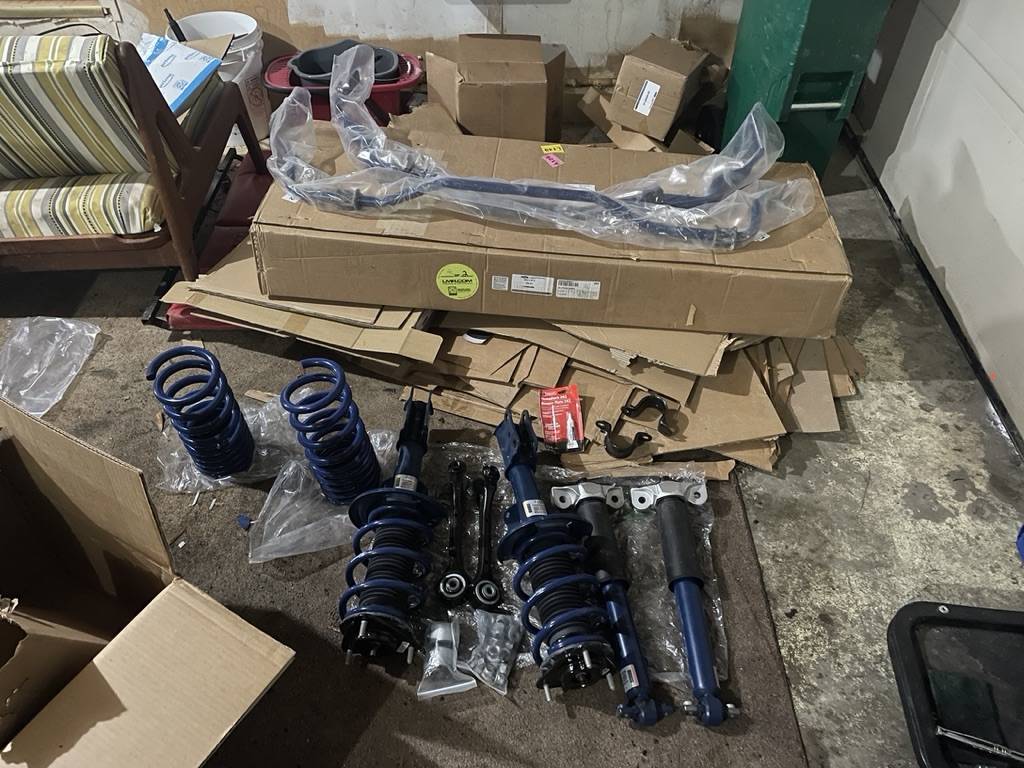

This is a picture of the Ford track suspension (FR3). Blue springs, blue strut body and spring, blue shocks. You'd have blue sway bars as well in the full kit. You can buy blue Ford springs separate however. Look for the rear springs being progressive rate to know if it is the track kit.

wrong color for steeda springs. at least in that light and level of dirt. Toss the factory dampers all around and get new springs. If after disassembly you do manage to identify what they are, you might be able to get a few shekels but shouldn't be a consideration to move forward.

Could be Ford Performance springs based on the color. I would try wiping them down and looking for a part number.
If the struts and dampers are black they are surely to be the OEM PP1 parts.

Blue Ford springs will have the Ford logo and will be marked X or Y.

I'm sorry about the muck. I'm doing headers and some other stuff so I didn't bother scrubbing anything down until work was done..

Update: These are steeda progressive most likely sport drop springs.
I snapped pics of the rear where I could see the numbers. I called steeda and got a close enough answer that they're not the springs I were hoping for.
