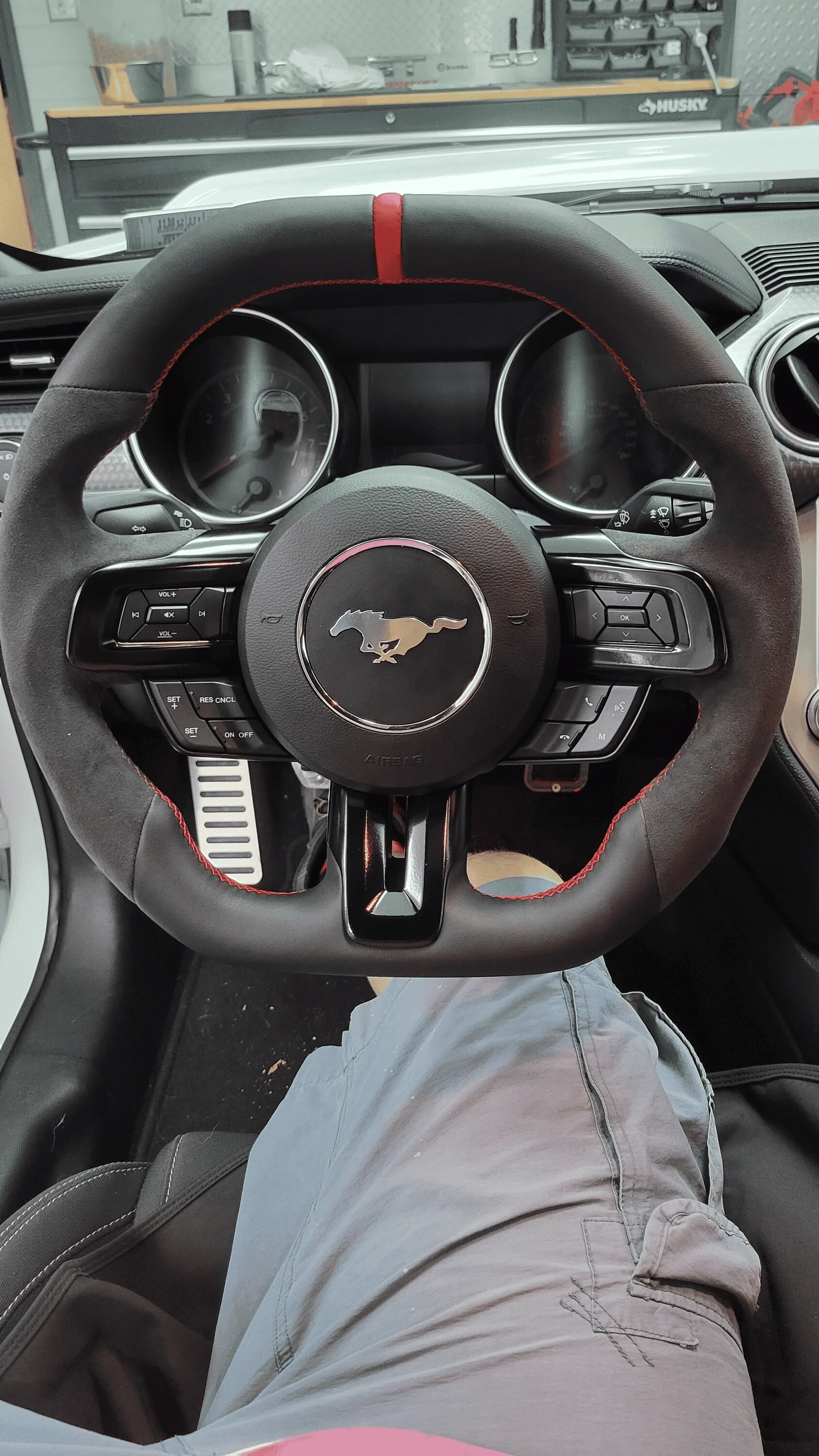

Just installed. Got a little nervous with the wiring harness.
I'm going to repaint the control covers more of a flat black.

Whose wheel is this? Link to it.

https://www.ebay.com/usr/cfautomotor
Its actually from Ebay. China. I had it custom made flat top and bottom. Alcantara on sides. Leather top and bottom. Took 12 days from order placed. Just tell them your year wheel. They will do it. They will also send a pic of your order before hand. Tell them you made one for my Mustang Friend. It was 385.00
All I can say is wow and perfect fit.

Thanks. Actually THE worse part was trying to remove old wheel. Took hours playing with the left side using an Allen key then a screwdriver. The wires were actually in the way. They were also stripped because of the trouble I had using a screwdriver in the hole. I had to re tape them.

Agreed, the most difficult part is the pins you have to push in on the side to release the airbag. after that swapping the buttons is very easy with a torx bit. I went with the GT350R steering wheel
