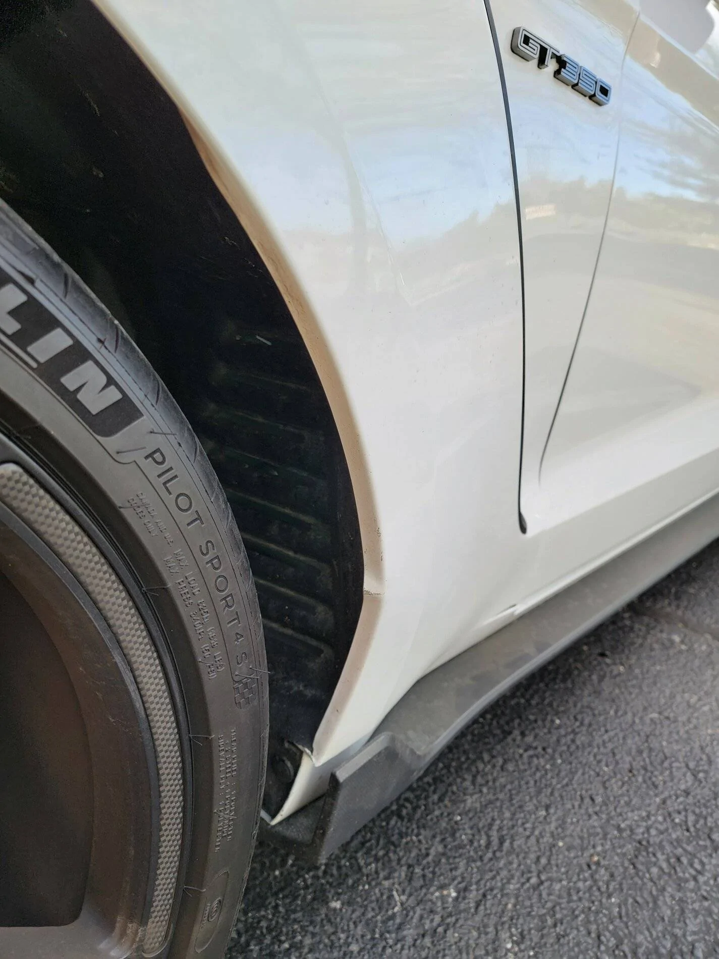

Is the fender pushed back due to being impacted? How did that happen, can you post any more info? More info may help others to help you out.
Jackstand slipped in the lift point of the car and pushed up on the rocker molding and fender.

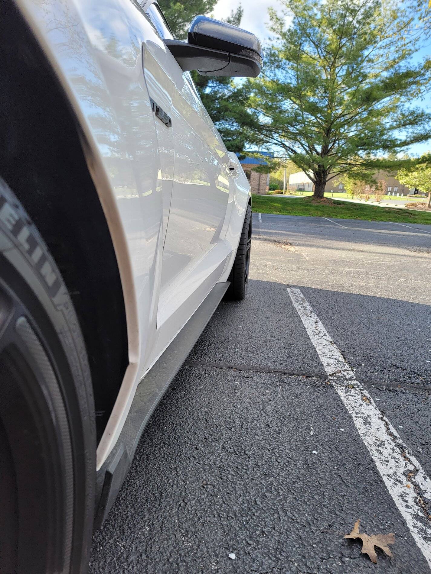

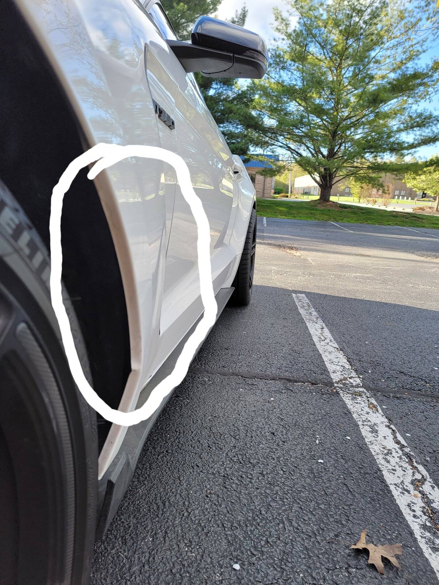

This section here is out of shape and pretty much further out. But everything else on the fender is good even the gaps. None of the paint broke.

That damage would be a stretch for a pdr repair. As for a body tech getting that back to original with a blend, that’s a simple repair. Where it gets a little tricky is what the estimate on the repair labor is compared to a panel replacement. I don’t see any creasing in your panel other then the inner lip. Replacing the panel would require paint work in to the hood and door. Repairing the lower fender would need a blend just in the lower fender and lower door. Depending on how good your eye is with colors that would be much less noticeable if at all. Depending on the shop you take it to that’s probably in the 6-7hr range for body time plus paint. There will be extra time in paint for de-triming the car properly.

I would say that is likely repairable. The rocker moulding might be smashed too much though. It is too hard to tell in the picture. The fender seems pretty minor even for it being aluminum. The paint split on the fender edge where the crease is. If that is truly the only paint damage and no other dents, you could probably get away with only painting the fender and the rocker moulding. If you live in central Illinois area let me know, I am a tech at a body shop.

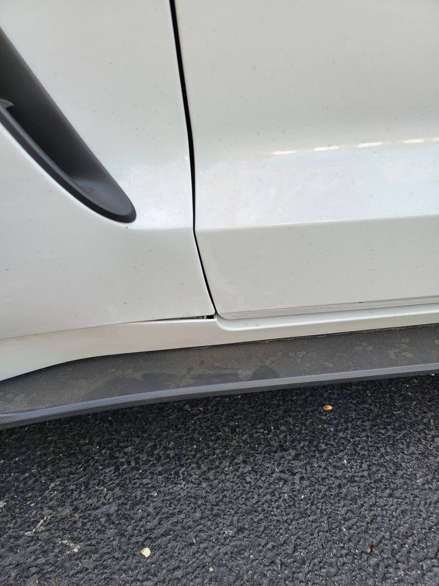

Thanks I am in Delaware.. that crease turned into a tear. The fender is kinda bowed outward. The rocker panel seems fine except odk if I clip popped or broken off where u see that gap.

Est is 2400 new fender and rocker panel smh... lo profile jacking rails a must.. this shit happened right after I raised my deductible f me 😆
