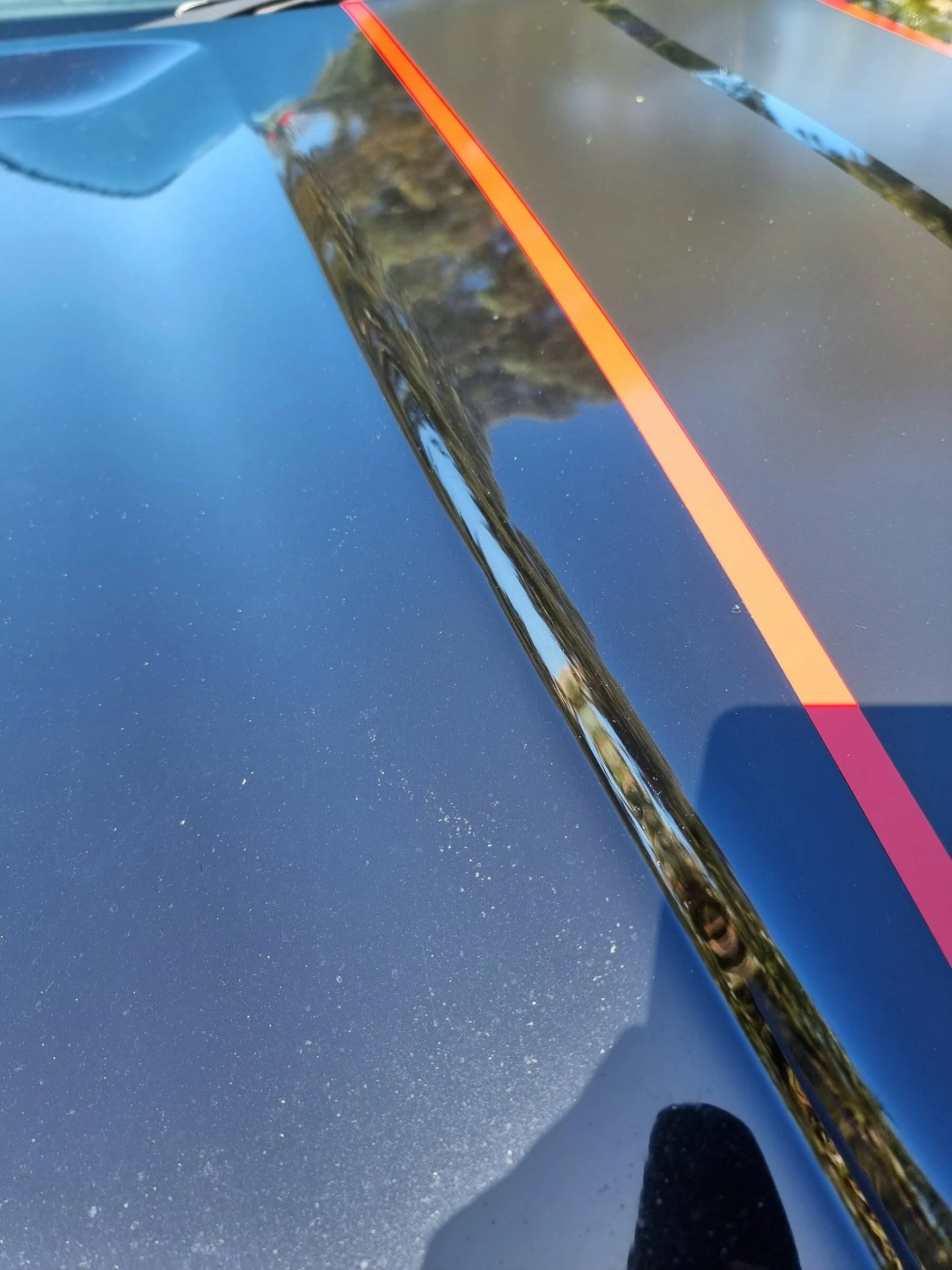

Hi guys,
I've got an aftermarket GT350 hood on my GT which has some pretty bad water/sun spots on it as you can see from this picture. I never got ceramic coating done on the new hood, which was a bad mistake on my part!
Any tips / advice on what I can use to polish all the water spots out?
I have access to an orbital polisher, so I'm thinking I'll practice on my daughter's older car first before tackling the GT. 😁
I'm thinking I'll use a clay bar to decontaminate the hood surface first, then use a polishing compound.
Advice greatly appreciated 👍🏼

If you're going to do something, do it right the first time. Practicing is a good idea, but if you already own one I'm going to lean towards you being competent and responsible.
That said, I would take this opportunity to do it all at once with the paint correction and ceramic coating. To do so, you should follow these steps:
  1. Wash car
  2. Clay bar the hood. Remember to be liberal with the detailing spray and to be patient. Lift all of that grime up and off your car.
  3. Use brand new microfiber cloths to wipe down car after the clay bar is completed. Do not use any fancy detailing spray at this stage.
  4. Apply a compound to your orbital and get to work. We want to utilize a compound instead of polish to ensure we take off any scratches created by trying to clean the spots previously along with natural wear of the vehicle. I use Maguire's Compound when detailing. Be patient, and work in small areas liberally. While you want to work on a 2x2' area, that doesn't mean get mesmerized in a specific spot. Slowly maneuver the polisher over the area and work it in a row by row pattern. Then again perpendicular to it. Because it is the hood, it is going to be pretty easy to not burn down the clear coat from body lines. But still be careful (just don't be scared of the tool).
  5. if this step has not taken care of the spots, you will need to alter the brand you are using and get something more abrasive. Additionally, polishing pads are color coded. Research these codes and use the appropriate ones for the applications being done. I doubt you'll have issues getting the spots to lift off though.
  6. Move on to the polish. Again, I use Maguire's Polishing formula. I personally love it. Polishing will take those deeper abrasions you've made from the compound sanding down the imperfections and basically smooth them out. This is the step where the paint starts to get a glass like finish. Be patient, but purposeful in what you are doing. This should clear up any remaining imperfections. If not, revisit the compound step. Remember, when you apply compound, it is essential to use polish after. You can't (read: shouldn't) just use compound.
  7. Wipe down paint with clean microfiber. Then wipe down using isopropyl alcohol to remove any residue. It is now prepped for sealing, whether that be ceramic or wax.
Tips:
  • When using the orbital buffer, you will be a little nervous about the edges of the panels. You should be, but don't be scared of those edges. Either tape off and go over them, or yeet it and get the job done. I recommend masking and then going over by hand. What you do not want to do is forget about them. It will be obvious if you do the other steps correctly.
  • Do not forget to seal the paint after polishing. If you ceramic coat it, do so immediately as paint correction and prep is the hardest part of ceramic coating yourself. It goes on easy and is an easy process to complete.
  • If you ceramic coat,and later have to back to a part of the panel to polish and fix, you need to redo the whole panel. For this reason, wax should be considered if the car is daily driven.
  • Waxing allows you to fix areas when they become an issue and reseal just those areas. If this is a car you baby but also daily, waxing is superior. If it is a garage queen, ceramic coat it and marvel at the qualities that come with it.
Hope this helps.

Do a wet sand with 3000 grit. Then follow up with a 4 stage compound and polish job using a high speed buffer with the appropriate foam pads.
A clay bar won't phase deep water spots. Calcium is rock hard and imbedded.
Not for the shade tree detailer. But that's how a pro does it.
