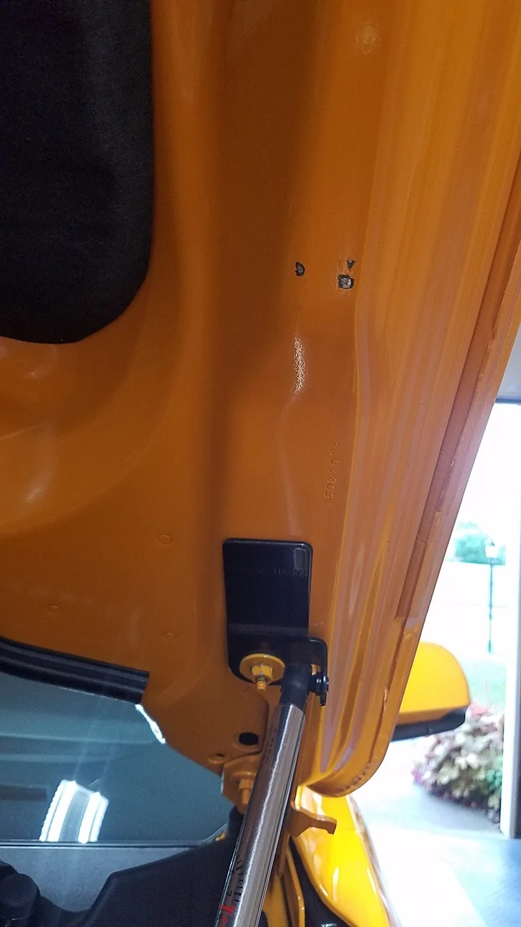

I installed a Redline kit in my 2016 Interceptor Utility, works great. Tried to install a kit in my '22 GT today and ran into an issue.
I got the hood brackets on, and put a small piece of paint protection film on the hood in case of rubbing, etc.
I figured it couldn't hurt to put a tiny bit of 3M emblem tape under the fender brackets. I had to pull the battery cover to check...but the driver's side fender bracket rotated after opening and closing the hood twice.
I'm assuming the tape may not have allowed "fll contact" of the bracket against the fender and plan to try it without.
Wondering if anyone else had a problem with the fender brackets moving?
And...I don't quite understand via the instructions how I should re-route the washer line.
Thanks all~

Well, I played with it a little more. There’s no way in the world I can get these bolts tight enough on the fender brackets to keep the brackets from rotating when in position.
I know everybody raves about these, but I’m completely disappointed with them. I’m gonna call the company in the morning and see what they think. I will keep this thread updated.

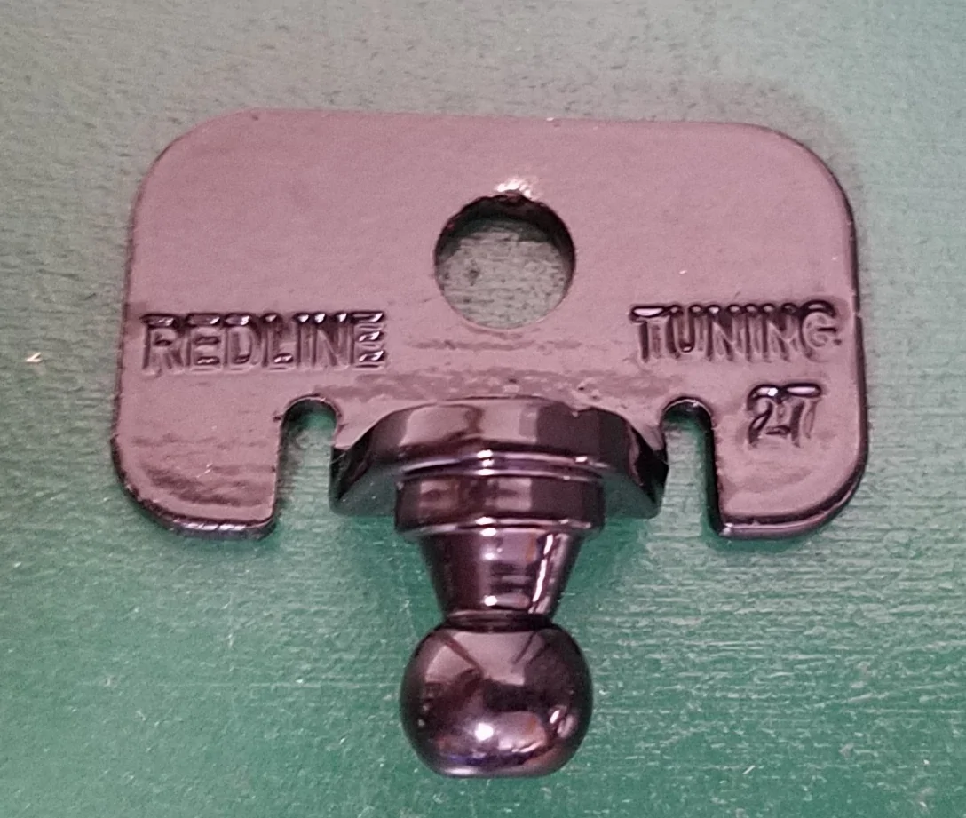

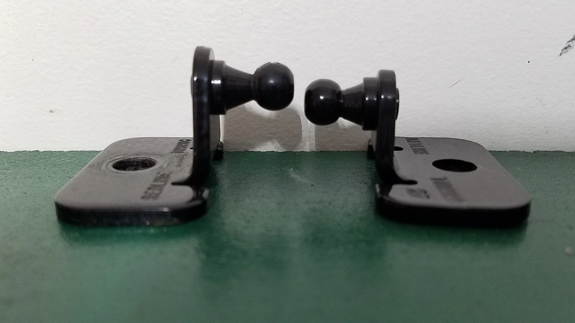

Redline ECO'd the fender brackets for 2018+. The ball is at a little lower elevation since there is barely enough clearance, and you can still get paint rubbing. I suggested adding a stick-on felt circle pad to prevent that. The new bracket has "27" stamped into it.

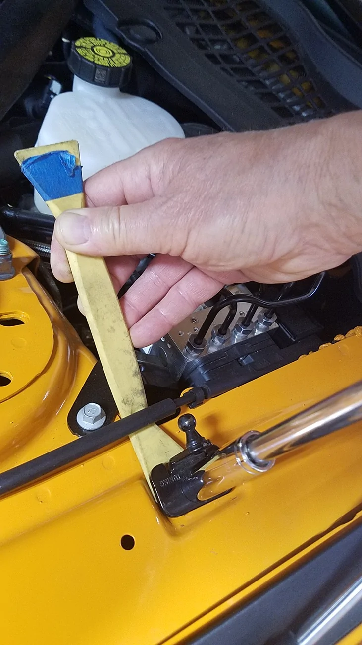

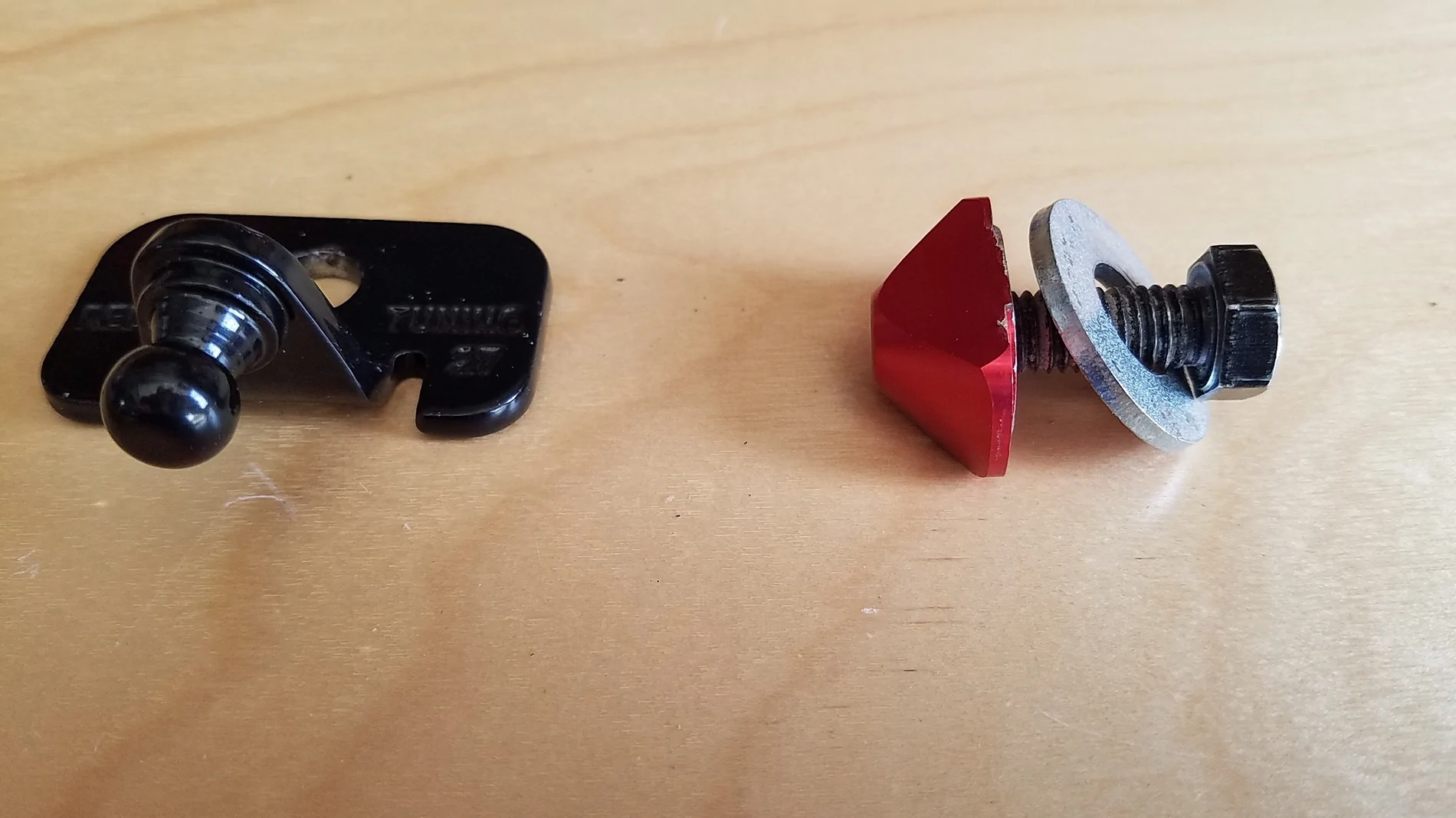

I feel your pain about the bracket rotating. You have to be very sure the oval aluminum piece fits inside the oval hole precisely. I pry up on the screw to help hold the oval wedge in the Home position while I tighten it. The metal is also very thin and can distort around the oval hole edges.
I think you could drill a hole through both the bracket and your fender so as to tap in a roll pin. That would surely prevent it from rotating.

Using a body pry tool to hold the fender wedge up into the oval holes while tightening the bolt:
Thick washer added for more support against the thin body:
Old ball bracket on left (MY2015-17), lower ball bracket on right (MY2018+):
The new bracket is stamped "27" in the corner:

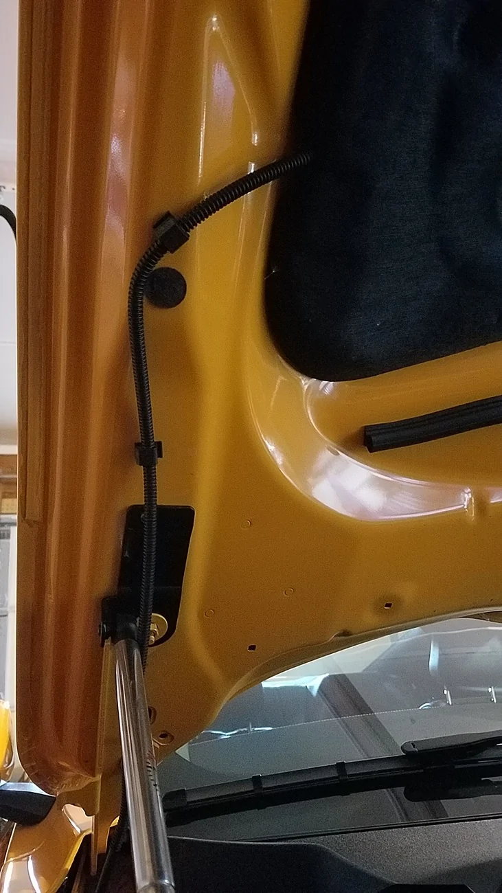

Here’s a picture of the hose reroute. The clip has a tab on it that locks onto the hose so it won’t move. Just have to get a tiny flathead screwdriver to pop that open a bit then you can pull a bit of hose through
I’ve not had any issues with the fender brackets but it did take a little bit of time to make sure the red piece that goes into the hole was turned properly so it made full contact. Everything is tight and hasn’t moved

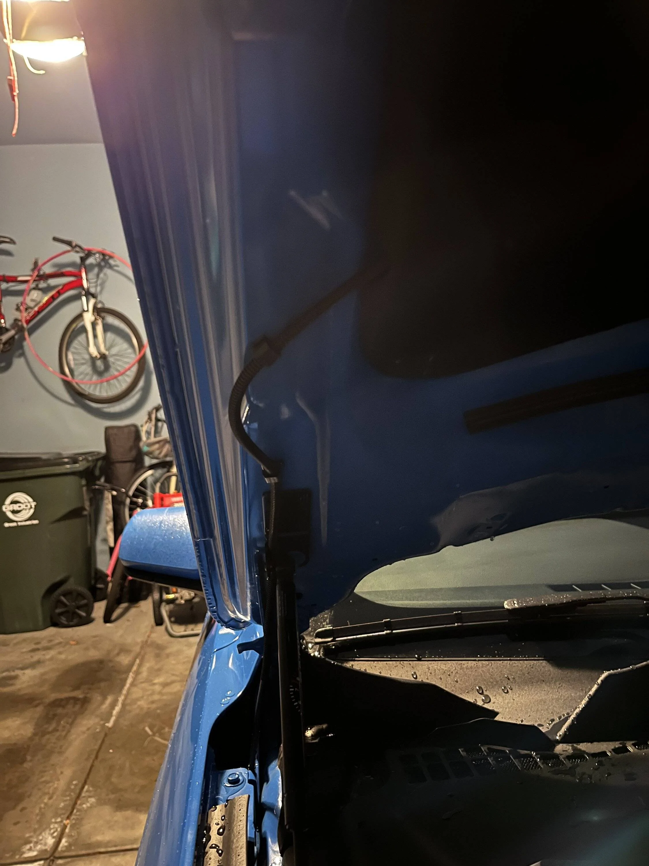

Drill a small hole into the hood bracket off to the side of the bracket (Before mounting to the hood) then use a small zip tie to secure the wiper hose.

I used a black Bunny Bread twist tie to attach my windshield water hose to my hood lifts..Works perfect.
