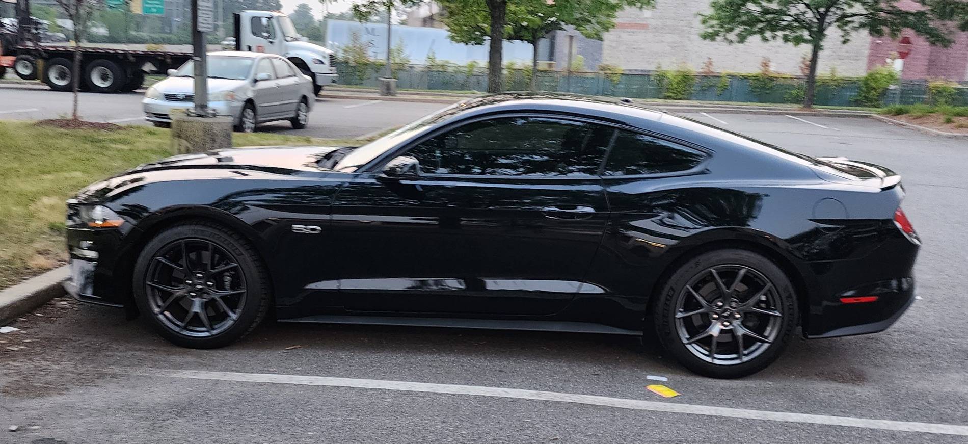

I had a 401A Auto non PP. It was great. I see you mentioned tires and wheels last. That should really be first.
Put these on instead of those 20 OEMs and it will hug the mountain roads a lot better. It made my car much more nimble. They are the Mach 1 Premiums. $1200 on the used market. Great bang for the buck. The tires you mentioned are great too. I run them on a GT500 all year.
