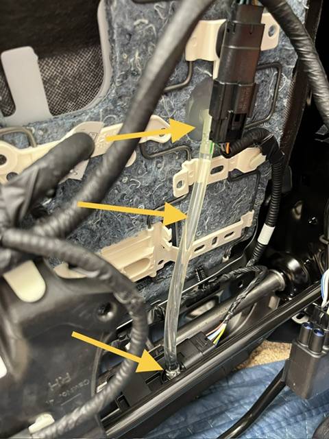

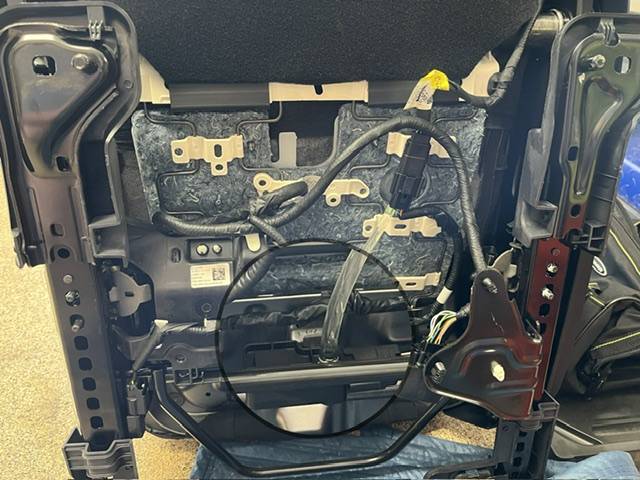

Anyone know what this liquid line is? This is in the seat bottom of the factory Recaros. And as we know there is no heated or cooling capability with these seats.
The line goes to an electrically controlled box and the line terminates in the seat bottom. šŸ¤”
Pressure sensor?

I’m about 100% sure that is the bladder that senses your weight for the airbags is it? Something to do with that. I found this out when i upgraded to Recaros from premium seats. My passenger seat would throw an airbag code only on the passenger side. The fix was swapping over the bladder (not always the case but very common).

Most likely OCS (Occupant Classification System) - bladder, as Competition53 mentioned above.
