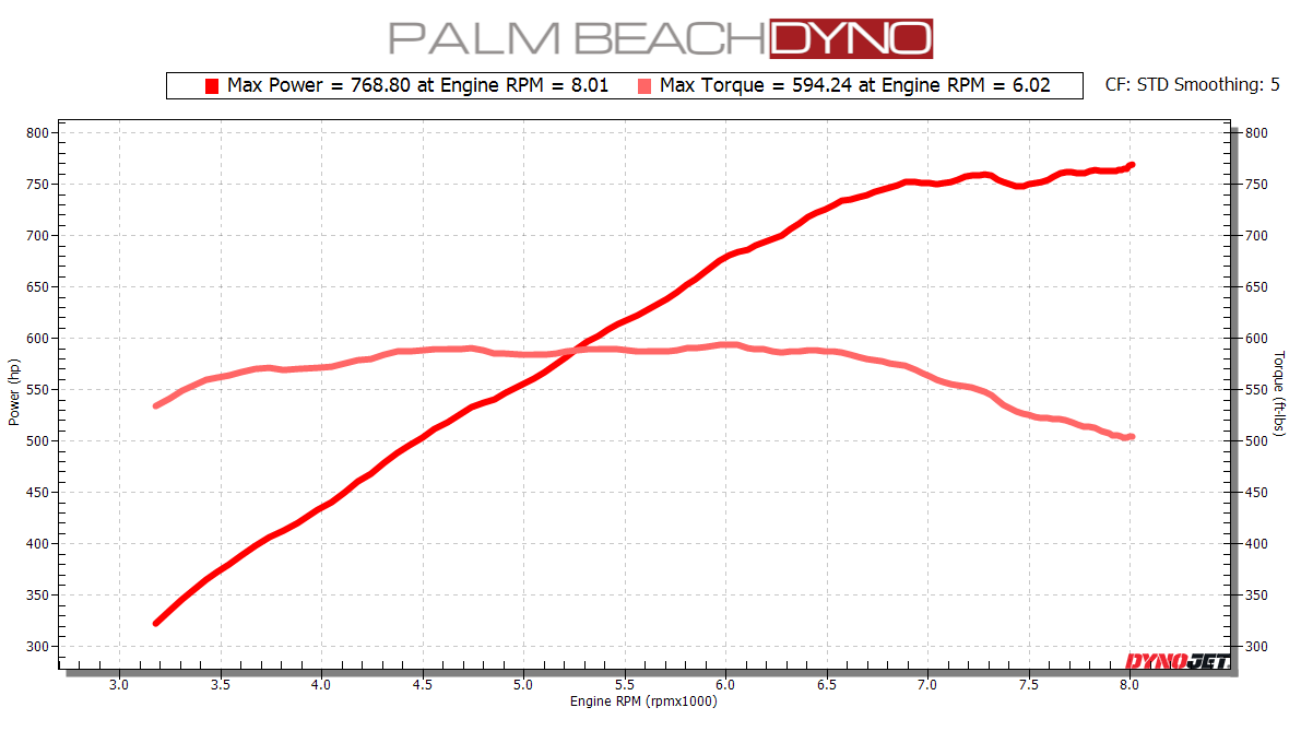

I am at the limit of my fuel system too at that RPM and its a stock motor, 8k is about as high as I want to go.
is this a coyote or voodoo ?
