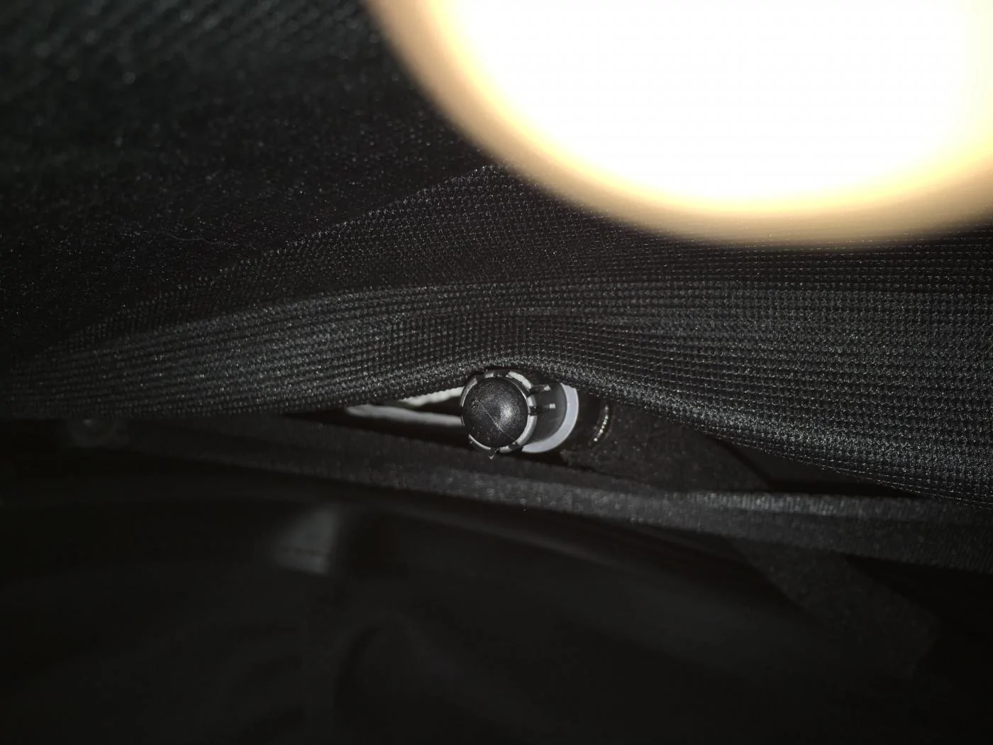

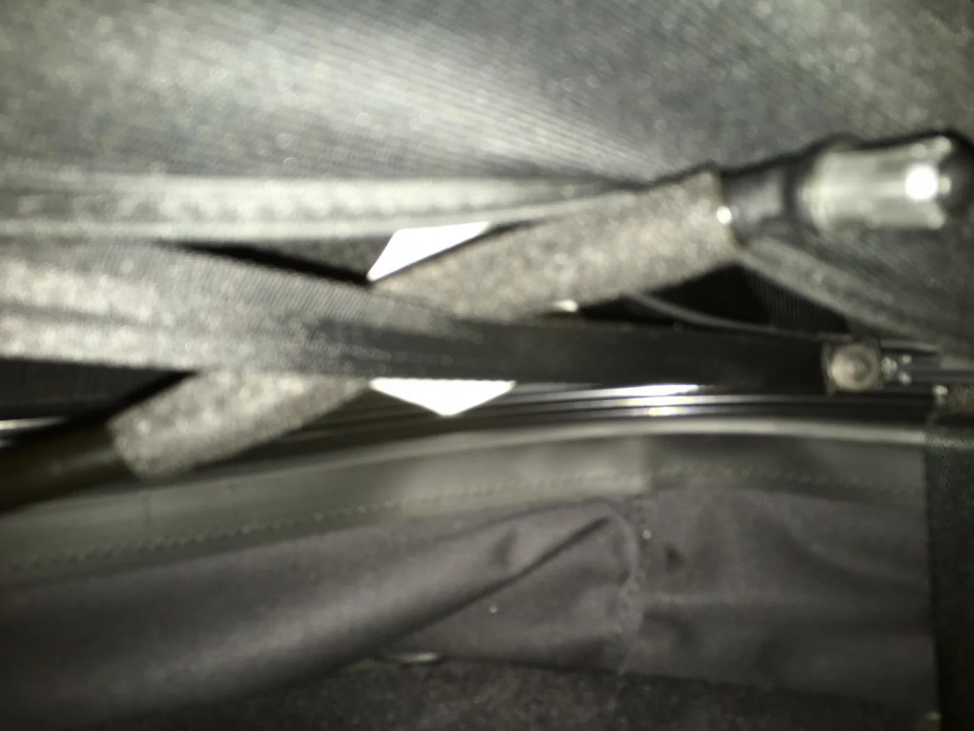

Pics from inside
Sorry to reply to an old thread, but I took some pics to make it easier to find for those who might be unsure. At least now I know why my top pops when closing, and how my torn headliner was caused.
