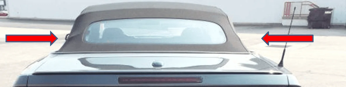

Anyone notice an issue with the rear window support brackets on the convertible?
There is a support bracket on each side of the rear window. It is aligned to the middle of the window on the left and right side. When the top is up, you can notice the outline of the bracket in the top.
I noticed that my top only had a bracket on one side. After some investigation, the second bracket was there, but not attached to the window. I took it to the dealership and we walked around the lot looking at other cars and noticed several had the same issue. Ford originally had not heard of the issue and asked the dealer to order a complete new top. After the weekend, they called the dealer back and told them the were going to be issuing a repair kit.
Anyone here having the same issue?
