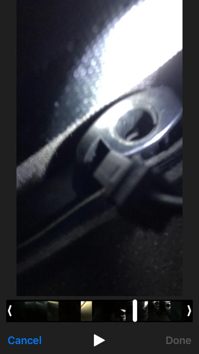

Here's a not so great pic of the drivers side on the window frame
Redcruzer, can you confirm the orientation of this photo? It looks like there is an indentation at the top and probably a corresponding one opposite it) for the rod end plastic clips to go in to! is the indent shown in pic next to the glass? If so the orientation of the rod end clip needs to be inserted to 'align' with these indents inside the female part of the bracket that is permanently attached to the rear window sides. If we and dealers have been just randomly inserting the end clips, we are not likely hitting those indents! :cheers:

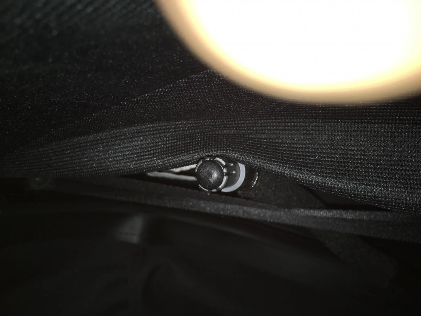

Sorry to reply to an old thread, but I took some pics to make it easier to find for those who might be unsure. At least now I know why my top pops when closing, and how my torn headliner was caused.
Thanks Jim05, this pic shows the orientation of the straps. IF this is how they were from the factory, the rod should be between the strap and the outer roof material. :D

Hey Dave, all I can tell you is that was the drivers side. I reached in with my right hand and just sort of waved the phone around hoping to get something useful.
