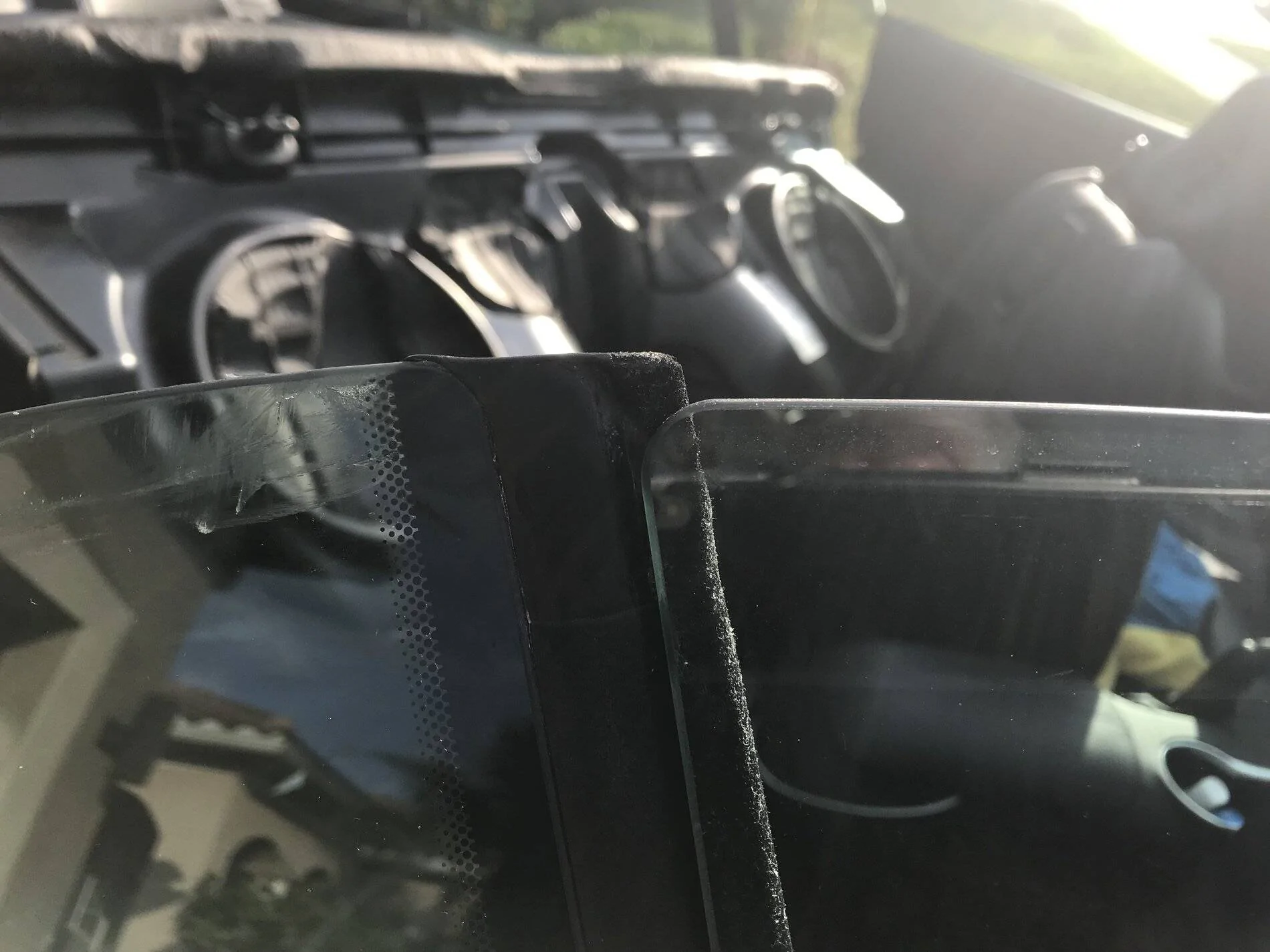

I have been fighting this issue for a couple of months on the passenger side rear window. Silicone spray and/or light grease works once and then has to be applied again.
I found the procedure for re-aligning the rear window and used that as a guide. First steps show how to measure the mis-alignment, and only then did I realize how badly my car was from the factory. The pic below shows how bad it was. So I took the car apart and fixed it, took about 3 hours. At 67 YOA, my back is killing me. 😀
I’ll post an after pic tomorrow, but the passenger rear window now looks like the driver rear window.
