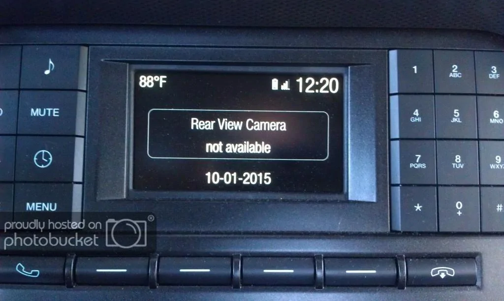

My '15 base Ecoboost just got its first "rear camera not available." Awww... :mad: Going to take a look at the wiring harness.
