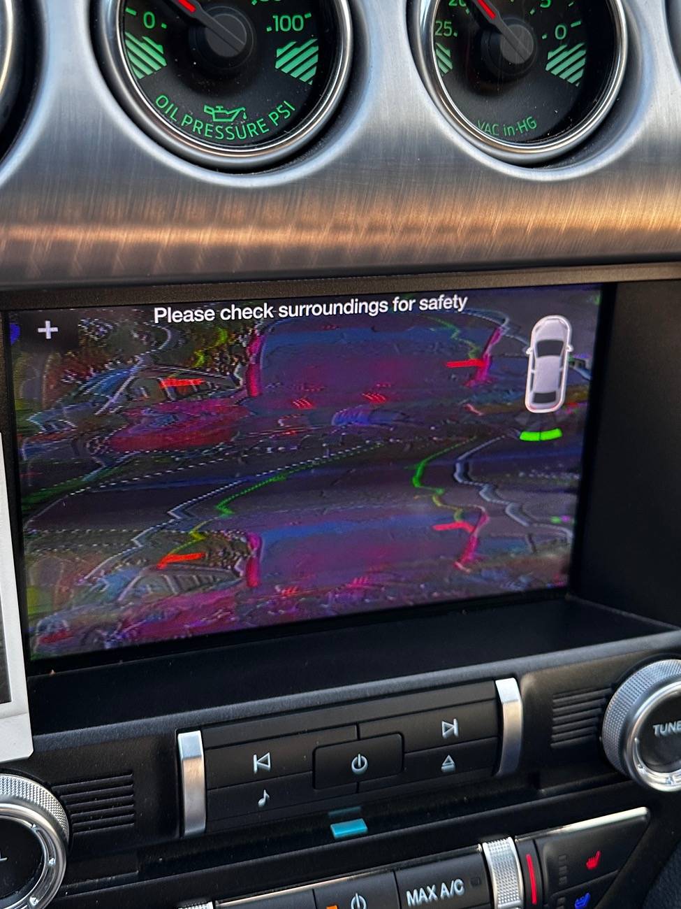

Good morning everyone. Recently my backup camera has been intermittently inoperative. It seems correlated with the temperature, working in hotter weather and becoming pixelated or just throwing a blue screen up in cooler weather. I’ve been following all of the other forum posts regarding this, and it seems like most people have replaced the harness from the trunk to the camera and the problem was solved. Unfortunately, that was not the case for me.
I’m assuming next step would be to check the camera, however, I’ve also read about people suspecting harness damage further up the car, or it potentially being transmission related. Does anyone else have more knowledge on this issue? Has anyone replaced their harness and still had problems? Trying to avoid taking it to the dealer until I’ve tried everything I can. Thanks!

A quick update:
  • I swapped out the backup camera today. Obviously I haven’t done much driving yet, but so far the camera seems to be working perfectly now. I will update the thread if anything changes
  • As stated in most other posts about changing cameras, the guide lines and zoom functions are now gone. I should be able to go into Forscan tomorrow and recalibrate. I’ll document that too in case there’s any issues
Thanks to everyone for the help!
