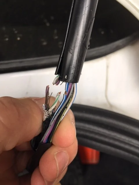

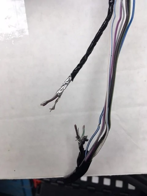

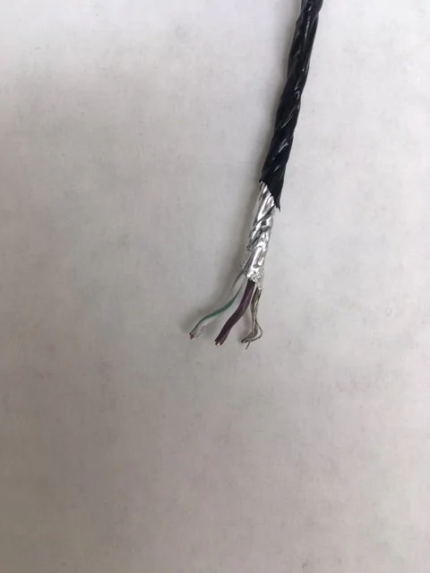

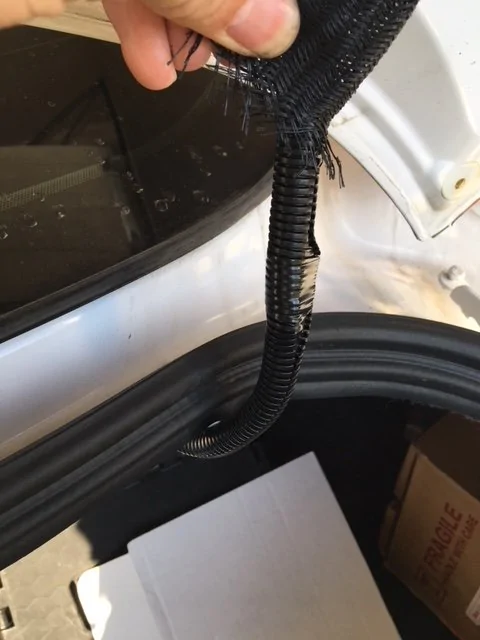

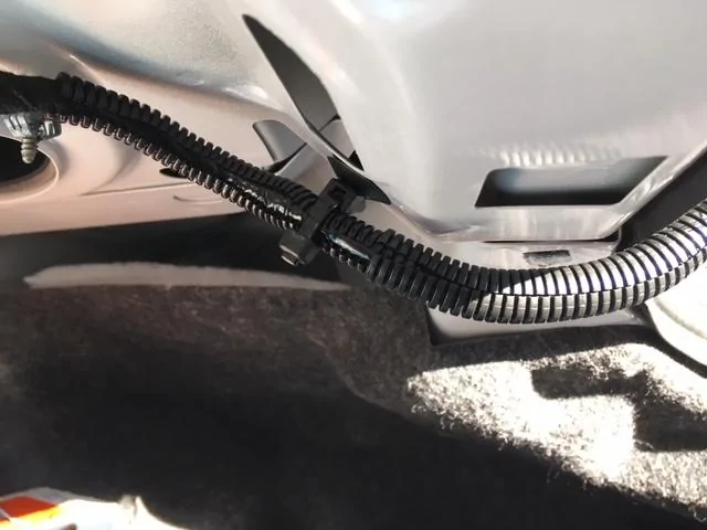

16 Rear Camera Not Available
Hey there, so I was having the common "rear camera not available" issue on my 16 Ecoboost. It was intermittent at first then completely gone, would have major lines etc. So I did some investigating and the wiring bundle in the trunk was the problem. As you can see from the pictures Ford installs a protective sleeve on the wires but unfortunately at the end of the sleeve is exactly where the problem is, which I removed on reassembly. The 2 wires for the camera were completed cut and one other had the protective coating broke. To make the repairs I had to cut back the protective silver coating on the 2 camera wires, then I used red butt connectors. I then taped everything very neatly back together with a good quality electrical tape. I then covered the bundle with split cable loom, then moved the factory protective sock over everything. I also added the loom all the way past the bundle mount in the upper trunk.

It is the harness. When the trunk is completely open, it is fine. Put it about a quarter down, it is fine. Put it more than half way down, the picture gets wonky. Also some times it will black out. I think my failure point is the cable tie just below the trunk lid lip. The cable tie just seems to tight. That is the point were the angle of the wire changes as the trunk lid closes. I will make an appointment for next week with the dealer.
