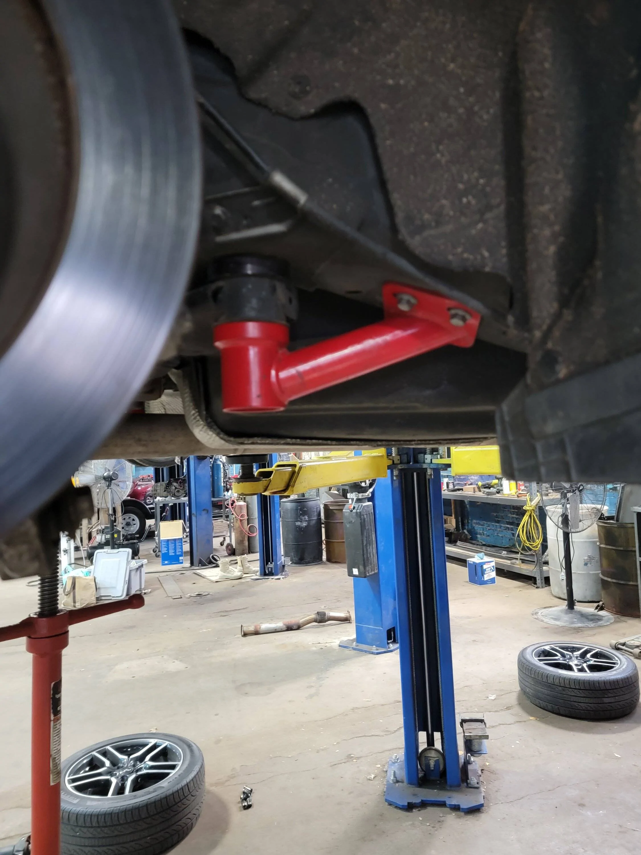

I originally intended this to be to Kelly @BMR Tech , but it wouldn't let me start a private conversation. Below is my issue and description. There's a clanking noise that comes from the rear passenger side, and I'm wondering if it has something to do with the CB005 kit (I switched all other components from left to right and the sound stays on the right side). Besides CB005 the other mods are BMR upper control arms (UCA762), BMR Sp083 Handling springs, and Bilstein shocks. Car is 2019 GT non-PP. No upgraded sway bars or end links though everything is torqued to spec. Although full disclosure, I wasn't able to clock the 2 inner control arm bolts (forward and rearward)....could that be it? Ran out of time since it requires removing the exhaust.

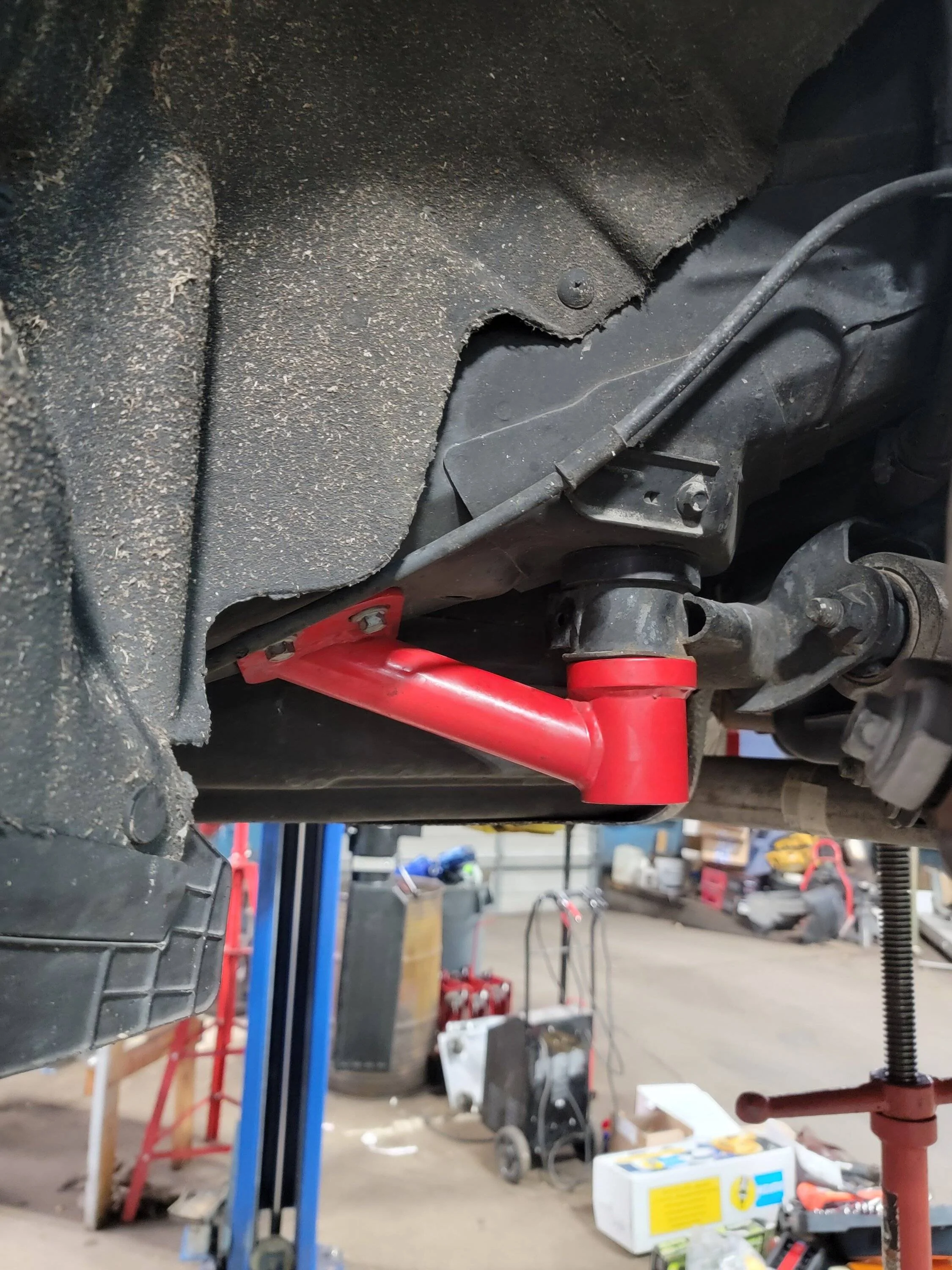

I have a question about a noise I'm hearing in the rear passenger side, like a loose metal clanking sound. And it appears to happen during rapid ups and downs with the rear right wheel. I've changed out many parts to isolate the problem and I still have the sound.
Anyway I wanted to ask if this CB005 kit looks fine to you on both left and right sides. On the left side the brace does not sit up flat against the subframe. I've reinstalled it many times over the course of a few months and it always sits like this. I wonder if it not being flat is causing the subframe to move on the other side, somehow.

That's a good point! I removed/replaced the passenger side one with the original Ford bracket and the sound was still there; I haven't done it with both passenger and driver pieces though. I noticed yesterday that the driver side piece looked a little slanted. I should give that a try. Thanks @***** !

My drivers side brace is longer than the passenger. I don't think this is on purpose but a shitty welding job or bad fixture. Have a look at this: https://www.mustang6g.com/forums/th...hing-lockout-kit-pics-info.23215/post-3557351
I couldn't get mine to sit right so I ordered a new one from BMR. They sent me the wrong color and the new one also measures too long. The BMR braces are garbage as far as I am concerned.
Don't bother trying to reach out to Kelly @BMR Tech. I don't think he works there anymore.
My passenger side was squeaking so bad I removed it and put the OEM brace back on. No more noise now. This is contradictory to your experience. I'm wondering if it's a problem with the aluminum pucks that are part of the CB005 kit.

Wow thanks for sharing that thread @StangTime ! It was a relief to see it wasn't just my problem and also that this may be the source of the noise! Because that noise was/is driving me crazy esp since I've replaced and retorqued the rear parts so many times now -- so thanks for this info!
I had removed the passenger side bracket since that's where I was hearing the noise, but it's possible the noise is a result of the driver bracket being off. I will remove both sometime soon and report back what I find.
