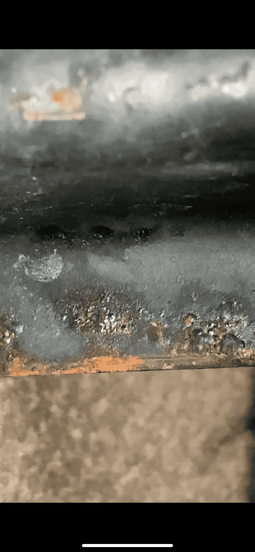

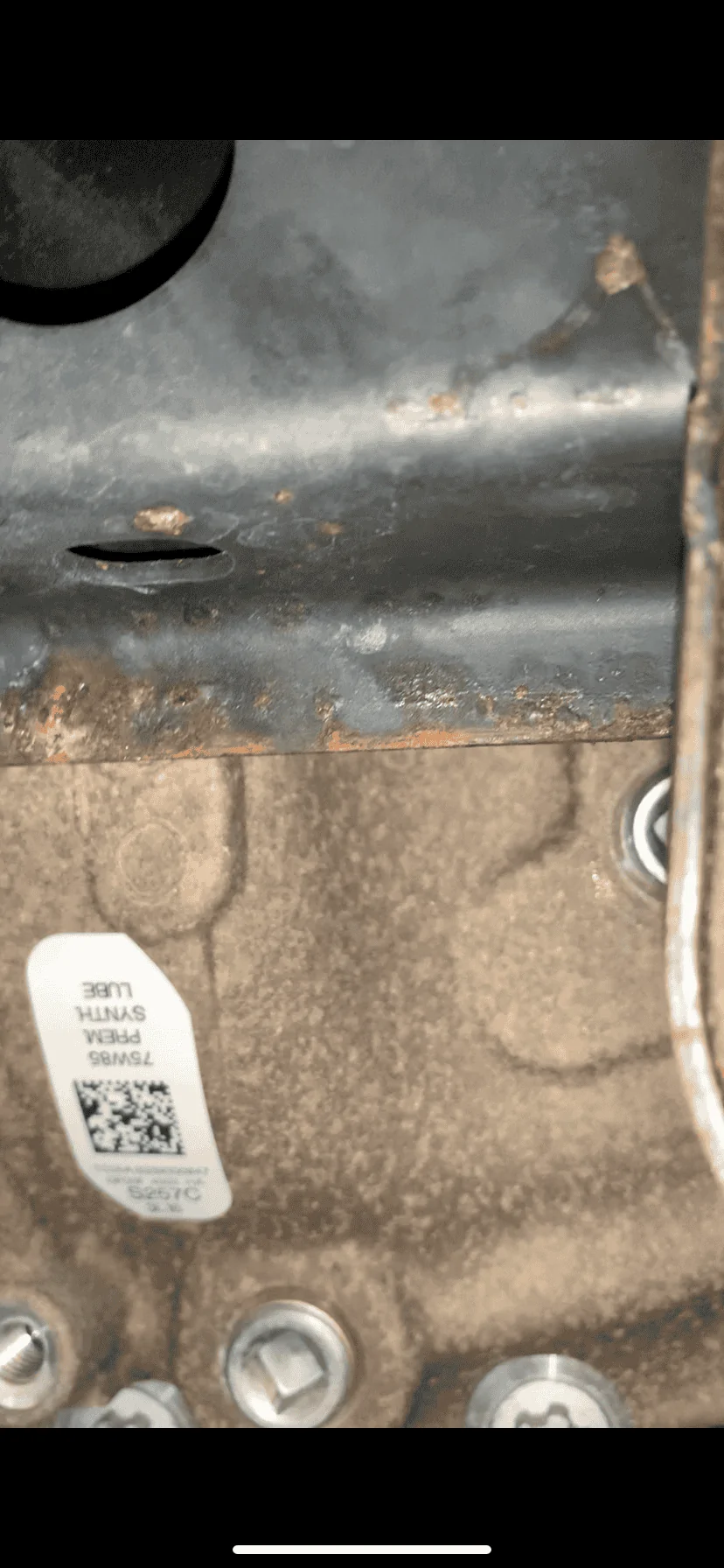

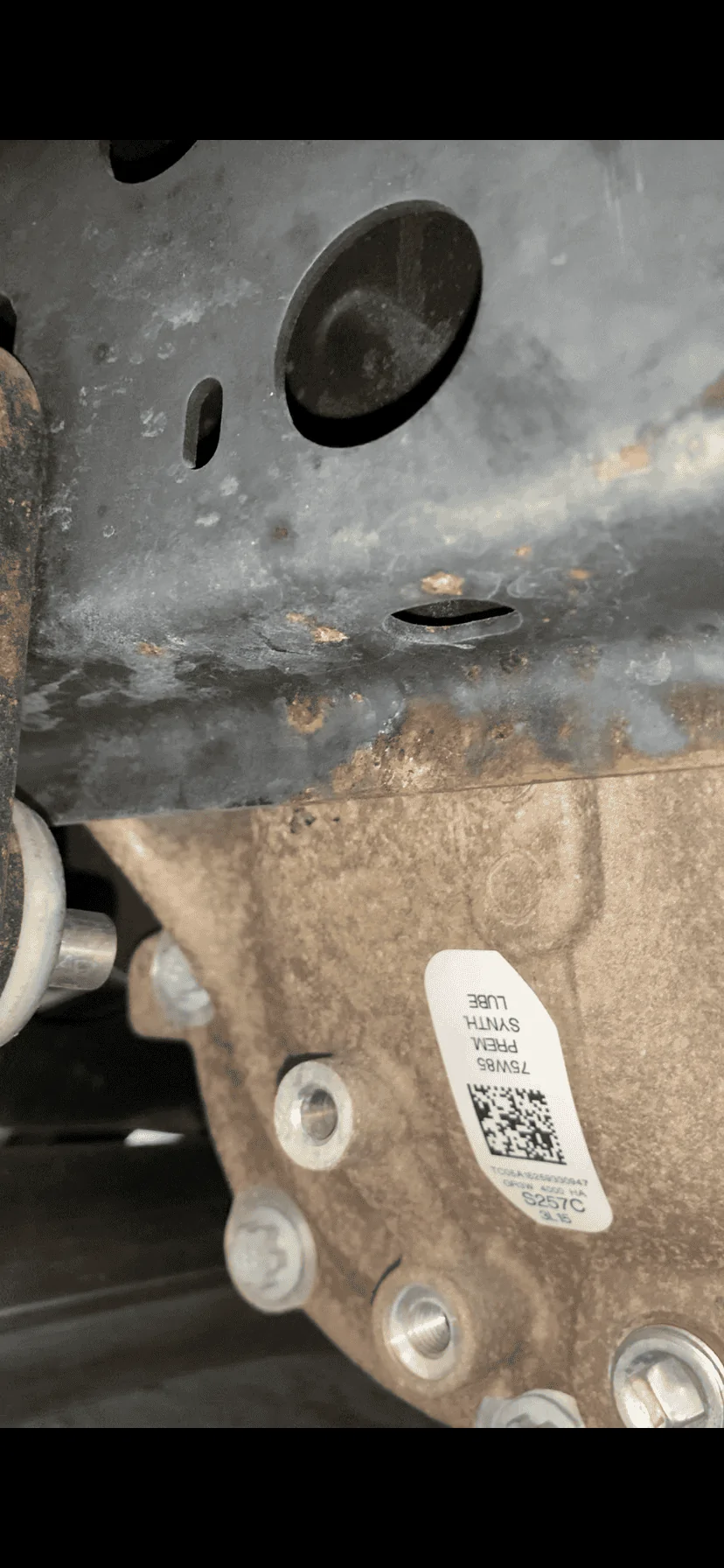

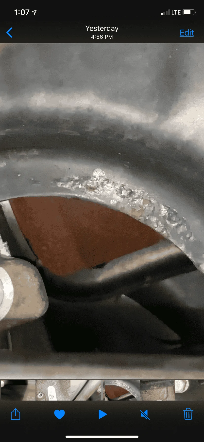

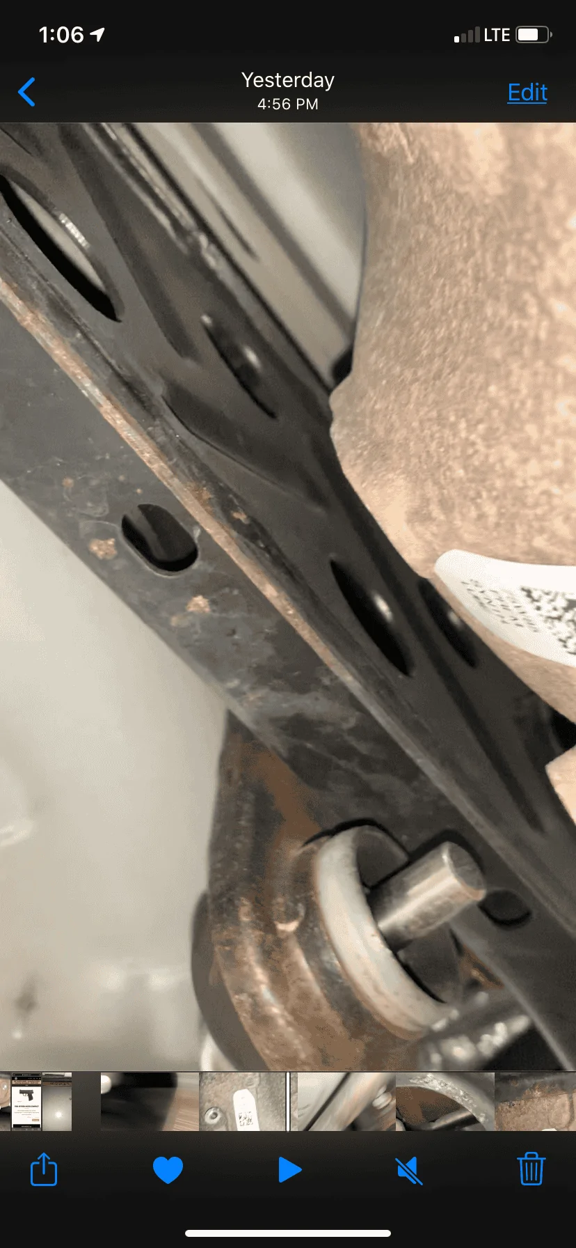

Hey guys, I was under the rear of my 16 gt yesterday checking a few things out and during that time I discovered rust on the rear subframe. I live in Florida but not near the coast and clean the underside of my vehicle at least once a month. I have no idea how the rust began however it’s there now and Id like to fix it before it progresses any further. My question is does the rust in the photographs look bad, to me it just looks like surface rust? Also am I able to fix this with a simple sanding and then applying rustoleum black paint to stop and prevent future rusting? Any advice would be much appreciated, thanks!

Go to Eastwood’s site (or any other such supplier - Advance Auto supposedly has this too) and get POR15. It’s a rust converter and protector; the product stops rust from occurring even if there is current surface rust as in your pics. The surface has to be cleaned of any debris AND most importantly, be 100% dry before applying the product (ie: if you washed car and sprayed under it, went through car wash or were driving in rain).
The best application for what you would be trying to do is the canned “paint on” product, not the spray. Application is to brush on the product and cover all affected regions. The product is supposed to self level so don’t be concerned with how it looks on first appearance. Be sure to dab in all crevices or into/under ridges where 2 or more pieces of sheet metal come together.
The spray would work, but when working with the parts attached to the vehicle, you can’t get the proper spray angles or get up into smaller region to apply. This is why the brush on application is much better.
That is the only way to stop rust - aside from dismantling, sand blasting and/or then prepping, painting (or powder coating) metal parts.
