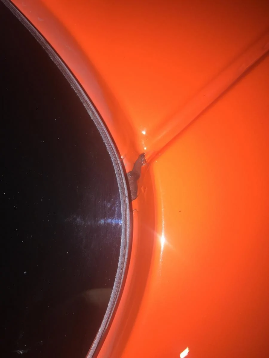

So i took my baby to the car wash today and upon drying her, I found this.
Looks like the paint peeled, and rust started forming?
Would warranty cover this? and if they do, how do they take care of something like this?

that's a good one. It looks like there is defects in the paint below the rust spot as well.

That be rust. I would think that the glass and weather stripping would need to come out to do a proper refinishing job as there could be additional corrosion hidden beneath as there could possibly be a leak thats causing all this.

I'm not too sure it's rust. Might look at it closer to verify. Looks more like something on top of the paint because I don't see any real depression in the paint where the discoloring is.

That is definitely rust, probably still a warranty issue at this point unless the can point to damage. That is a window out job too, had this on my Supra but it had the excuse of being 20 years old.

Maybe not as you say but it could be a prior repair or something done to that area. It looks as though something is under the paint or there was an attempt to touch it up from the chip/cracked like edges see below the discolored area.

Well guys, sigh of relief, today i went out and inspected the area again, it seems to be that who ever put my windshield on did a really sloppy job at it. It seems to be like glue of some sort.
