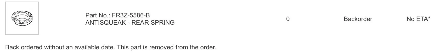

I placed an order with Ford Parts Giant for all 4 parts to see what would happened. The upper right is on backorder without any ETA so they canceled it. I wonder if the aftermarket will step in and pick up the slack?
