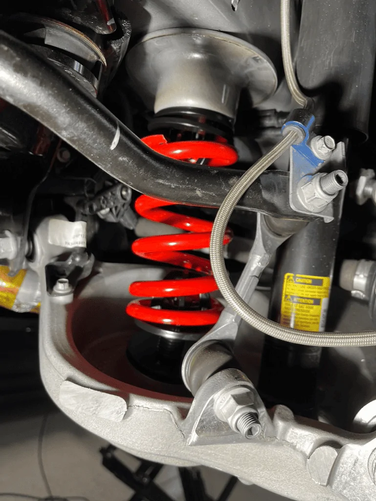

This is likely the simplest way for you to be able to swap springs and have a big assortment of springs from 700-1300 in/lb that are widely available.
My car with Eibach 1,000 in/lb springs on my car.
