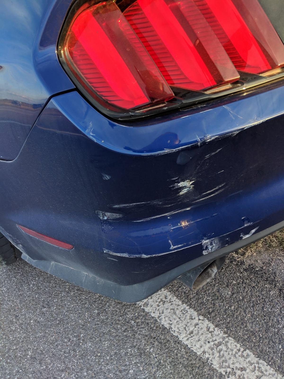

So I was rear ended in the Mustang today. This is new territory for me so I want to make sure I am doing stuff correctly. 19 years of driving and the only time I have had to call insurance was over a blowout that tore up the side of my truck.

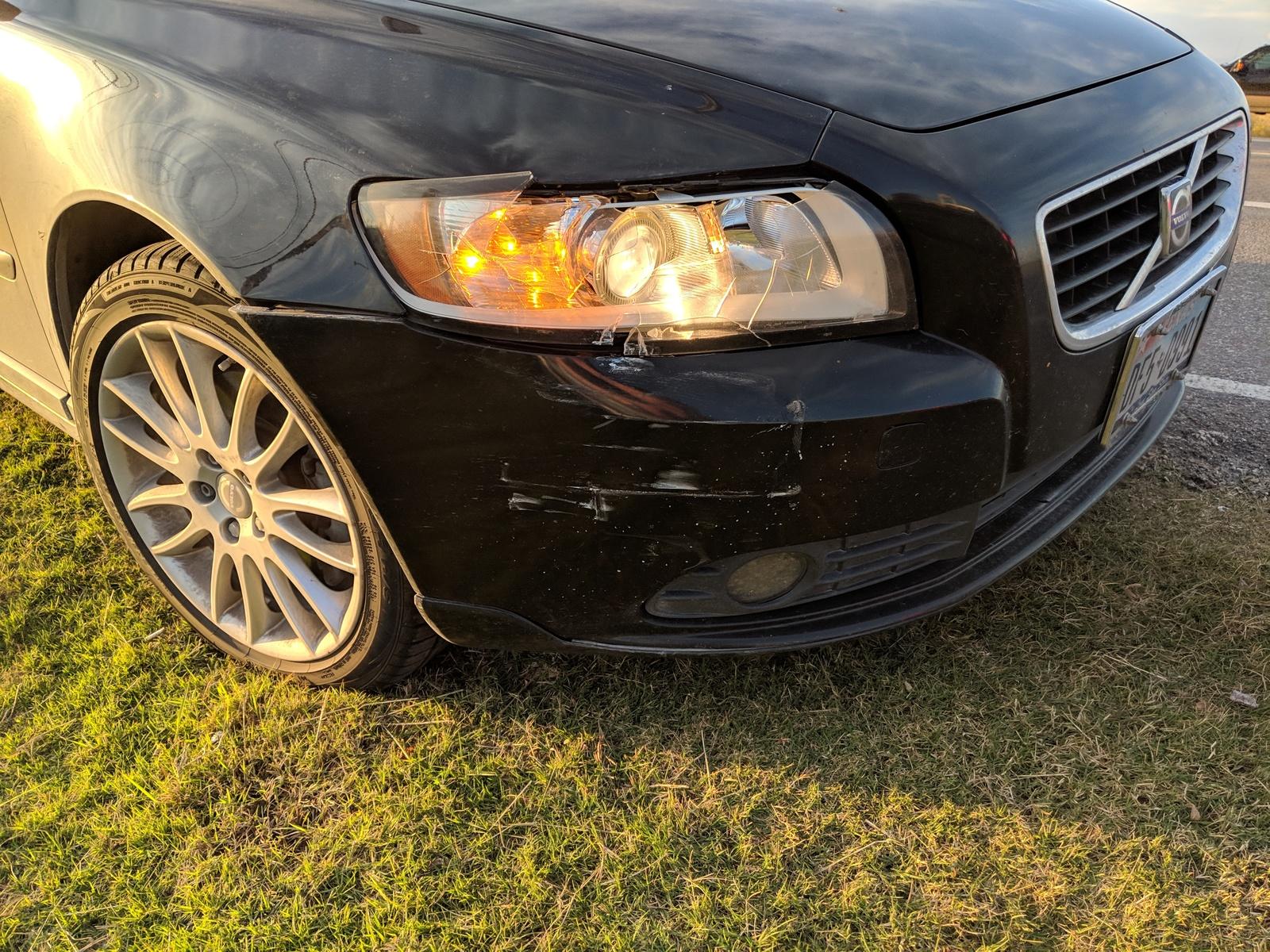

Basically coming out of a parking lot making a right, I am stopped waiting for an opening, lady behind me decides to go and runs into me around 5MPH. It was a corner impact my left rear vs her right front. Visible damage on my end is the rear bumper and likely the tail light due to some deep scratches. On the other end was a Volvo S40, looks like the front bumper and one headlight need replacement.

I am willing to bet there is more damage. Look at your tailpipe. Looks like there is even paint transfer in it. So your exhaust might be bent. Never trust anyone by what they say after something like this. I've seen many times where a person will admit fault, and turn around and try and blame the other person and try and take them to court. Also you may have rear body damage. Either file with her insurance company if she even still has it, or just go through yours. They won't personally give you anything close to what the cost to fix all that.
If you want money and buy aftermarket stuff or whatever go through GEICO and when they see all the damage and tell you it all. Ask for an appearance allowance. Any adjuster would be willing to trade you that than doing the repairs. The bumper/absorber/impact bar alone is almost 800 dollars for a recycled one. Add in about 3 hrs of overhaul time at like $60 an hour ($180), $60 for 2.6ish ($156)in paint and $40 dollars 3ish hours in paint materials (120). I just saw that the tail light is starting at $500 dollars and .2 labor time.
You are looking at about $2,000 dollars after tax. That's not including the tailpipe or exhaust being damaged. I can't tell you how many times I've had to replace almost the entire exhaust from the cat back because of where the damage is or the owner wanted it new since the scratches can't come out.
I would normally ask someone to take an appearance allowance on it. Pretty much I would offer 75% of the repair/replacement cost if they agreed to get a check for it than having the insurance company replace it.

Thanks everyone for the replies. I started a claim with my insurance. I also put the Mustang on stands so I could get a closer look at everything. I couldn't see anything off underneath but did spot some alignment issues with the trunk and fender so no telling what the collision shop will find when the start pulling panels off.

Behind that bumper cover is a crash bar and if damaged will add a lot of cost. You may not be able to asses hidden damage until disassembly takes place.

I don’t think the crash bar would be damaged but I can tell you:
1) taillight - that’s trashed and can’t be fixed
2) bumper cover - best to get replaced even if existing one can be fixed by shop
3) plastic mounts behind the bumper cover are probably cracked
The taillight and bumper cover alone (excluding the lower black valance of the bumper) new from Ford will be over $1500... excluding any other parts, R&R or paint work...
I’d suspect with shop rates, R&R, new parts, prep/paint, materials cost and disposal of old parts, that’s gonna be at least a $3500 repair...
